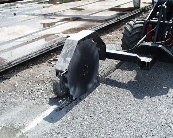

I've got the old style stump grinder with welded-on teeth. I've been using it to cut asphalt pavement in preparation for trenching. I've only cut about 20 linear feet so far, but the teeth show no signs of problems. I suspect they are the same teeth that are used for mining equipment. It's way faster & easier than a diamond pavement saw.
   / Stump Grinder #5
Gravy,
Are you cutting down on the asphalt or cutting up from the bottom? If you are cutting up, does it cut it out or rip it out with a jagged edge?
Like this.
   / Stump Grinder #6
Gravy,
Like this.
J_J,
I'm cutting both ways. It doesn't seem to make much difference so far. The cut is surprisingly clean.
