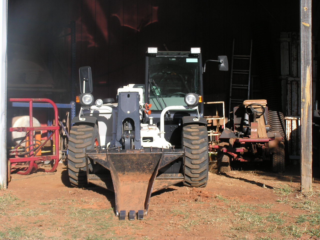

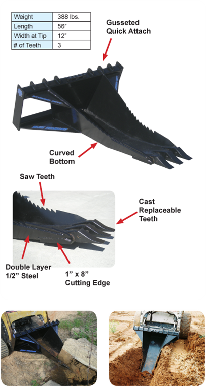

I guess you are talking about a stump bucket with a grapple.
Short one from Everything Attachments.
Long one from Loflin.
Mine is a Blue Diamond without a grapple. For my machine I like the long length. Since I have a 44" wide grapple, I have not ever wished for a grapple on the stump bucket.
