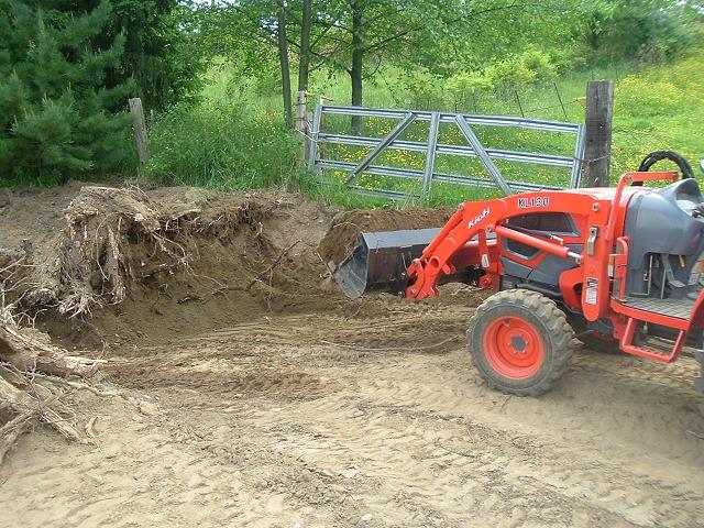

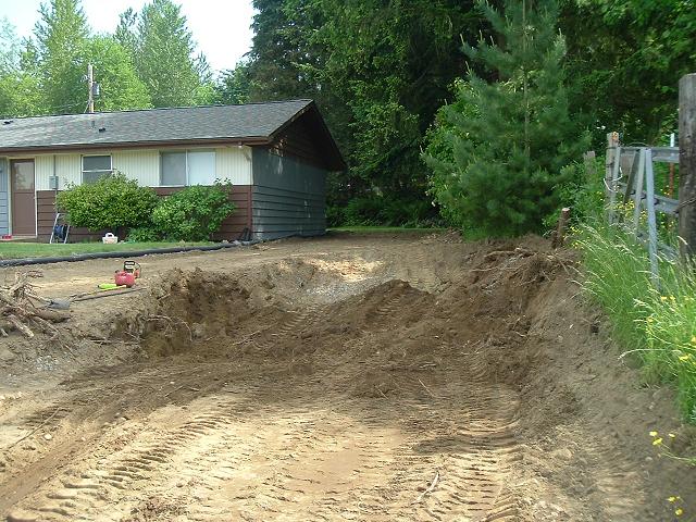

So I figured I had better test out this new version loader. I had a couple of tress cut down near my hosue about 3 weeks ago and one stump needed to go. It was a spruce tree about 18" at the bottom. It sort of looked like an overgrown Christmas tree, the old owners actually planted it as a seedling.

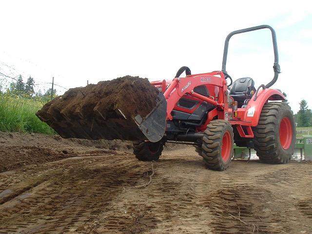

Pic #1 and #2: I trasfered the toothbar to this bucket and began to dig around the stump. You need to go all around the stump and since the bucket is 5 feet wide, you end up with a huge trench. With the toothbar not only can you scratch more meterial in teh bucket but you can actually hold a bigger mouthful making each scoop more effective.

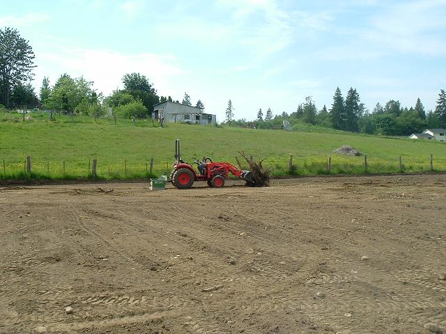

Pic #3: I pretty much had decided that this whole idea of a "tap root" was a myth. Well maybe a myth in certain soils but with the sands at this property the spruce stump was very deep. Almost like a shaft heading down the same size as the tree for several feet.

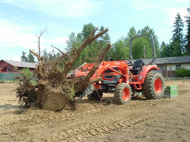

Pic #4 and #5: Not to worry though, enough scooping and then reaching in to cut a few roots made this stump roll out. I knew that once I got a little wiggle out of it that the sands would release their grip. Really it is a loamy sand but pretty dang sandy compared to clay.

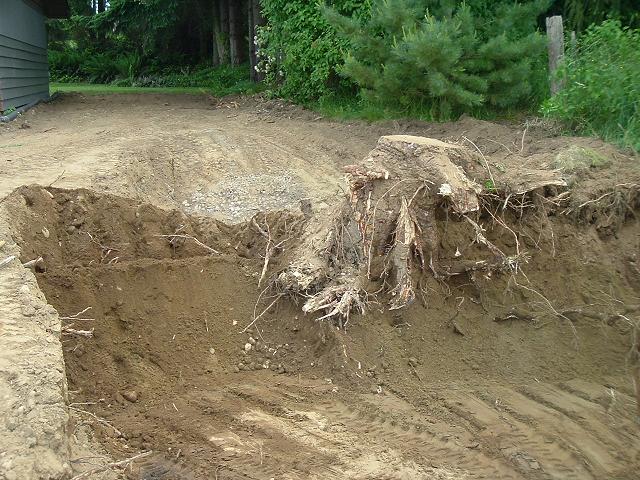

Pic#6 is the monster hole. The good news is that I was planning to strip material from around the house anyway so I could just fill the hole with the spoils from that operation
This stump took a healthy 5 hours to dig out over two days. Part of the time was running material away from the hole and some was spent doing some hand shoveling. Every time I am able to accomplish something like this myself I figure that I saved the price of hiring a man with his excavator to come out.

Now, to justify the cost of a backhoe, that stump would have come out in about 30mins to 1hr depending on experience. At roughly $100/hr that is $400-$450. Dig out 10 more stumps and just like that it's paid off. :D

Joe, great job. Thanks for the pictures. Nice to see it CAN be done without a backhoe. Some of us just can't justify (or afford) spending the money for a backhoe and have to seek alternative methods. Looks like I'll be calling Markham soon and getting me a toothbar.

Didn't anyone notice that I carved my initials into the stump in #5. I have this strange habit of doing that, making mushrooms out of stumps, or even carving square holes into the trunk just large enough for a beverage can.

Toothbars are almost essential for this type of work. You'll be trying to scoop out undisturbed soil that can be very compact. Also, trying to pop small roots and clean between them with the teeth.
My only problem now is backfilling with a steep slope to retain the neighbor's fence. You might notice that my glory hole extended almost to the property line and he has one huge cow over there that would have no problem pushing it over now that the fenceposts aren't as stable.
