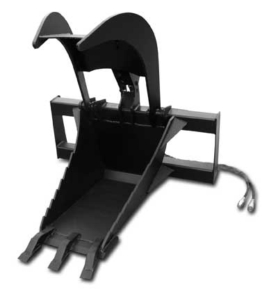

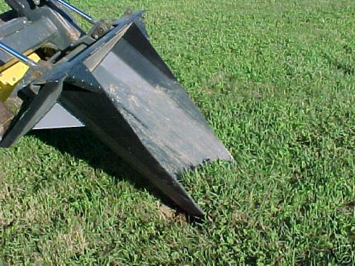

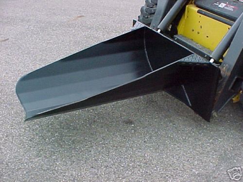

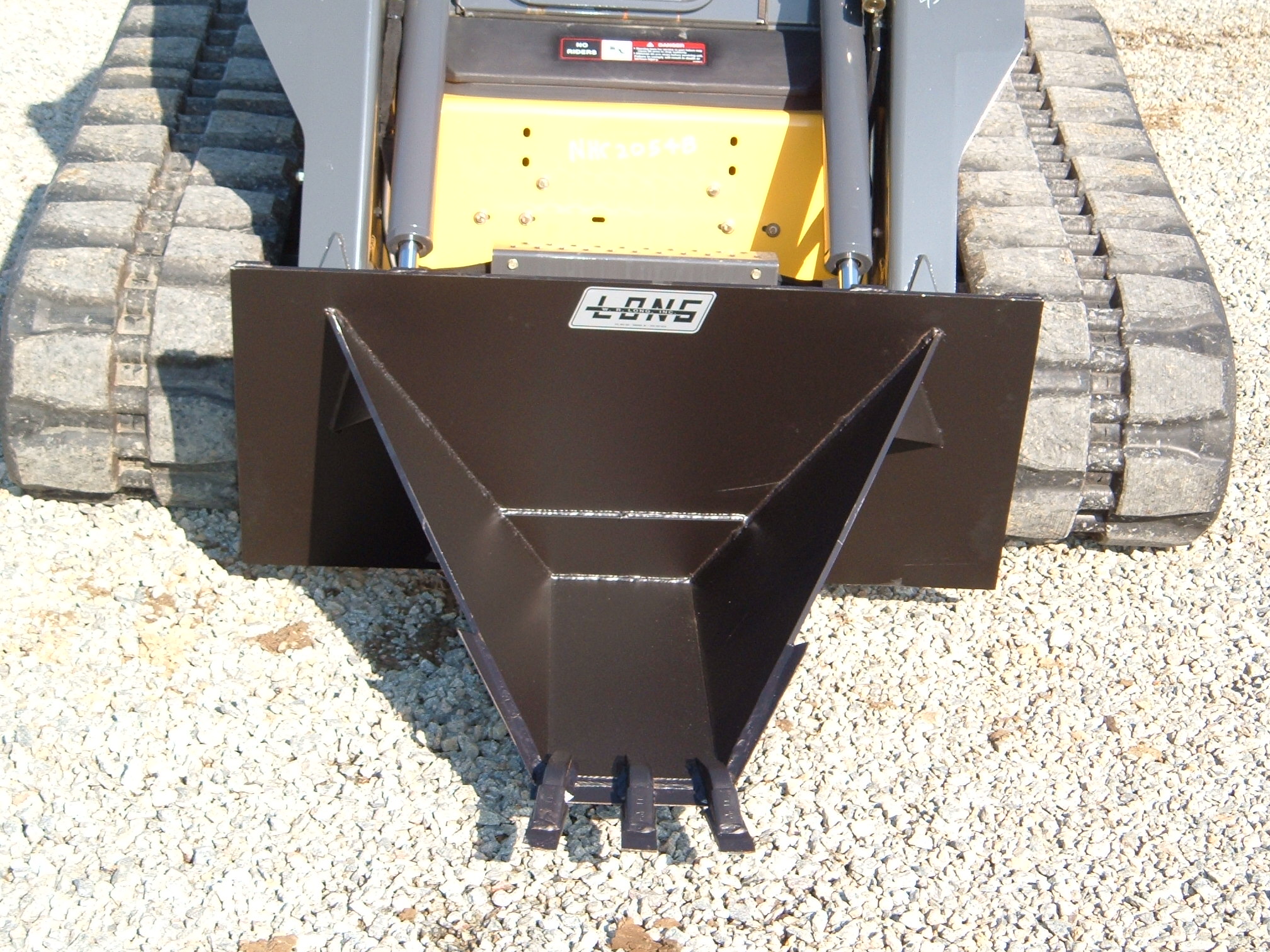

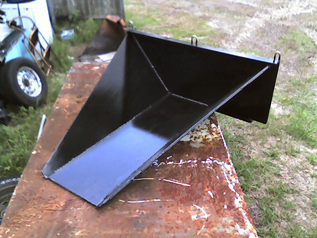

Something like these. A friend of mine, who passed away made the last tree scoop. It is made from 3/8 in steel.

I have a stump bucket that looks a lot like the first one in JJ's pictures. I use it on my NH 3040 tractor. I really wanted something to pop oak stumps out of the ground, and it does fine with 3" to 6" toothpicks. Much bigger than that, and it ends up taking me a lot of time and digging to get them out. Keep in mind that I'm new to my tractor, and probably not being very effective yet. I also don't have quite the hydraulic muscle a Bobcat does, so I have to depend on digging with the weight of the tractor moving forward.
