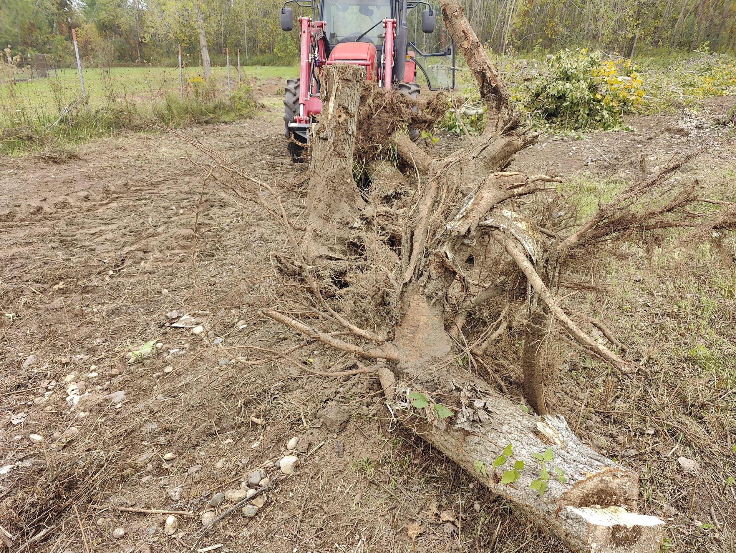

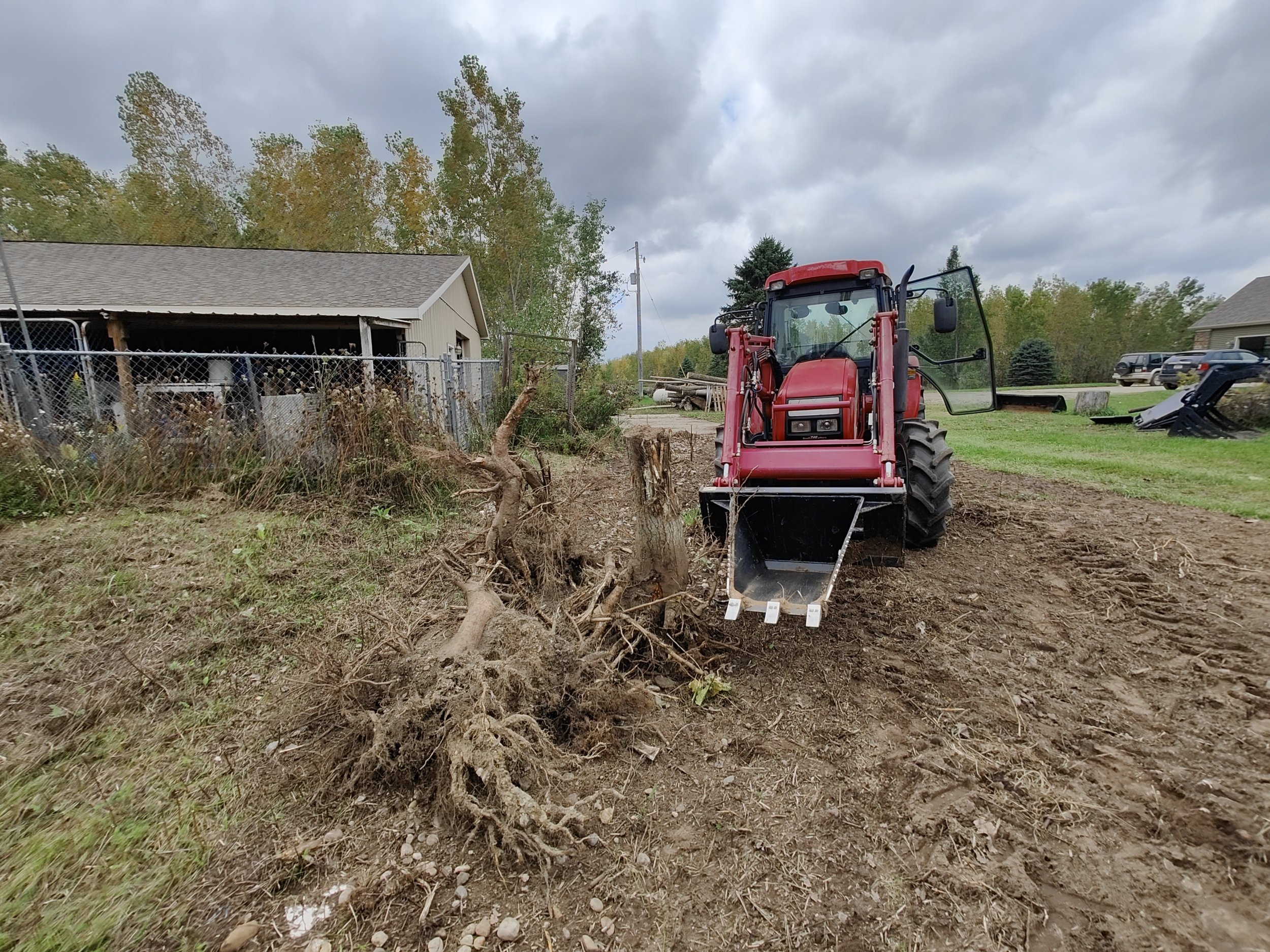

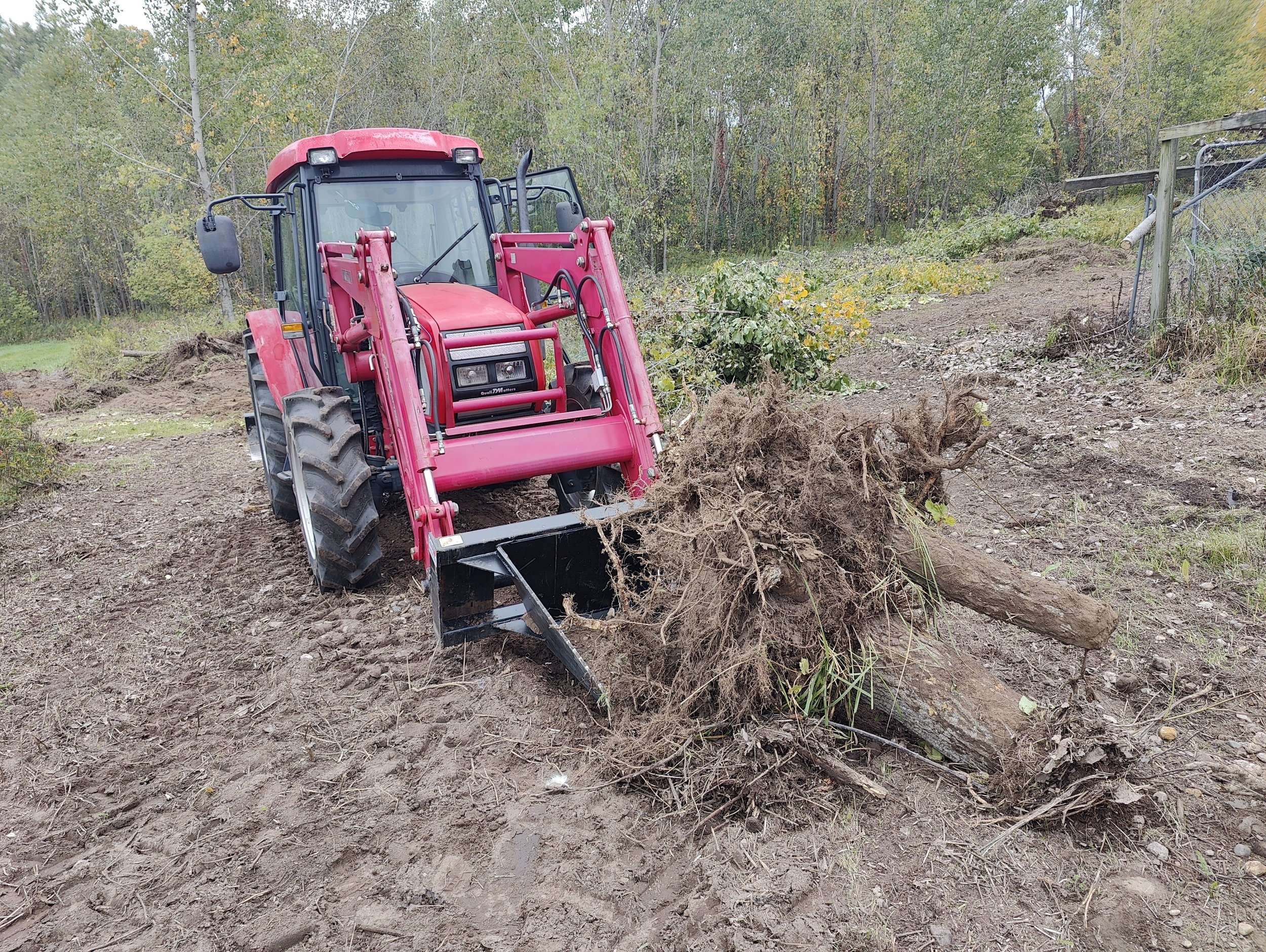

I bought a stump bucket from Cleaveland Equipment it really does a nice job. A very quality piece of equipment at a decent price delivered to my door. Jeff Von Lehmden
