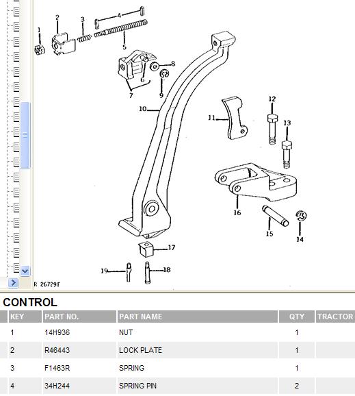

Found this lock, and wondered if it was what you are seeing/looking at?
Shot in the dark, but the spring-loaded lock plate item #2.

So it was what RoyJackson pointed out...pulling the lever out right below the joystick, I must have pushed it in with my knee and never had used it before. Thanks for the help.
