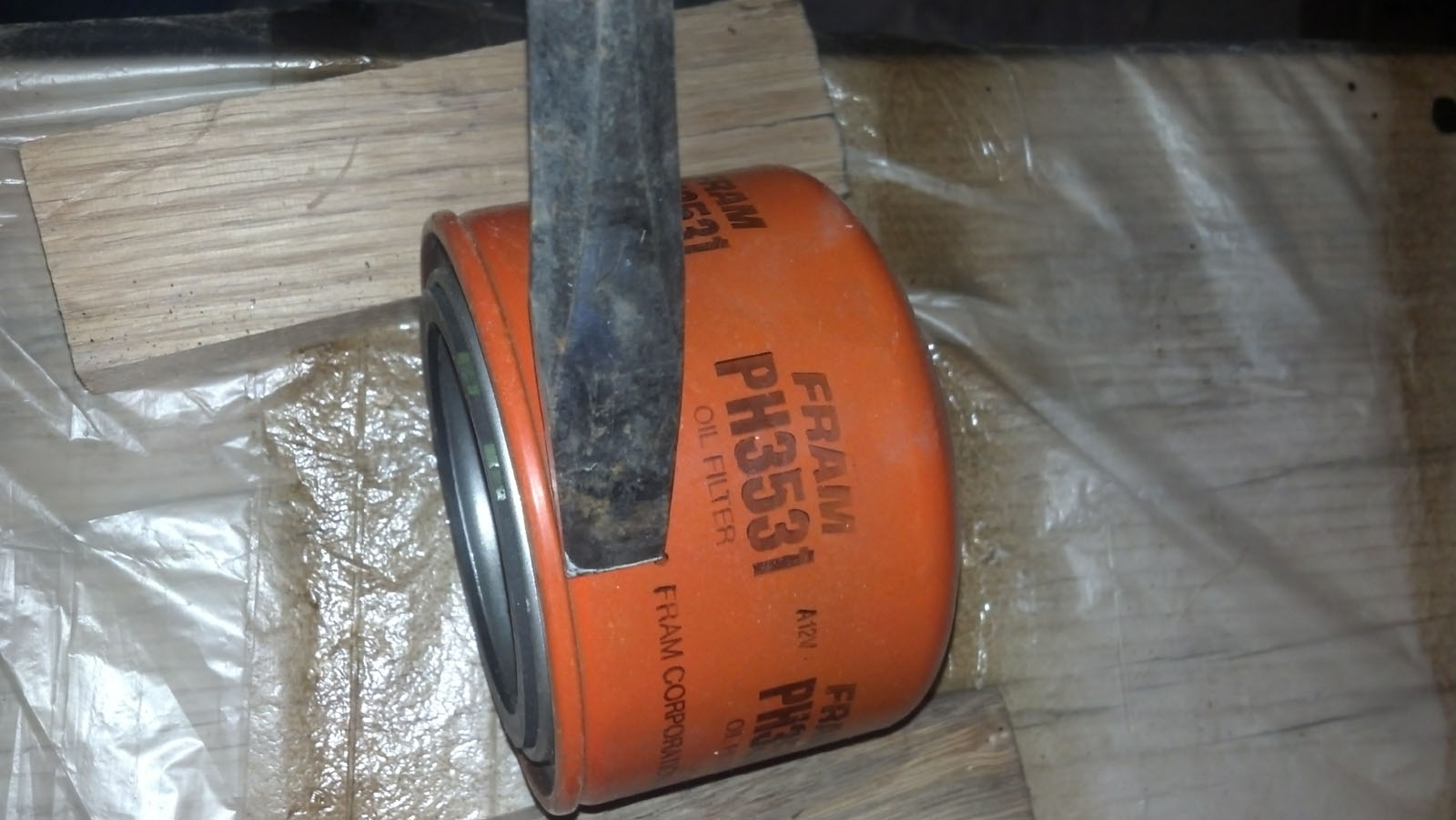

I've been very busy building the new house. The M59 has been a huge help in so many ways.
I hit 400 hours and went to change the hydraulic fluid. All went well, except, I cant get the hydraulic filter off. I've tried varous wrenches but no luck. :confused:I even stripped off one of the lugs on the filter.
Anyone have any suggestions, Please??
Thanks

   / Stuck Hydraulic filter #3
A trick I have used on stuck automotive oil filters is to placing a large screw driver up against the filter can at the edge of the flange and whacking the screw driver with a hammer. Angle screw driver so that when you hit it rotates the filter in the direction to unscrew it. Be careful not to hit the flange on the tractor side. You may puncture the filter doing this so you should have the oil drained. Note placement of the screw driver blade in the attached picture where the filter has some strength. Start at a steep angle in lightly tap to get the screw driver to bit into the filter and then go to a shallower angle and give it a hard whack. The screw driver in the picture is 24" long with a 9/16" wide blade. You could use a chisel, but you would want to square of the cutting edge.

I had the exact same problem on an L48.
I used a chain-style pipe wrench and attached a Come-A-Long to the handle and to a place on the rear of the tractor. A few strokes of the Come-A-Long and the filter became loose. Wrap the chain as near to the attachment base as possible. The screwdriver method doesn't give quite enough torque and may just rip out the filter body.
