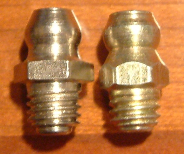

On the left american. On the right, metric.
I have a couple of Kubotas (metric), after squeezing grease in the zerks the only way the tip comes off is by loosening it.
