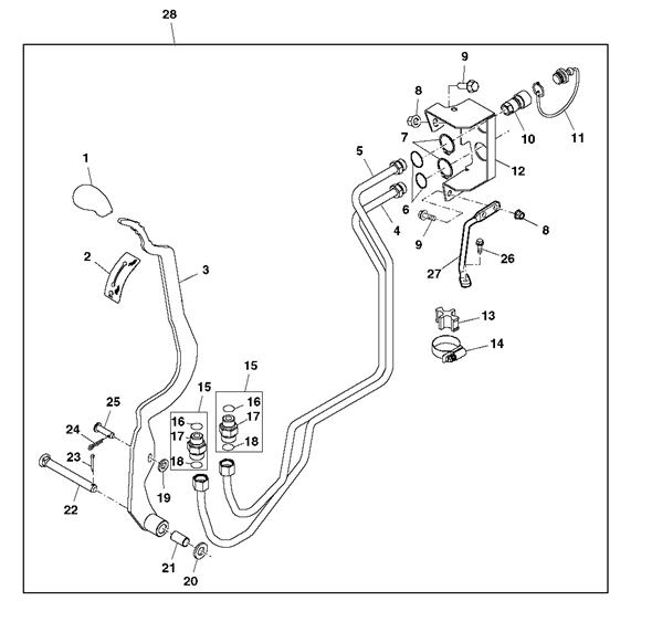

Third - the kit came with three little o rings (I think that is what they are but I cannot tell where they should go and there is no apparent reference to them in the instuctions? Three seemed to be an odd number to me as well?

As far as the o-rings, I am not sure...have you looked at the parts diagram on JDParts?
   / Stuck and Need Help! Installing a 3rd SCV #5
There look to be 6 shown if this is the kit (looked it up under jdparts).
Shown as 6, 16, and 18.

Thank You - The picture sure looks like six but JDParts lists quantity of four (#6 2 and #16 and #18 1 each). I only have three as far as I can tell. Assuming these orings are "standard" and I could pick one up at the local hardware store?
   / Stuck and Need Help! Installing a 3rd SCV #7
get one from deere or a hydraulic shop....standard cheap ones are usually a little oversized and squash out easily.....not worth getting a leak over....
