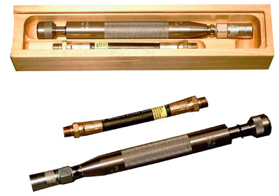

I have the same problem quite alot and not just in the winter. I usually hear the joint with a propane torch and then use the Lincoln Power Luber on it. I recently purchased a tool from Gemplers that uses light weight oil forced into the fitting to loosen it. Seems to work pretty well. Grease Joint Tool

Hey that's a neat tool & seems easy to use. (Nothing fancy) I definitely have to get one. Thanks for the tip.
