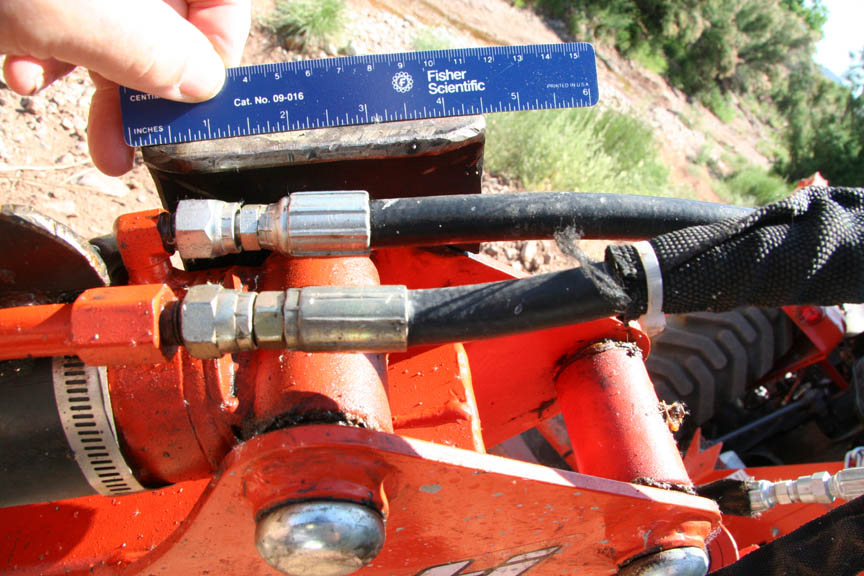

I'm using a Kioti KB1914 to dredge under a low bridge and I struck the pressure fitting for the bucket curl hydraulic line, which is on top of the dipstick, on a bridge beam, damaging the thread and the hose fitting; I had a new hydraulic line fitting made, but now have a worse leak due to the threads on the fitting welded to the hydraulic cylinder being very badly damaged. (I can operate the bucket, with some leakage as long as I keep the hyd. oil topped up).
What are the options for replacing/repairing the damaged fitting likely to be available in a small town shop? Saw off fitting and weld on a new one: saw and tap for a different fitting?
An old-timer suggested installing a coupling as there are 3 unused threads at the base of the fitting, and modifying the hose to mate with it. Would this approach seal properly?
Anyone happen to know what the thread type is on the KB1914?
I'm new to hydraulics repairs, and would like to be informed before driving 26 mi to the shop that has agreed to "look at it".
Accessibility to the fitting is not good, because I had a friend weld a vertical guard (steel plate) to the frame to which the cylinder is attached after the initial damage (too late!) Just room to get a wrench in there. Maybe I should get him to remove it with his plasma cutter before going downtown?

I would cut guard off and if he is a good welder take cylinder apart and cut fitting off and weld a 1/2 coupling in place weld some tabs on cylinder and bolt guard on to tabs then reassemble cylinder.

Without seeing it, it sounds like the striped bung needs to be cut off and a new one welded on. Remembers that the operating pressure is about 2500 pounds, and the shock loads can easily be 2X that, so the repair must be solid.

Get a quote before you authorize any work. Cost to repair may be 2-3x the cost of a replacement generic cylinder!
If it's just a bung cut and reweld - a decent machine shop can do it for about 35-50 bucks. You will have to take the cylinder apart to get that price. Having them take it apart - clean it - do the repair - clean it again and put it together will run the labor up to 2 hours or more. Probably more.
Surplus Center - Hydraulic Equipment Electric Motors probably has your cylinder cheaper than the repair cost.
These people will have the threaded port. If you repair it - buy a port and take it and the dis-assembled cylinder to a welder.

I have tried to attach a photo to show the problem here. The fitting in question is an elbow, and is next to the guard I described.
(To the left is a second guard that runs down the top of the cylinder to protect the metal line that runs there.) They would have worked nicely If I had installed them before the damage was done :-(

The elbow is welded to the cylinder and painted; some of these JIC fittings can have a thread or tap in fitting on the base (I think), so it could be anchored AND welded.
The shop says they will cut through the weld and see if the fitting will pull or screw out. If not, it's a new sleeve.

Looks to be plenty of room without removing the guard, & also enough room for a straight female to male coupling. I'd try fitting that with Loctite (take advice from a hydraulic shop as to the grade) & give it plenty of time to set. Then carefully refit the hose without twisting the coupling. Suck it & see! All you have to lose is the price of the coupling. If it fails then take it to the experts, though personally I'd try welding a coupling to the elbow before I admitted defeat. But again, I am mean!! :D (Does that translate as "tightwad" over the pond?)

John_Bud: I don't want to take off the hose until I commit to a repair - I can still get a little use out of the hoe; but I can tell you it is a JIC compression fitting almost totally stripped. I'll attach a close up. 3 good threads remain which might catch Pycoed's coupling.
Pycoed: are you suggesting a repair with the existing fitting -I am not clear? How about JB Weld? (We don't have any experts n my area; it's DIY or the dealer's expensive way.)

John_Bud, in answer to your (deleted) question, the threads are integral to the elbow and cannot be removed.
I think I am just going to weld on a new fitting and am looking into what that requires.

Charlie,
Yes - I go along with your old-timer's advice. Remove the hose, then, if there are three completely undamaged threads at the base of the damaged elbow (male), then I'd try a female coupler screwed onto the damaged threads & all the way onto the OK ones. Wipe the threads dry & put some Loctite on them before fitting the coupler. There are Loctite grades for hydraulic seal, others for a permanent fixing, some even with gap filling properties). The other end of the coupler should be male to connect to the existing hose that you removed. Cost will be one coupler plus some Loctite ($10 max assuming your prices are the same as ours - they are usually much cheaper it seems to me) & should take 15 minutes to do. If it doesn't work then at least you still have a coupler & a bottle of Loctite!
