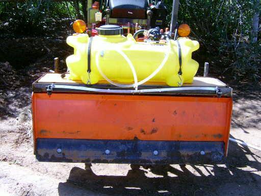

I got me an ATV sprayer and sprayed about 3 acres with Roundup 2 weeks ago. Now it is striped green and red/yellow. Apparently I didn't have it mixed good. I ordered an agitator for $25 today. Don't know anything the agitators but I hope that does the trick.....
My sprayer just has a hand nozzle, and I'd like to rig up a couple of broadcast nozzles maybe strapped to a piece of one by two clamp to the back of the mule. Unfortunately, Northern Tool did not have the fittings you screw the nozzles into, nor did they sell the hoses for that. Anybody know a source for that? Northern tool does sell a "boom kit", but its $100 and has a metal boom I don't want and am not sure how I would mount to the Mule anyway.

I've been thinking about making a boom also. I was contemplating just taking some 1/2" pipe, and drilling holes and tapping to the size of the spray nozzles....
anyone tried this?? We might need to ask in the "build it yourself" group........

You can probably buy something as cheap as making it..
But if you have some of the parts just laying around go for it.
Keep in mind the the number of nozzels, the rate of flow your pump is capable of etc. You dont want to wind up without enough flow and pressure to properly operate the nozzels.

I agree with others that an agitator would be a waste of money. The general sloshing in the tank should keep it well mixed. I think your problem is with coverage. I'd suggest more nozzles. Test it on dry pavement with plain water to adjust your coverage.
