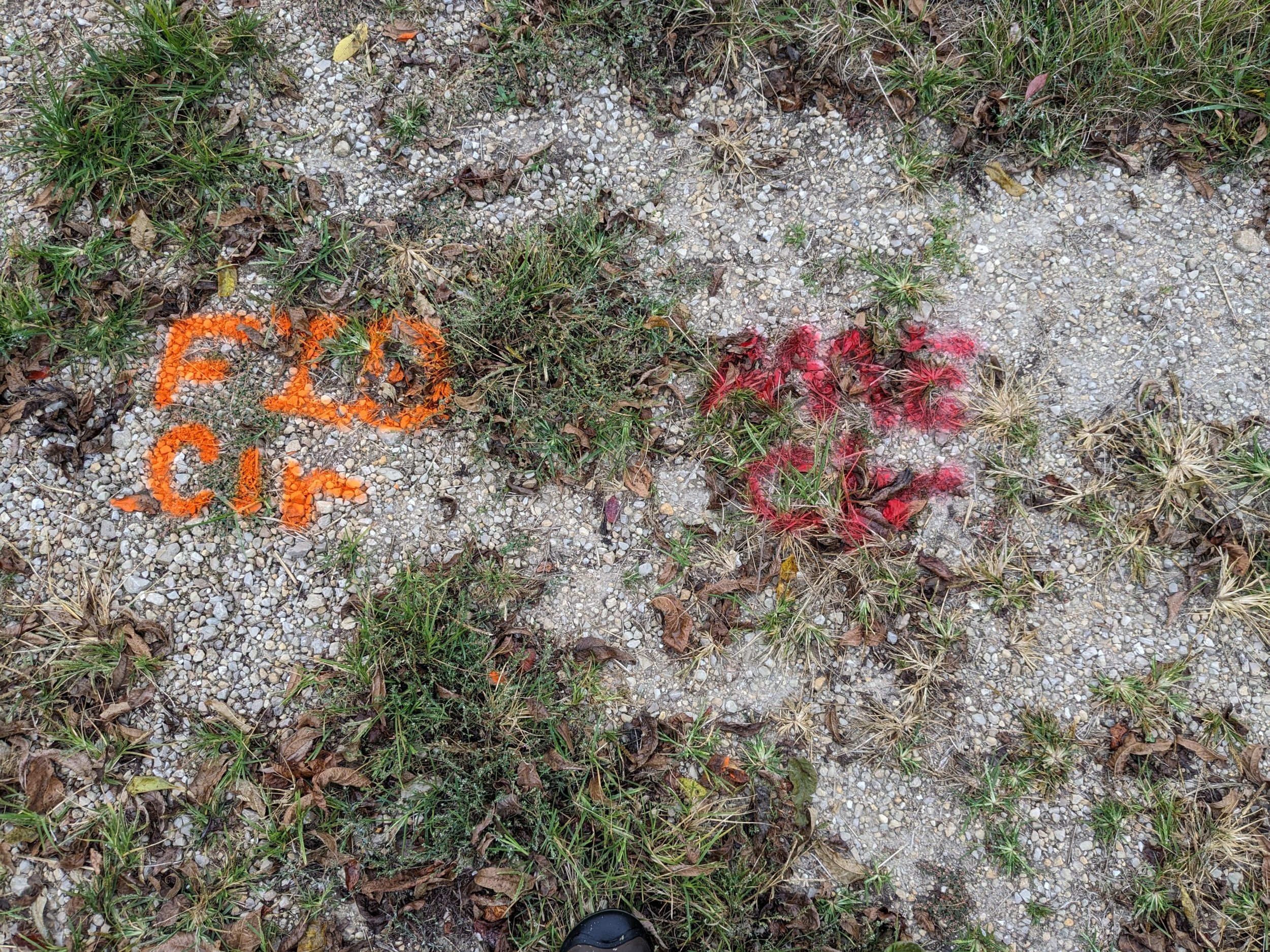

I found the attached painted on the ground at the end of my driveway. I only go to my property every couple of weeks but from the looks of it they were painted fairly recently. Does anyone have any ideas? They look something like survey markings but I didn't find anything else nearby.

Yep. Utility locate markings.
   / Strange Symbols Painted on Ground #4
It looks like somebody has called in a utility locate. I don’t know the abbreviations at the top but the bottom is CLR which means clear. The orange is phone and the red is usually power.

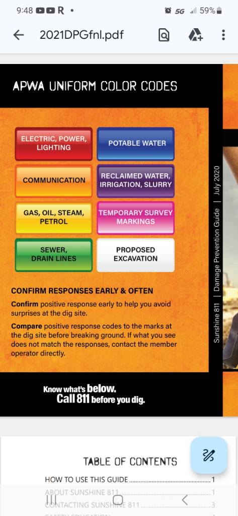

   / Strange Symbols Painted on Ground #5
Here, power is white, blue is water. I couldn't tell you what the others are.
Purple=reclaimed/grey/raw water
Blue=water (potable)
Green=sewer, (sanitary gravity or Forcemain); storm sewer is technically not a utility, but a roadway facility, and are not covered by locate rules
Red=electric
Yellow=gas
Orange=telecom (coax, copper, fiber, leaded air, all telecoms)
Pink=surveyor
White=contractor marking where he needs locates
These are set by the Damage Prevent Guidebook in Fla, (think it's FS 556 or something) may differ state to state

There does seem to be a contradiction at times for effluent lines; I've seen them marked as blue, green, or purple; (water treatment waste, paper plant discharge, brewery discharge, ect)
