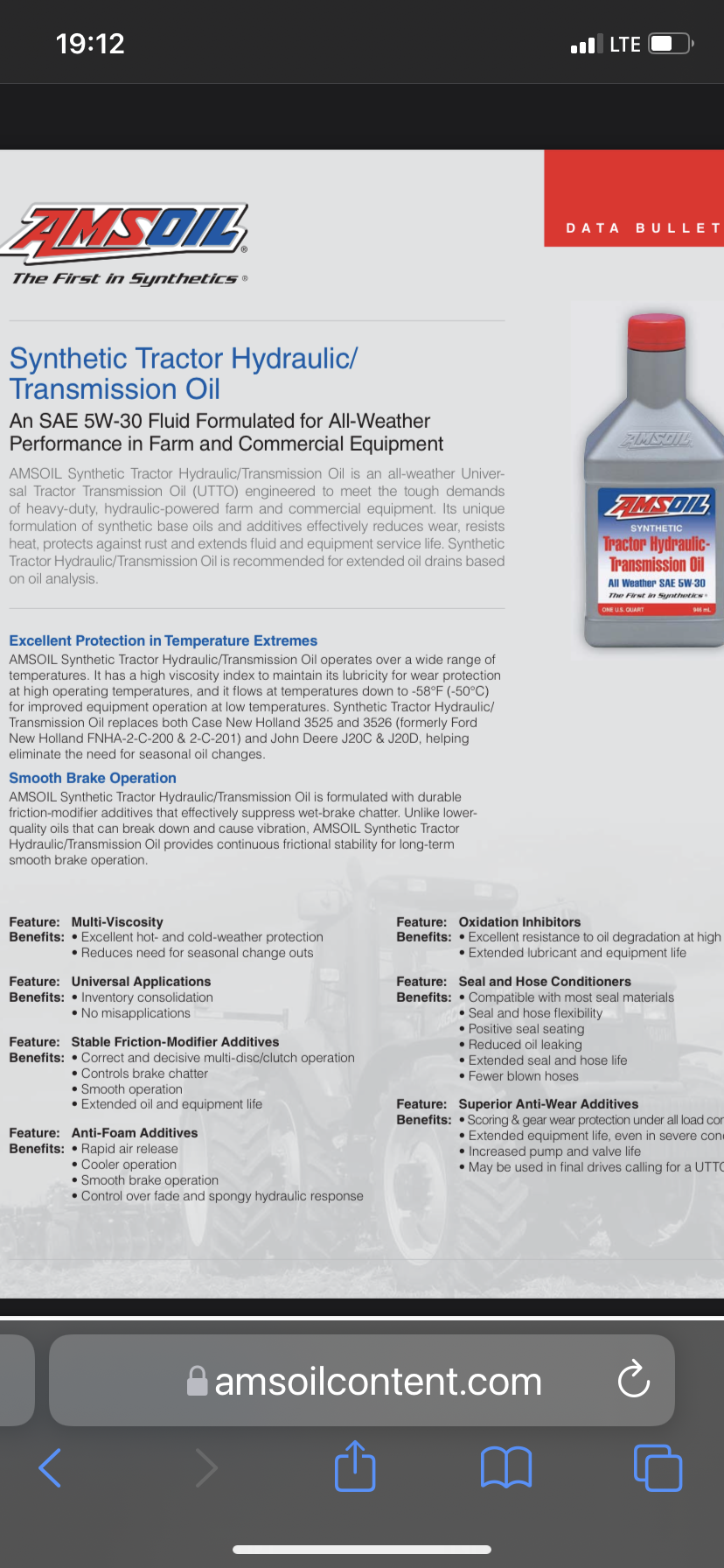

I’ve been using Amsoil Tractor Hydraulic Transmission oil since the factory fill break-in oil was changed. Sent a sample for analysis at 400 hours and it was good for continued service, so I just changed the filters. Will check again after 300 hours? The oil always looks clear even after 2hours of blowing snow or 3 hours cutting grass. I checked the info online and one feature mentioned was “rapid air release” amongst multiple other features. Is that mentioned with other brands? Not sure, but I’m very happy with it, especially the fast hydraulics with only just a short warmup in our cold Canadian winter temperatures. Not cheap but if I can extend the change out for 2/3 times, it’s more than worth it to me. I’ll try to post a picture of the info…
