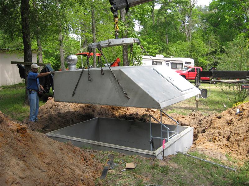

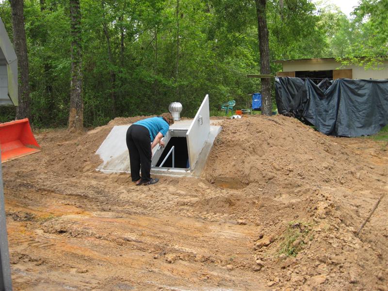

Nice job! Unfortunatlely my City codes do not allow shipping containers any longer or I would have probably went the same route as you.
When and if the budget ever allows I want to install this type of storm shelter in my backyard:
I would not set it quite as deep as I did this one up the country a ways. I have never had a flooding problem on my property but I believe I would allow an additional 12" of "freeboard":D just in case.
