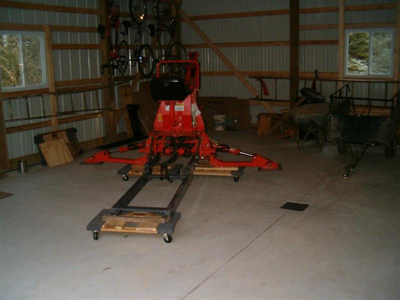

I started out at Home Depot buying a couple of those furniture dollies. They cost about $20.00 but are probably a few buck more now days. They are rated a 1000 lbs a piece. The first thing I did was sheet the middle or open area with 3/4 hardwood like the rails of the furniture dollie or scrap 3/4" plywood. They were so darn handy I have added to the original pair and probably have half dozen. Obvioiusly, you need a concrete floor for storage when using this method.
They are great for my backhoe and an added benefit is that you can move the equipment slightly to line up when installing. That was the hardest part of reloading a backhoe so far as alliogning an inanimate backkhoe exactly as it requires. My rear snowblower resides aboard a pair of those dollies for the summer,
