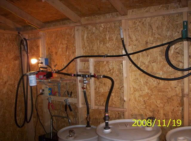

Here is my set up.
http://www.tractorbynet.com/forums/1527990-post25.html
As you can see I use 3 of the plastic drums for it.
The first is a 30 gallon I use as the main tank.
The second one is a 55 gallon i use for a reserve tank.
The third one is a spare 55 gallon that I use for going and getting fuel if i need to but I haven't used it as I get home delivery and have the second drum filled only when it is empty.
There is no extra delivery charge or min delivery amount if you work it right.

   / storing diesel in plastic drums questions #5
1*I take the drum down to the distributor and get it filled.
2*then I use the front end loader to offload at home.:)
1*The delivery guy fills the second drum with the red off road fuel.
I get 55 gallon at a time.
There is no min delivery amount or delivery charge this way so i don't fool with taking the drum to him.
2*The Third drum is a 55 drum I would take to get fuel in if i was going to pick up fuel.
I don't use the tractor to off load it once I get it home.
I simply insert the end of the hose that's looped around the green hose hanger into the drum while it's still setting in the bed of the truck and use the red diesel fuel pump to pump the drum enpty into the second drum in the picture.
Next I simply set the now empty light drum off the truck back into the building where you see it setting now there in the corner.
