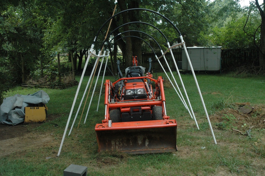

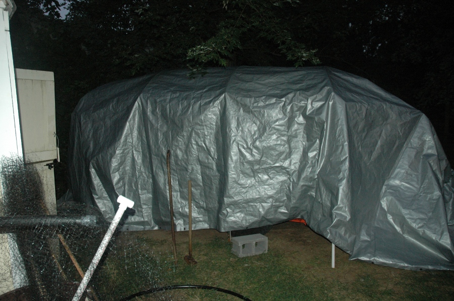

I've built a number of tarp over galvanized tube frame canopies and shelters on my own. They are very inexpensive and work well (I've got a 12 x 18' example here at home as a zoning and permit exempt adjunct to my hard shed) but my experience is that they need more attention than I would be able to provide at my remote site. Tarps need monitoring for rain sag and occasional changing, snow needs to be knocked off, bungies sometimes come loose, etc. My site gets a lot of rain and wind, so I'd be concerned about a failure while I'm away.
Yes tarps need monitoring, but the shelter logic I bought was < $300 and well built.
