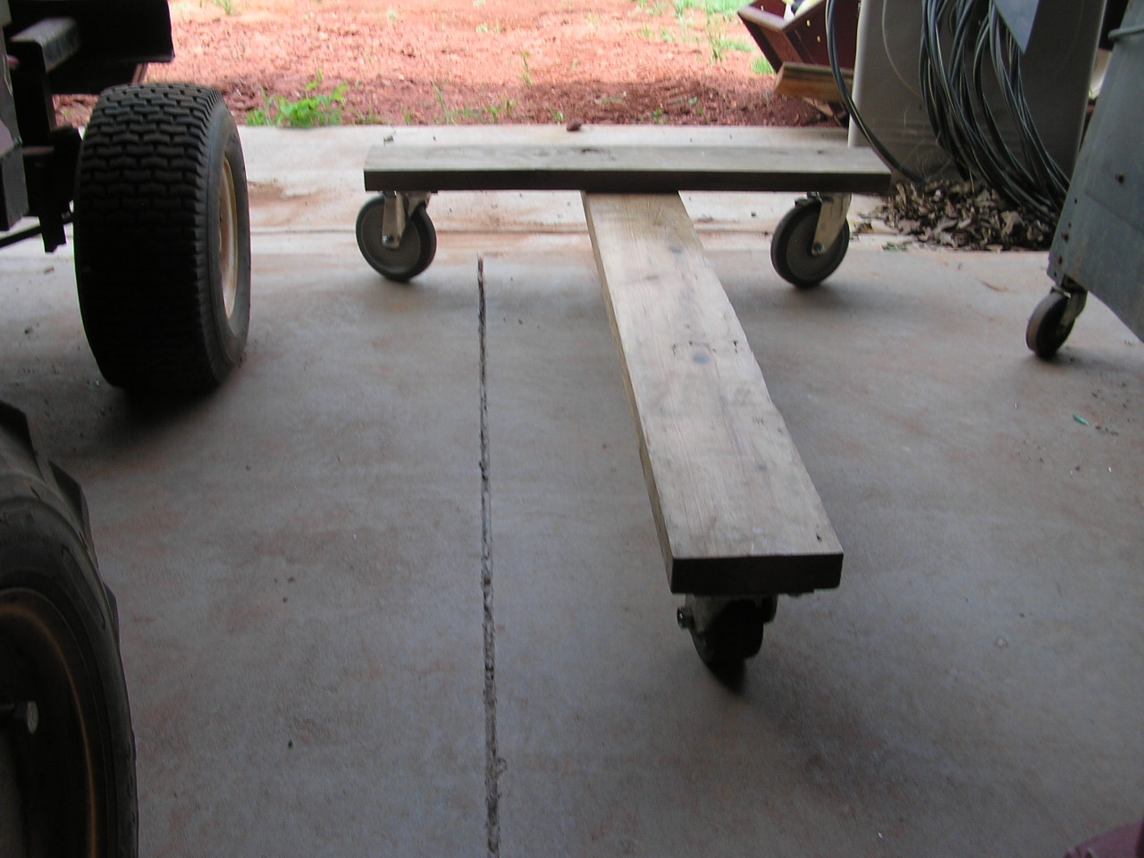

You have not told us what surface you are planning to store your implements on. However, If you have a cement floor, you can build pallets with casters to store your stuff. Pallets do two things for you - 1) makes storing the implements in the least space a breeze and 2) makes hooking up very easy as you can move the implement rather than the tractor. Most implements come on pallets when shipped to you or your dealer so using those pallets make it a lot easier and less expensive. On the other hand pallets are not that difficult to make and can generally be made with scrap lumber. A set of casters from HF costs about $20.

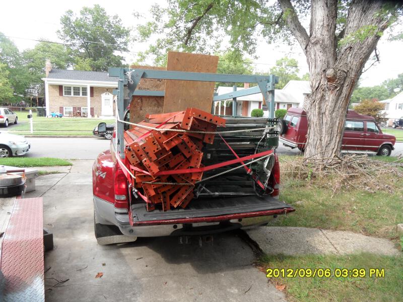

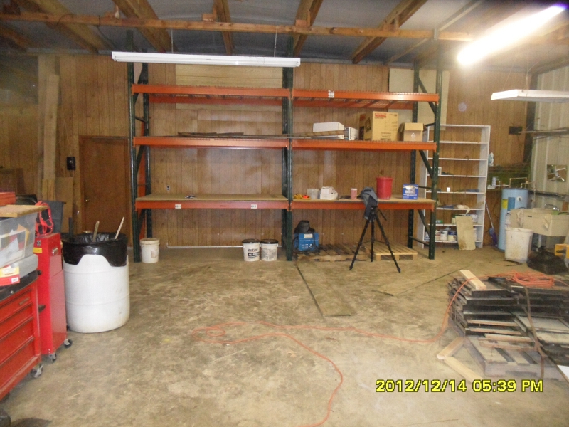

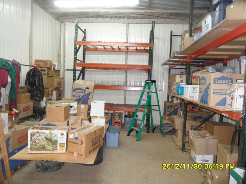

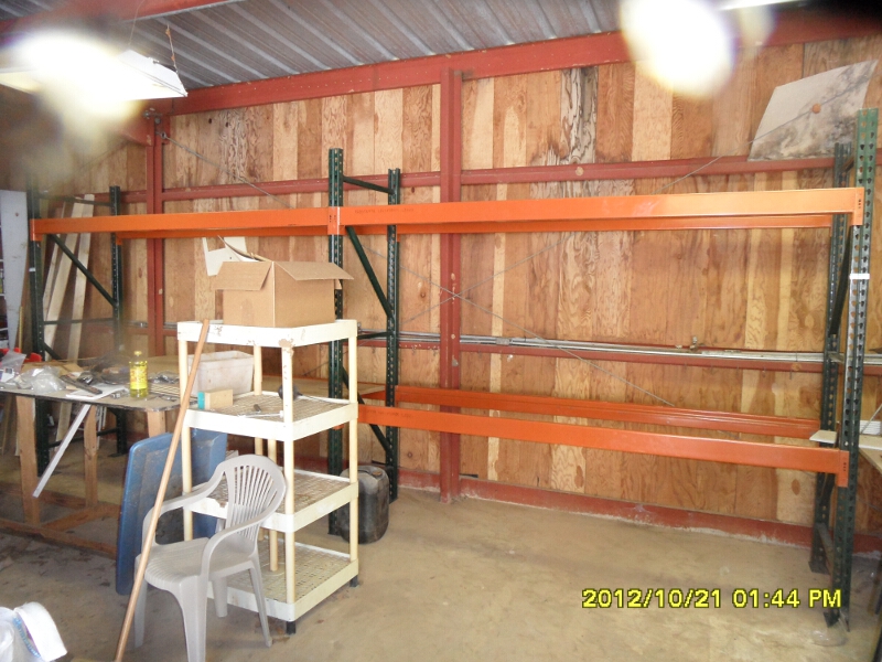

Pallet racks are a good place to put pallets.
I like pallet racks.
The difficulty arises in getting the pallets above the reach of your FEL :)

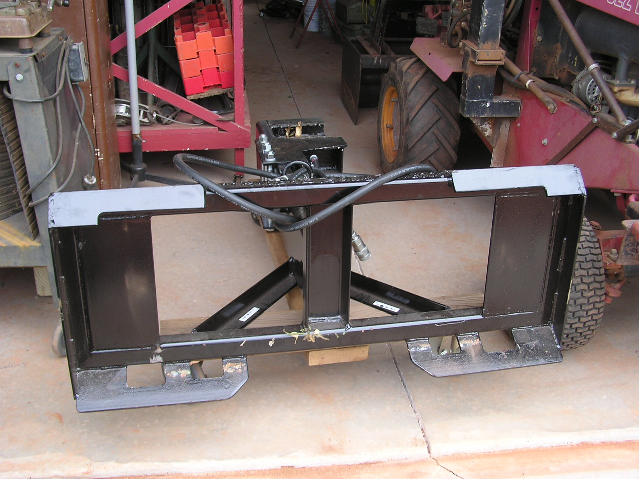

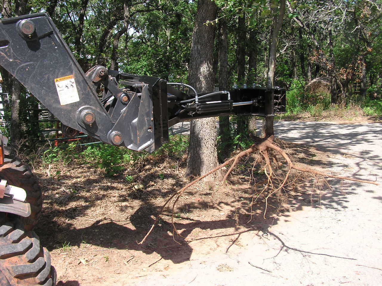

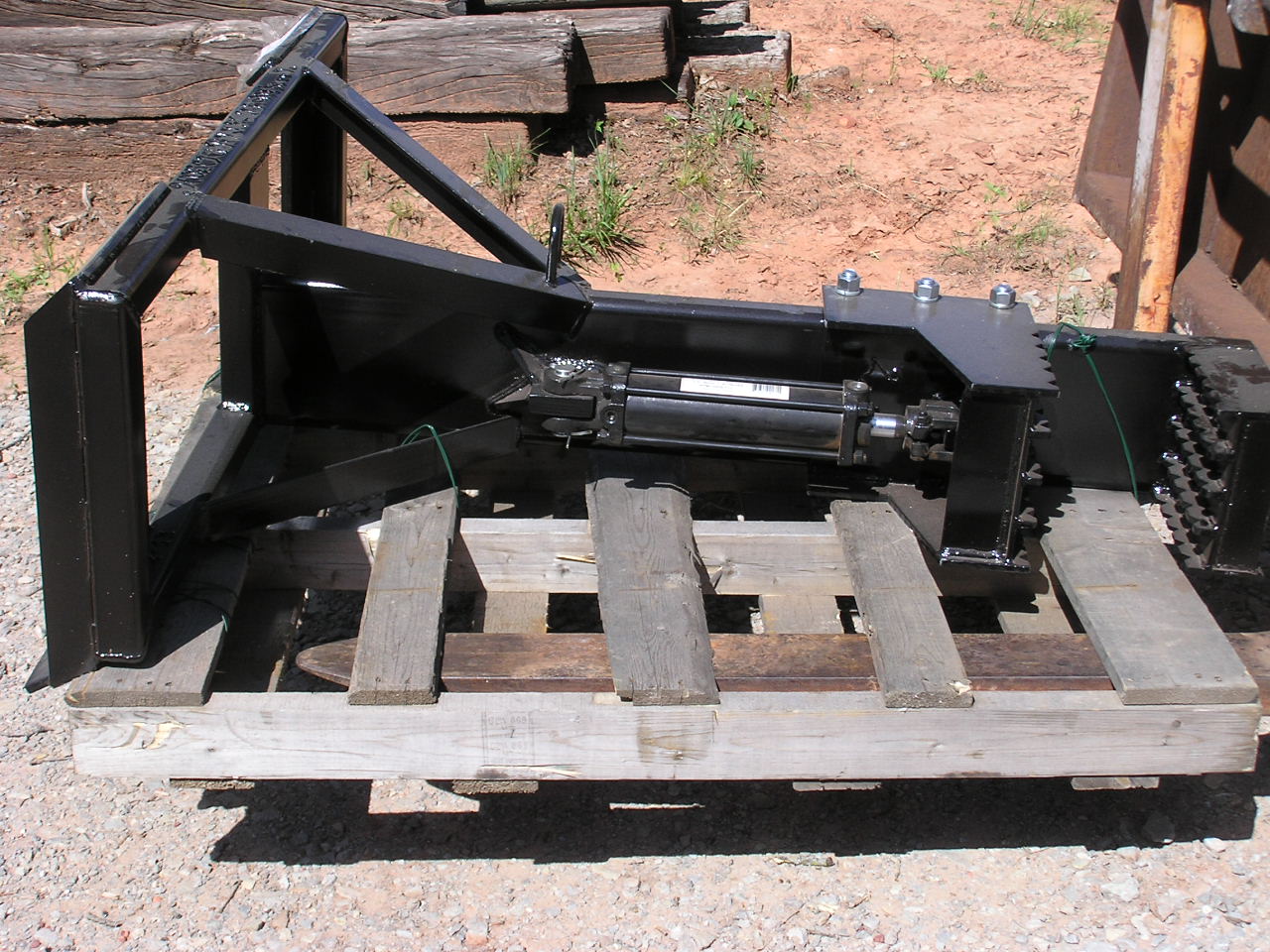

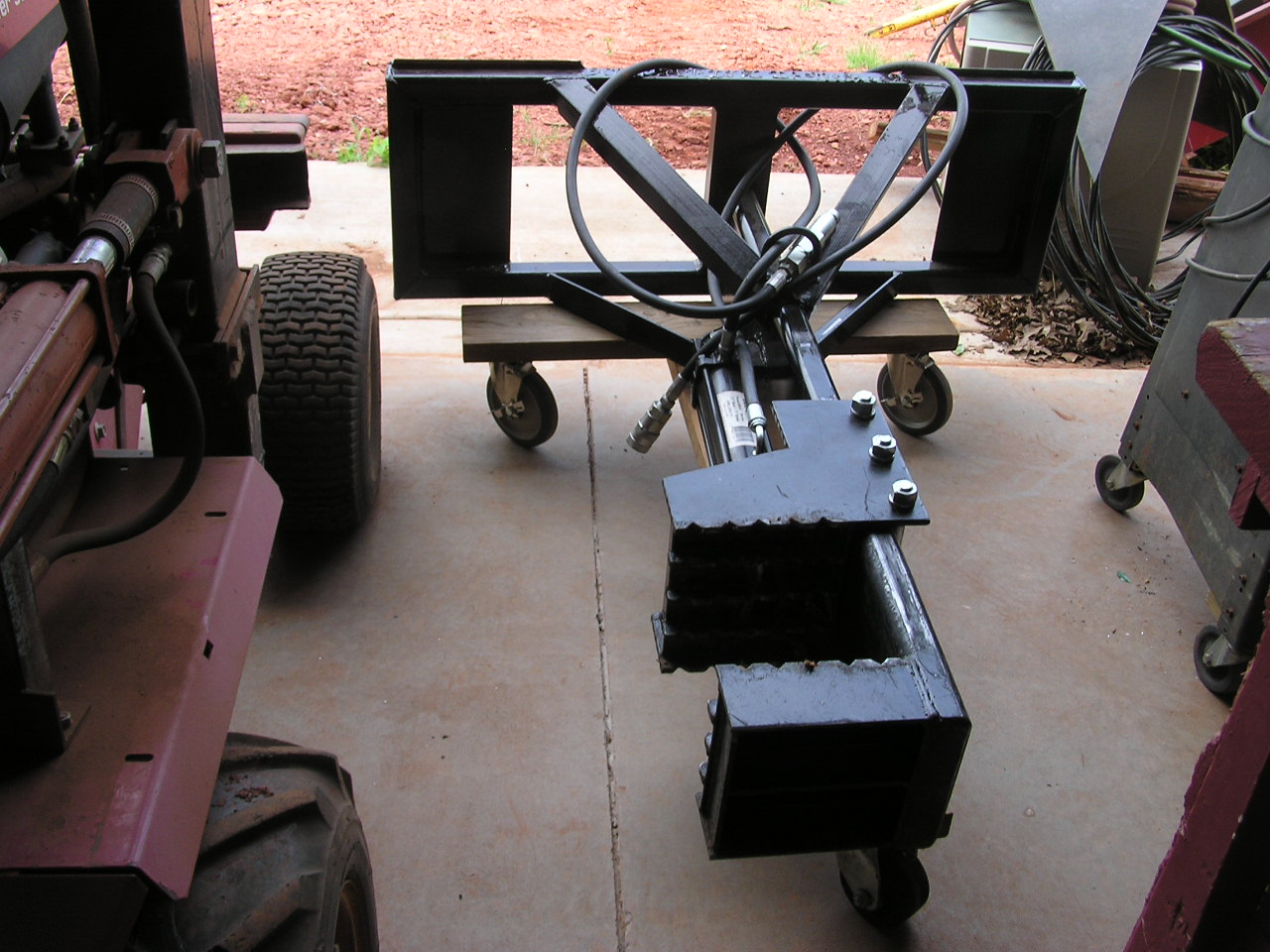

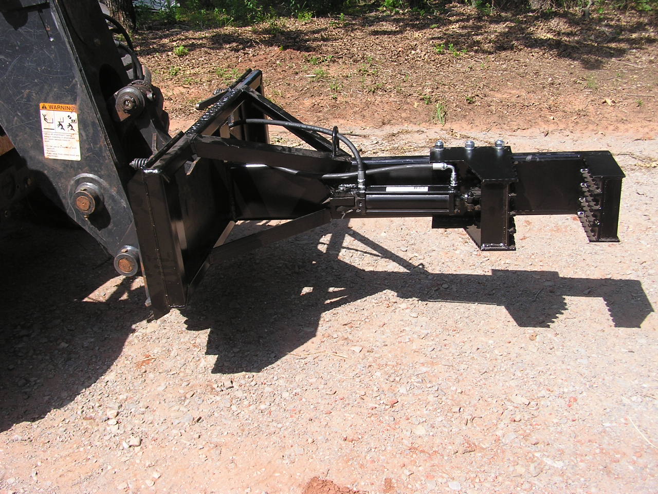

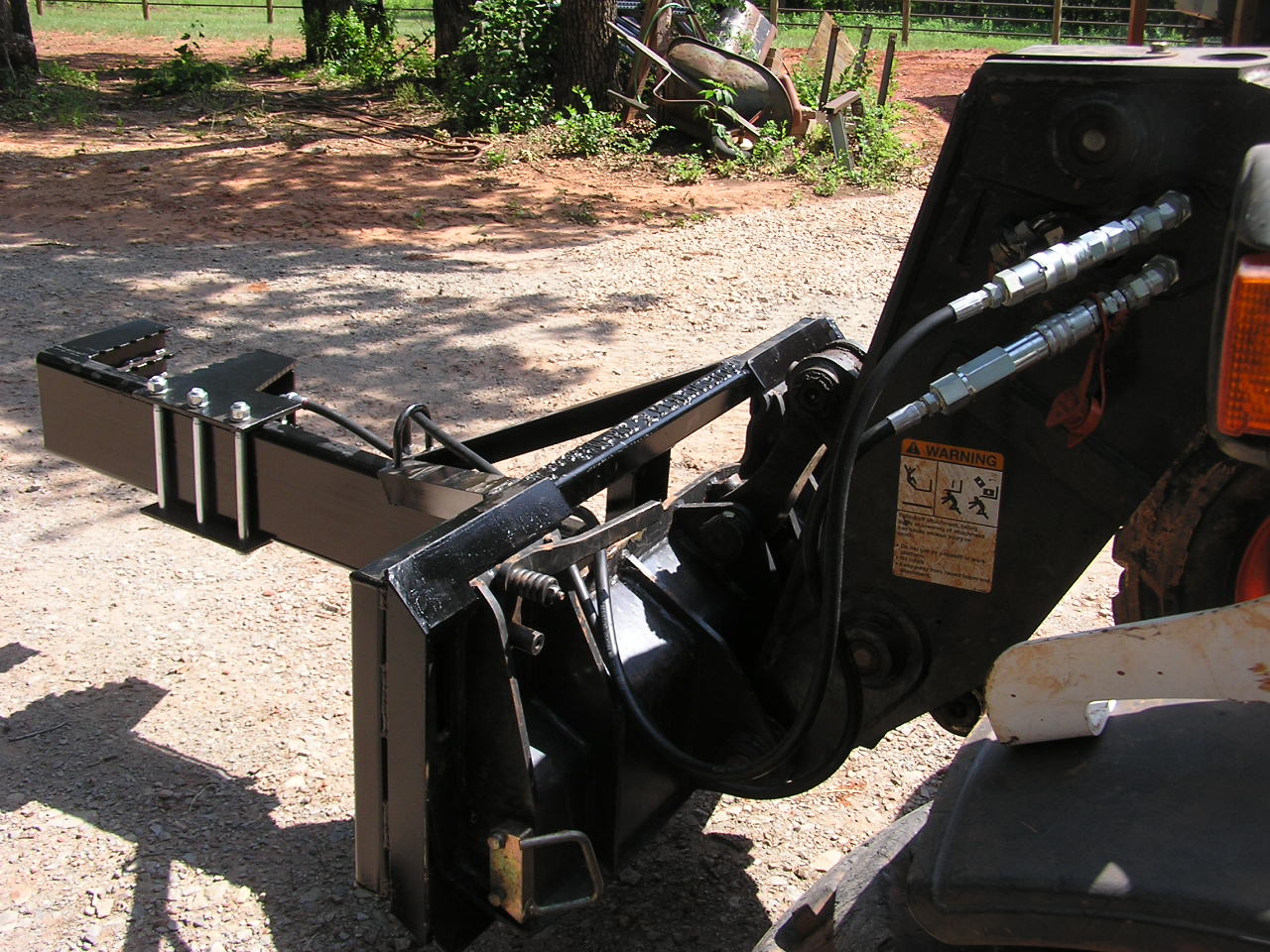

Almost everything in my shop is on casters, so when I got the tree puller I made a three wheeler! :D
I had one heavy duty caster that was 1 1/2 inches shorter than the big ones, so it was easy.
The tree puller.
First tree pulled.

Oh for crying out loud... casters! Why didn't I think of that. Thanks for jogging my tired old brain, whirly.
