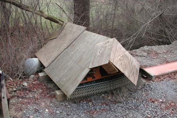

I keep most things outside, but I hate to do it with things that have shafts and U joints and such. My PHD resides in the shed hanging from a chain over the winter, but it hangs from a tree spring to fall. No room in the shed for something large like a 5' brush hog...
My solution... /forums/images/graemlins/blush.gif ... photo attached. Actually works real well. I am thinking of doing it a little differently, and making a "formal" shingled roof that will pivot on a pipe across two posts, so I can flip it up and then back down over the rotary cutter when I want to.
Keeps the snow off and probably works as well as my unheated shed would... /forums/images/graemlins/grin.gif
