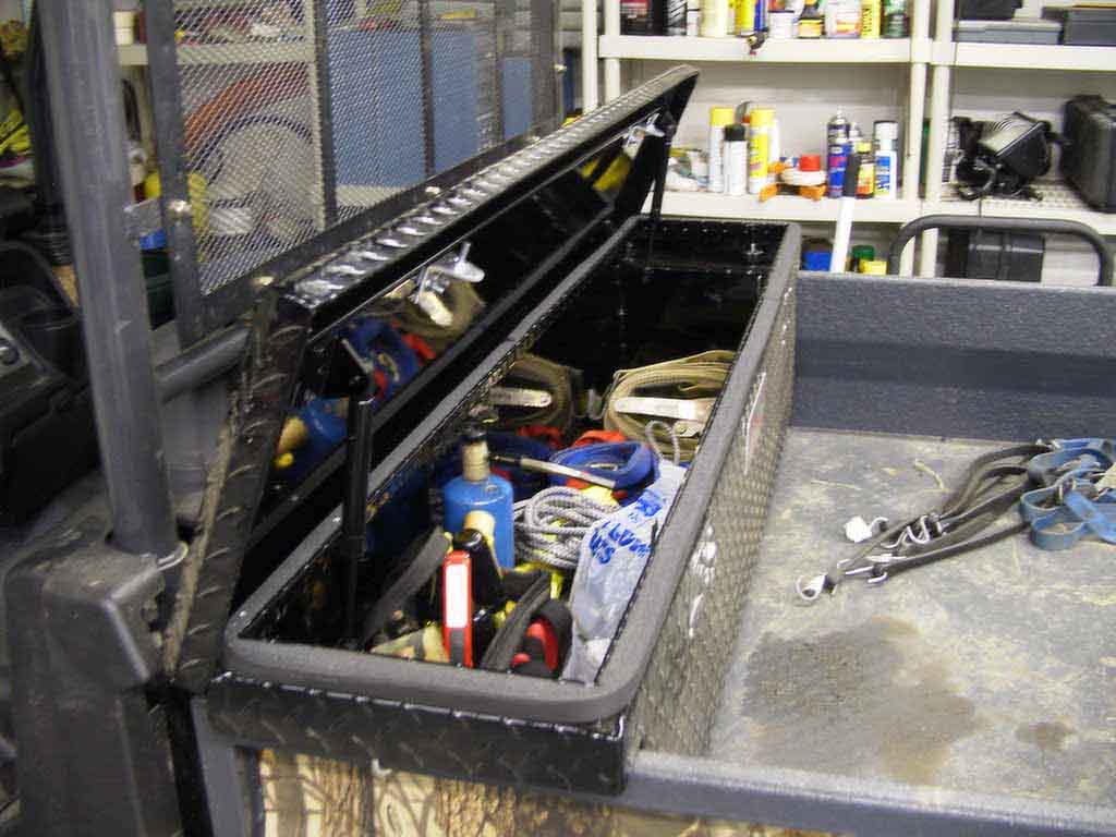

I have a toolbox that drops in the bed and is mounted with a J-Bolt that make removal a five minute project. See attached picture...

Second shot of box.
This box is made from aluminum tread plate and powder coat painted black. Lockable with SS paddle handles.

That looks great. Very functional.
I have been toying with the idea of drilling into the ROPS and attaching a toolbox near the top. Since I don't have a cab. The area appears to be good ergonomically and I could still use the dump and or stand in the bed to get the tools. Before someone dumps me of course. /forums/images/graemlins/grin.gif
I have not had the time to do it, then of course there is the dreaded "I drilled my ROPS" syndrome. But a lightweight box either centered or running the width of the ROPS would give ample room.

FL_cracker, would your bed still fit with a bedliner? I have both a spray in liner and also a drop in liner in my bed. It looks like your box seals well and the J hooks you mention would keep it from moving.

1/4" gap both sides. Future boxes will be made with 1" gap each side to allow for factory liner. J-Hooks hold it good. I have a spray in liner and I don't think you could get it to move if you used a tractor. (had to say that, this is TBN)
New utility bar will be next. This will hold my guns, bow, pole saw and other long tools.... Will post pictures over on my other thread. My Thread
