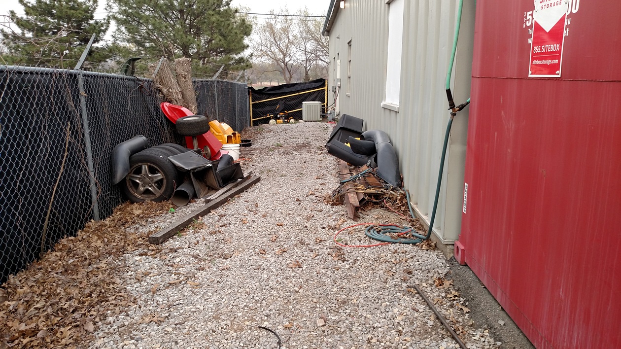

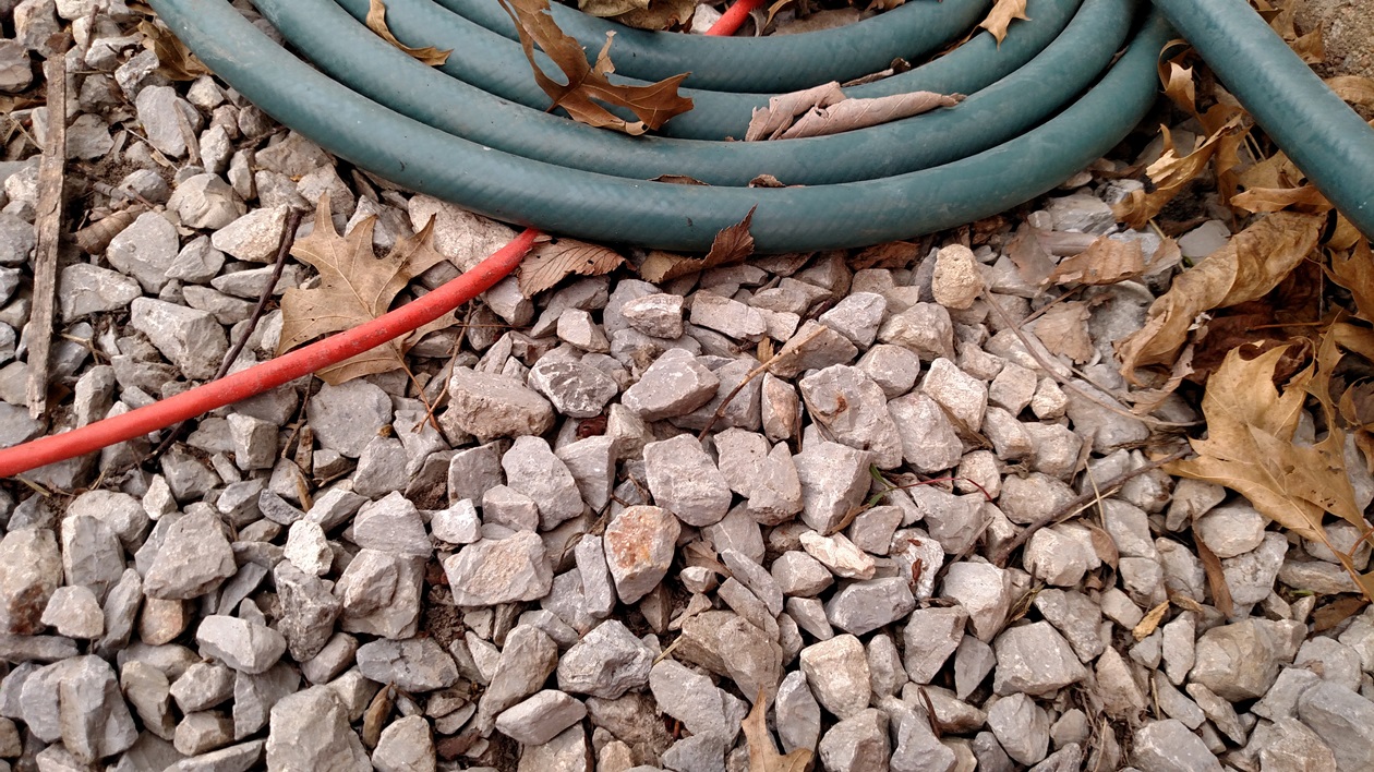

Hi,
We have just bought some 40ft storage containers. We are wanting to put 1 north of our building. I've attached some pictures. The rock you see has been there several years, but hasn't gotten anything except foot traffic on it. Under the rock next to the building is hard with rock and building foundation remenents. The side next to the fence is softer sand and dirt, but has not been disturbed in 10 years. Once the container is set we are not expecting to move it for a long time.
What do you suggest to make a stable pad site for our storage container?
We've thought about watering in a high strength concrete to stabilize the rock and using concrete parking bumpers on the edges of the container. Does anyone think that will work?

How do you intend to get the container in there first. A swing-lifter won't work.
   / Storage Continer Site
We will have a crane lift it over the fence you see to the left. They have already been out to see the site.
   / Storage Continer Site #4
I would bed some RR ties In/on that rock bed by adding some 1/2-3/4 crushed rock for bedding. Space based on the bearing points of the container floor structure. Level all up then set container. Should then have no rust problems by leaving an air space under. I use RR ties for all kinds of projects. Standard tie is 9'; just the right length for an 8' container.

I would NOT use any form of wood under it. Go with either road base road that is crushed down to fines and then has some larger rocks on it. Compact it, water it, compact it again to get a solid base. Then add a layer of square rock about an inch in size over that. This will allow drainage and air flow under the container to keep it dry.
   / Storage Continer Site #7
I agree with Eddie, put no wood under your container. The rock in your photo looks to be large enough to provide plenty of drainage and air movement under the container supports. If it is level or can be levelled then that is all you need.
   / Storage Continer Site #8
My cargo box has been sitting on railroad ties for the past 18 years. I laid gravel, then leveled the ties with poured concrete blocks.
