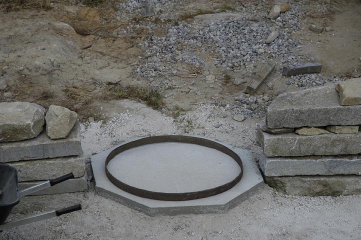

One of my near future projects is to build a stone/rock wishing well.
I wanted it to look real not a small well out of wood with cedar shingles.
I've got an odd shaped rock that I want to cover that would take about a 5' inside circle. I did not want to dig a deep footing, but I am in a 4' frost area. I thought about starting with a circular cement pad then setting the rocks in motor/cement and hoping for the best.
Anybody built one of these?

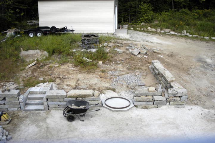

This might help. I am not a mason by any means. I've never done this before. I wanted to build a rustic firepit, it's incorporated into a wall so that from the front it's about waist high and I can cook on it. From the back ( after the fill is in ) it will be in the ground like a traditional pit. My first problem was, I couldn't figure out how to make a circular form for the pad so I settled for an octagon, 22.5 degree cuts even length boards, no problem. the pictures tell the rest of the story. It looks better than the photos now. I spent some time powerwashing the stones and that brought out a lot of the colors in the stones (used cobblestones).

I would look at fire rings. Basically you are making a stone donut, so find your center point put in a piece of rebar. then tie a string to the to of a spray paint can and spray a circle, then move out say 6'' and spray another circle and then you have your inner and outer shapes. With this type of product you want to use type s motar, and keep your best stones for the outside. The best of the best are your capstones.
What you could do is dig out a 2-3'feet down and put in gravel and compress and then the last 1' pour a pad with rebar in it and then just build up from there(google rubble foundations).
You may find a small sledge hammer useful, angle grinder with diamond bit, and an old paint brush to finish the mortar joints.

Casco1 thanks for the pictures looks good. How thick did you pour the base? Has it moved since install?
I am also drooling over what appears to be granite slabs (curbing?) in your photos. Yet another project for stairs in a garden area.
forgeblast thanks for you the info and the rubble foundation search info.
Very interesting. Seems like Frank Lloyd Wright liked them.

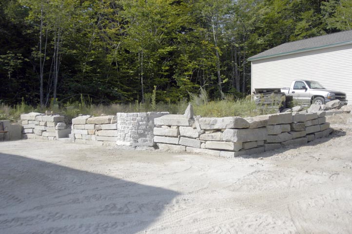

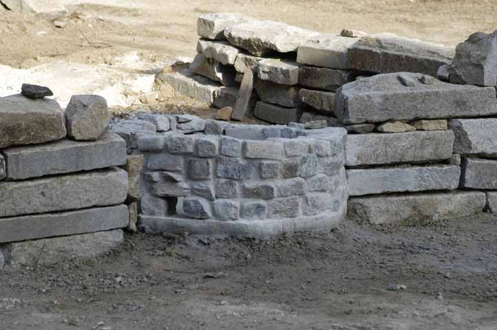

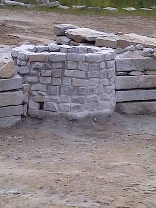

The slab is about 41/2 inches. It hasn't moved at all but I'm on ledge. You can't be to far away, you're welcome to check it out in person. Here are two more pictures of the wall. I plan on getting it done this summer.
