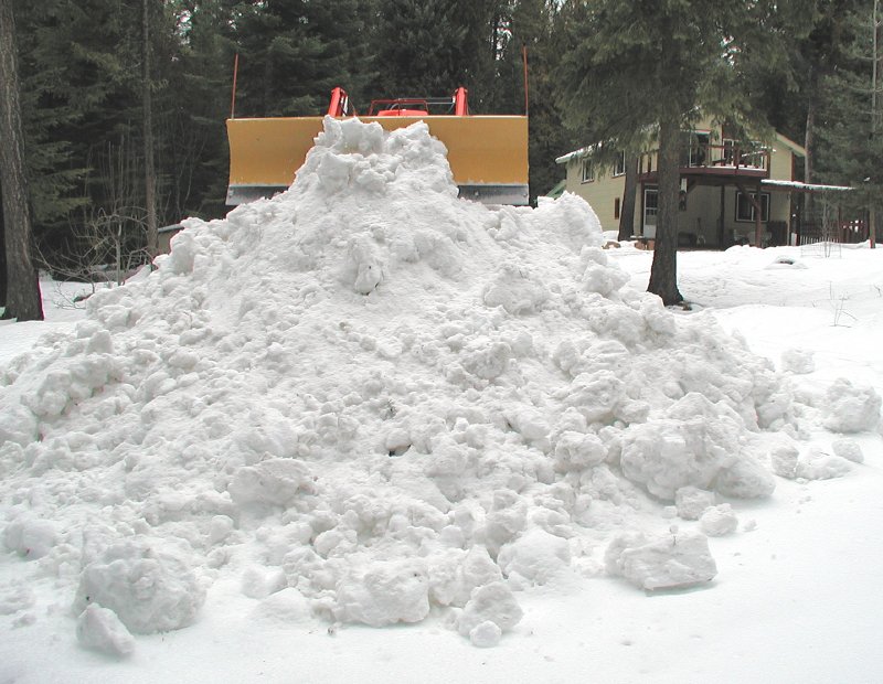

This is one way to pile alot of snow in a confined area. Not a new idea, this is done the same way as a rock stock pile. This pile can hold alot more snow, but this year is a light one so far. The tractor is a L4610 with a 7 foot curtis plow on the front and a 7 foot back blade. The cutting edge of the front blade is 9 feet above the ground. By building these stockpiles in strategic places, I never get "bermed in"

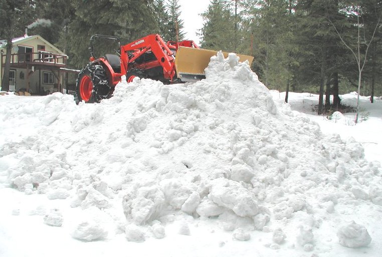

another view

Man ole man..I bet you could really make some snow banks w/that setup. /w3tcompact/icons/smile.gif
How time do you think your saving between the plow and the fel for snow removeal.

I think the blade or the bucket push snow nicely, but the front blade allows you to windrow the snow to either side if you want. It is a real pleasure not working in reverse. If I could only have a front blade OR a bucket, I'd choose the bucket. The rear blade does a fine job of side casting snow, but since I've had the Curtis on the front, I find the rear blade doesn't get used alot. Of course, come spring, the Curtis will sit idle until next winter, while the rear blade and front bucket will be working.
