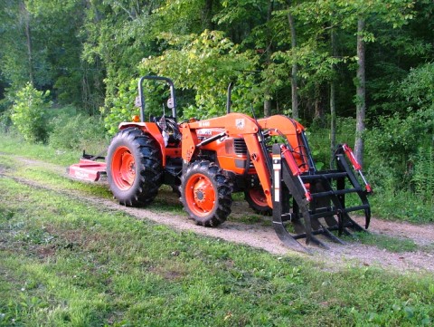

I have the worksaver grapple on my M6800. Bought it about a year ago. Has held up very well, solid Machine. Have used it for just about everything. From brush removal to picking up hay rolls. I think it was about $1800 to $2000. Would have to dig out the receipt.
Here is a pic
