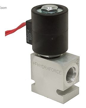

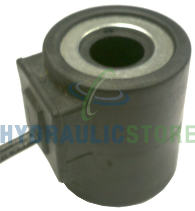

This is not a contactor. It is a solenoid-operated hydraulic valve. We are discussing replacing the coil, which can be easily replaced on the hydraulic valve;
The coil looks like this:
And goes on a solenoid valve...which IIRC looks considerably different than this:
That being said, the flyback diode might not be a bad idea, but probably isn't related to the fault that Woodland is troubleshooting.
