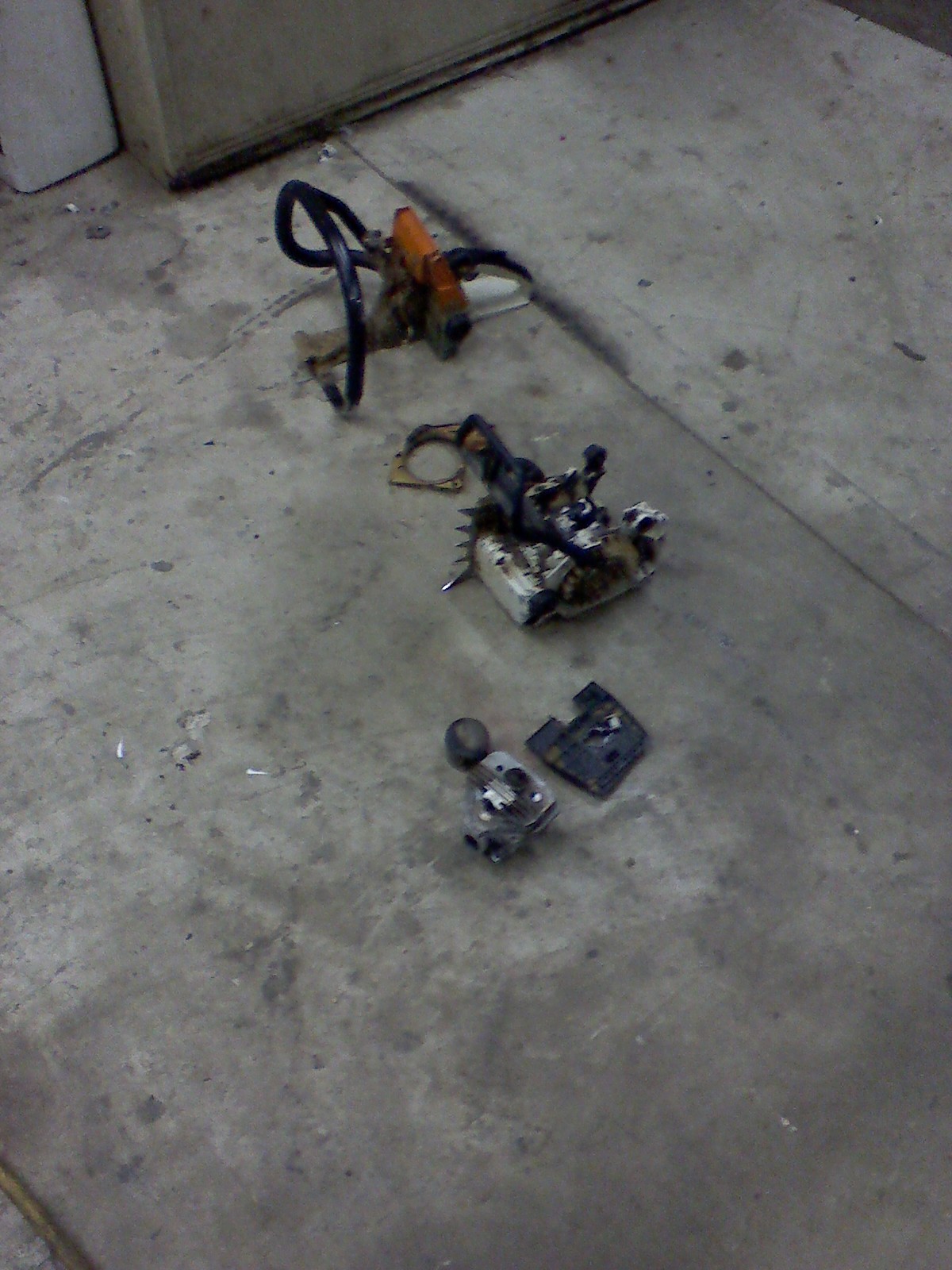

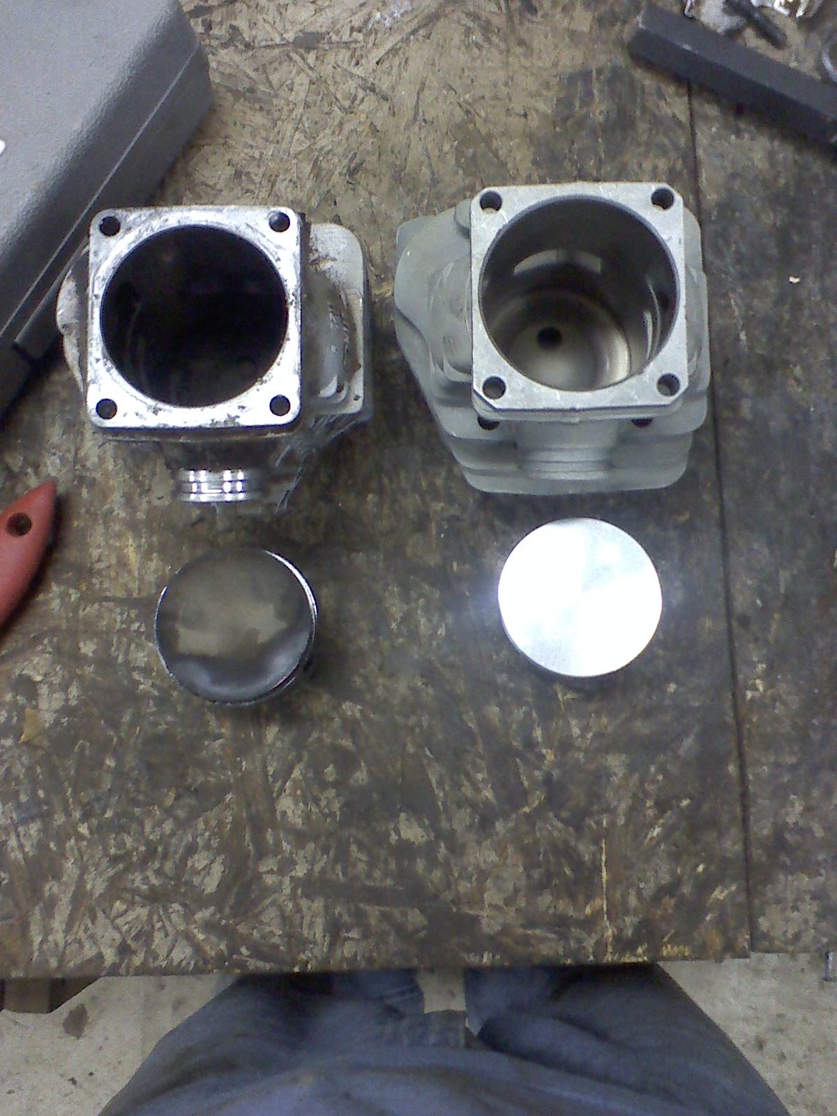

Just finished up the day completing a MS660 with BB build for a friend.
So I though I'd share some pics. This saw was a PAIN to get appart:mad: I snapped BOTH of my T27's off on two of the jug bolts:thumbsup: Ended up busting the fins off to get into there with an T-27 insert and a socket. Broke that too. Then tried to chisel around the head and walk it out. That worked on one of the two that were stuck, but not the other.
Ended up using the die grinder to grind the head off and then get in there with the channel-locks the free it up:confused2: About two wasted hours just tearing it down. Plus, taking the saw farther appart than needed just to get in there.
Anyway, heres some pics. These are the saw all appart, and then a comparison of the stock and BB jug/slug

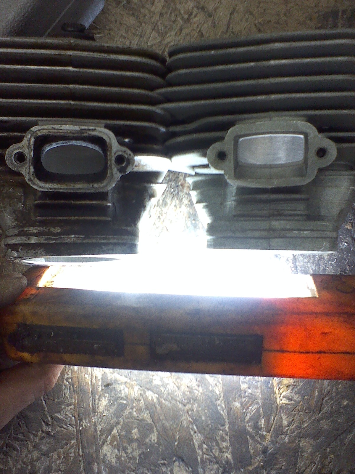

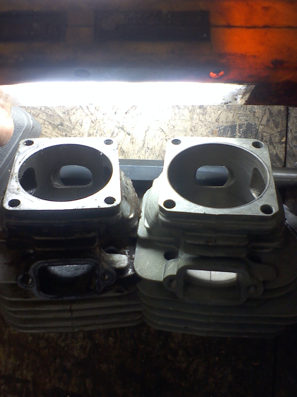

Exhaust and intake port comparison

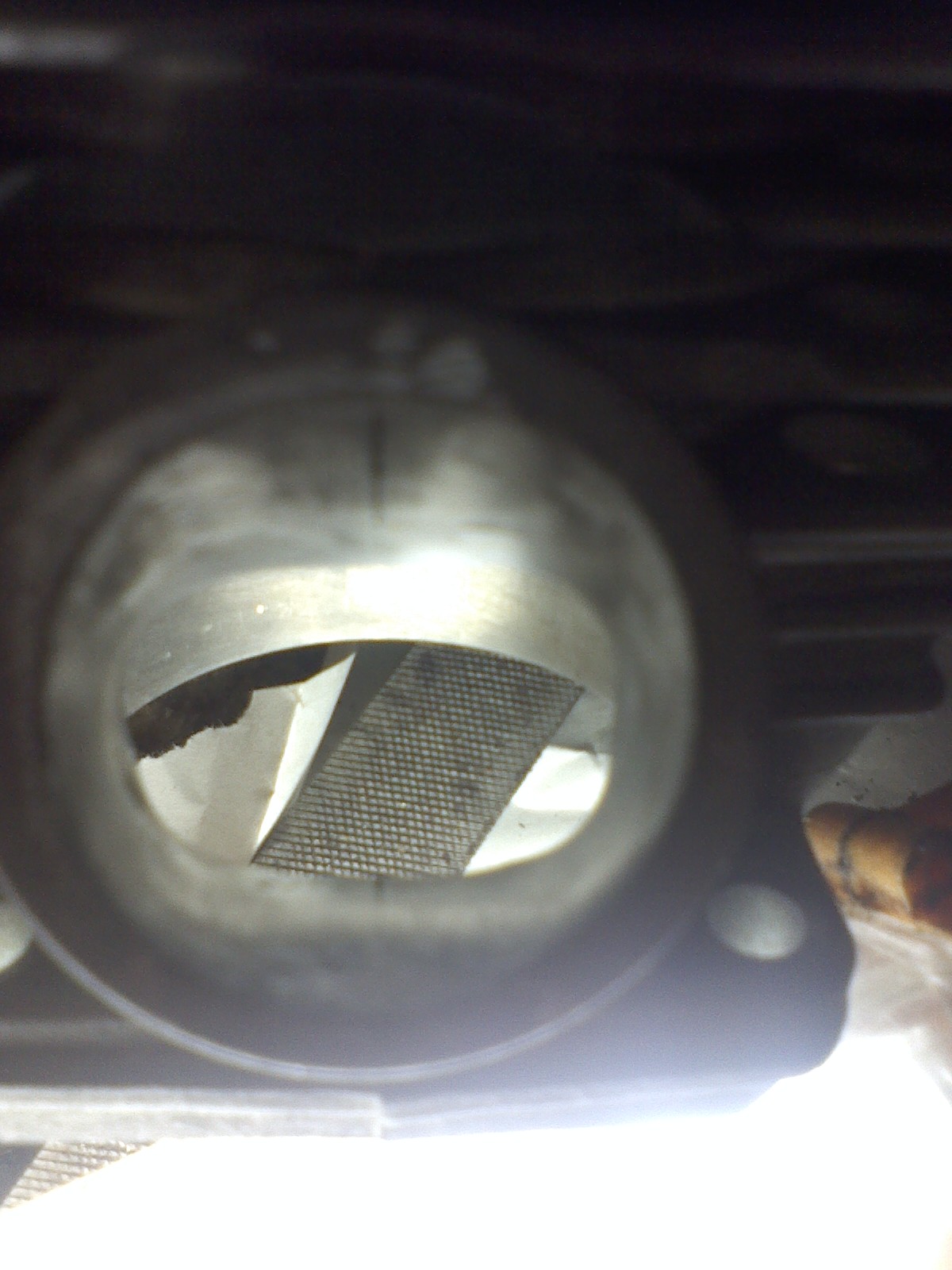

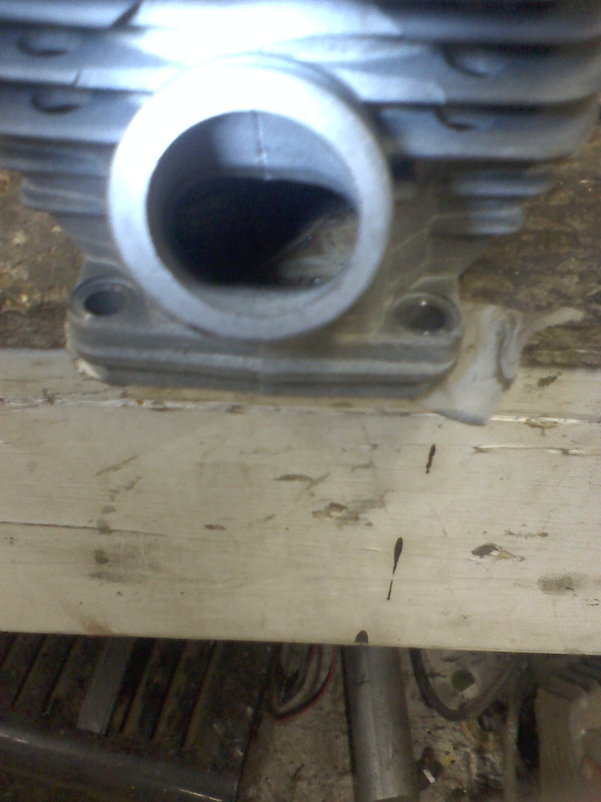

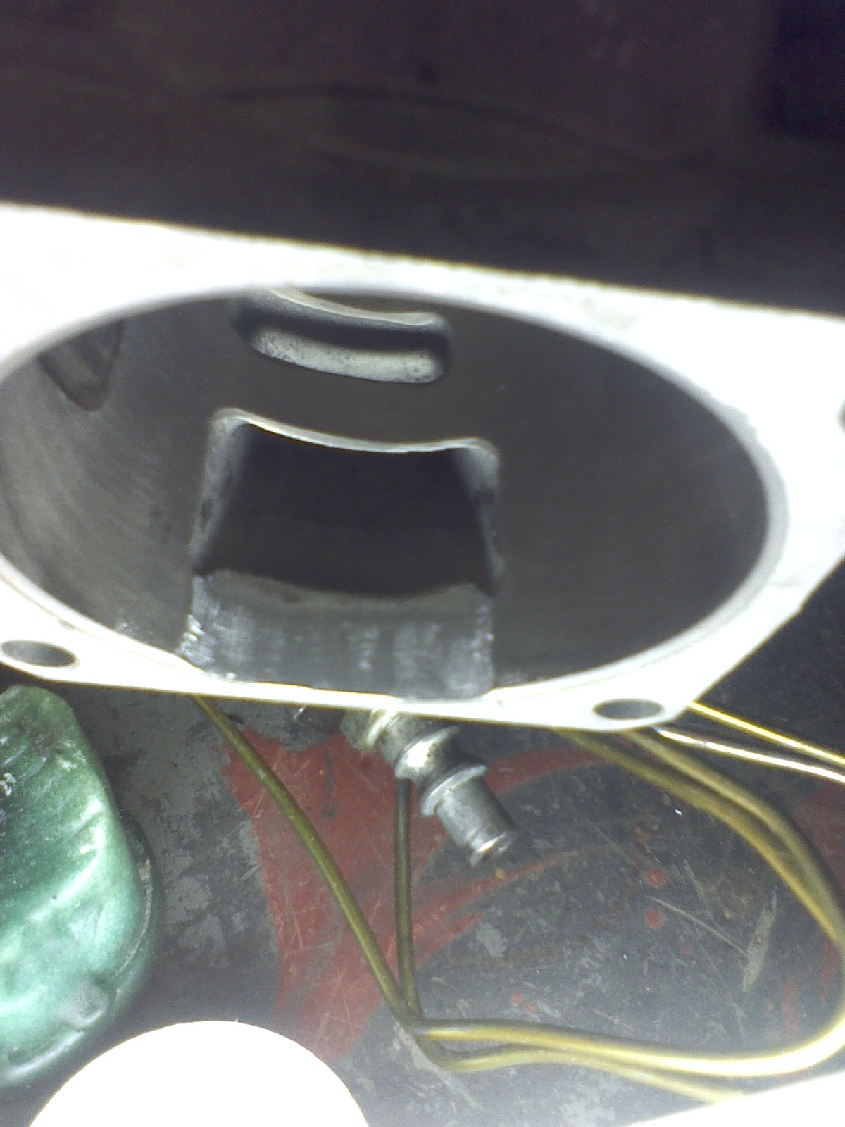

Marking and porting the intake on the NWP BB cylinder

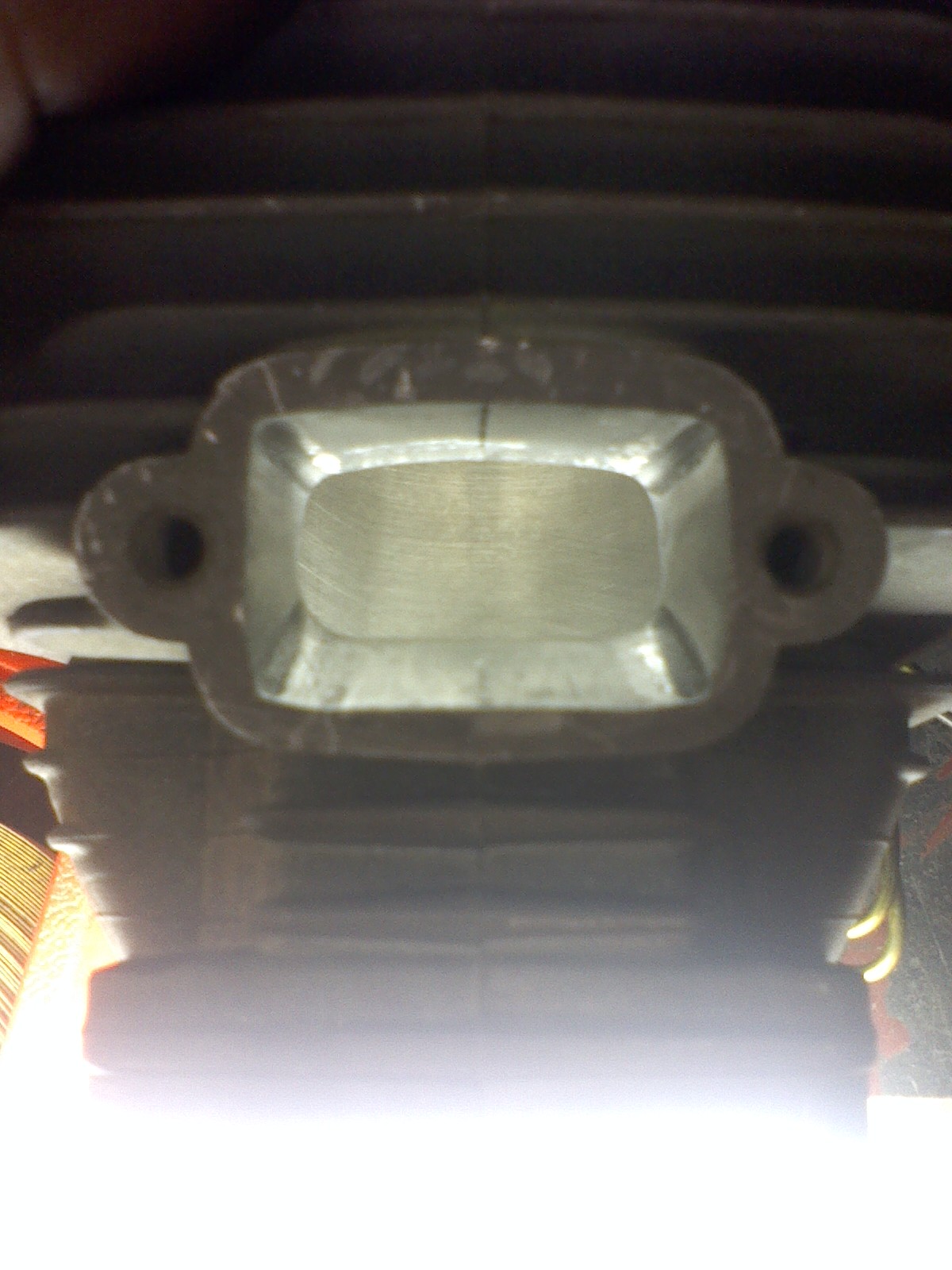

   / Stihl MS660: NWP BB port and build

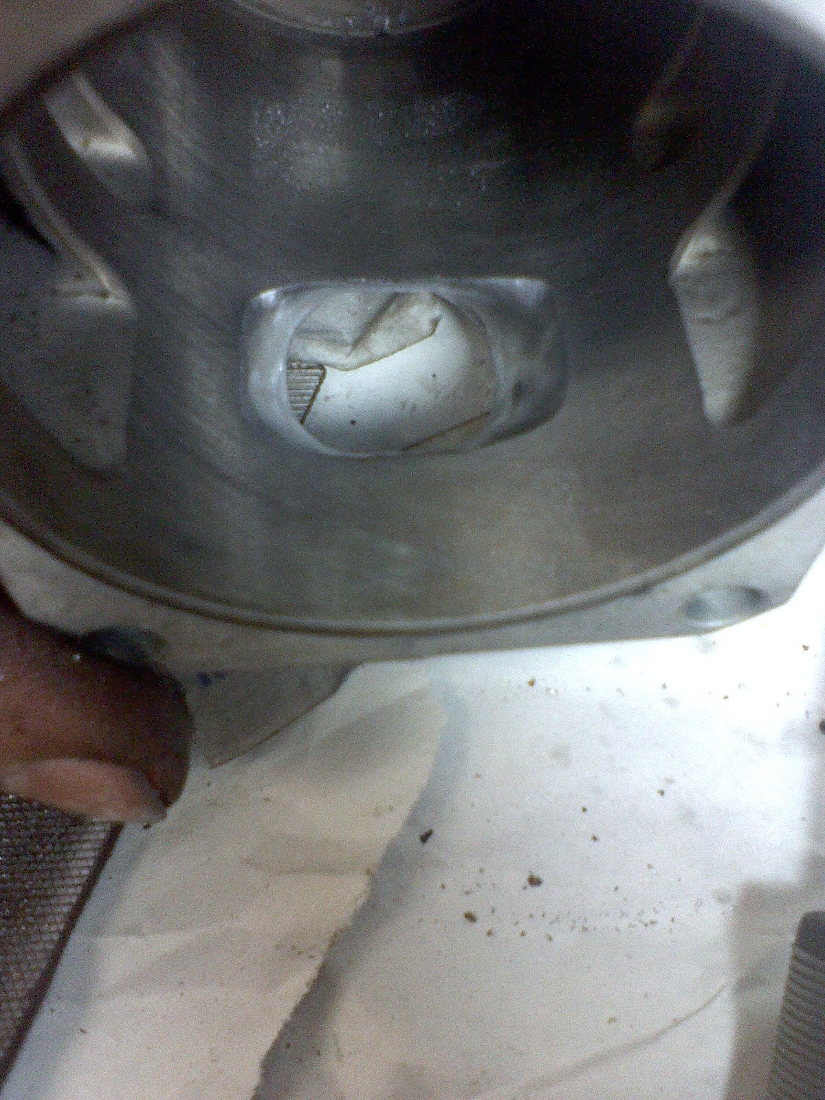

Sorry, I forgot to take a before pic of the exhaust port. But here's an after, and one of the lower transfers. I didnt do much with them because dont have a pencil grinder, but I did work them down a little farther ad blended them into the base a little better.

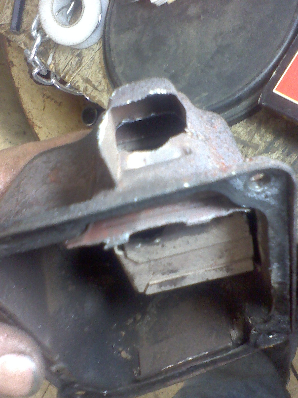

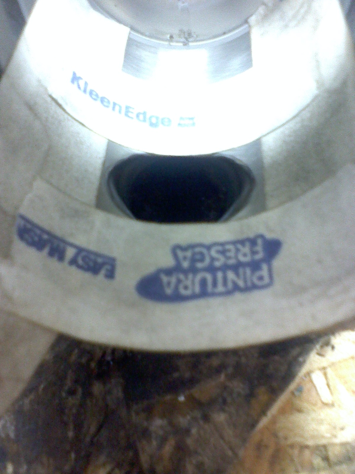

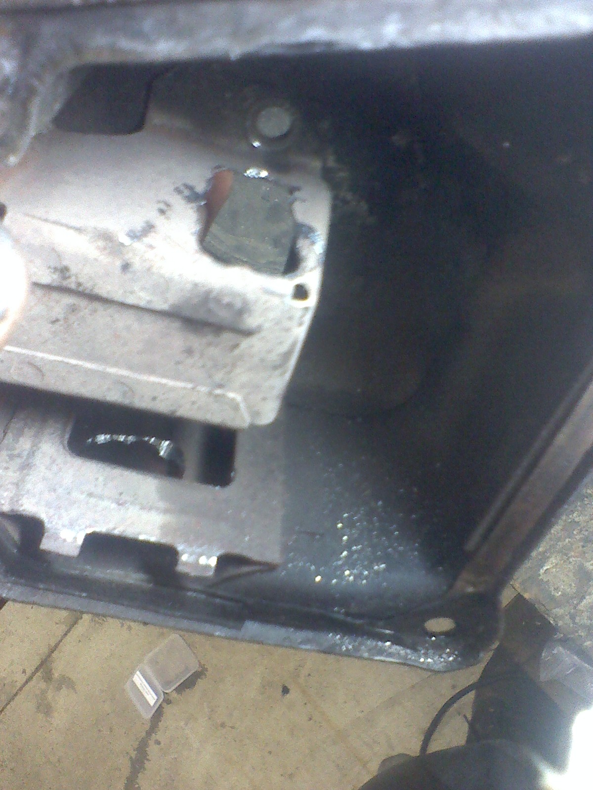

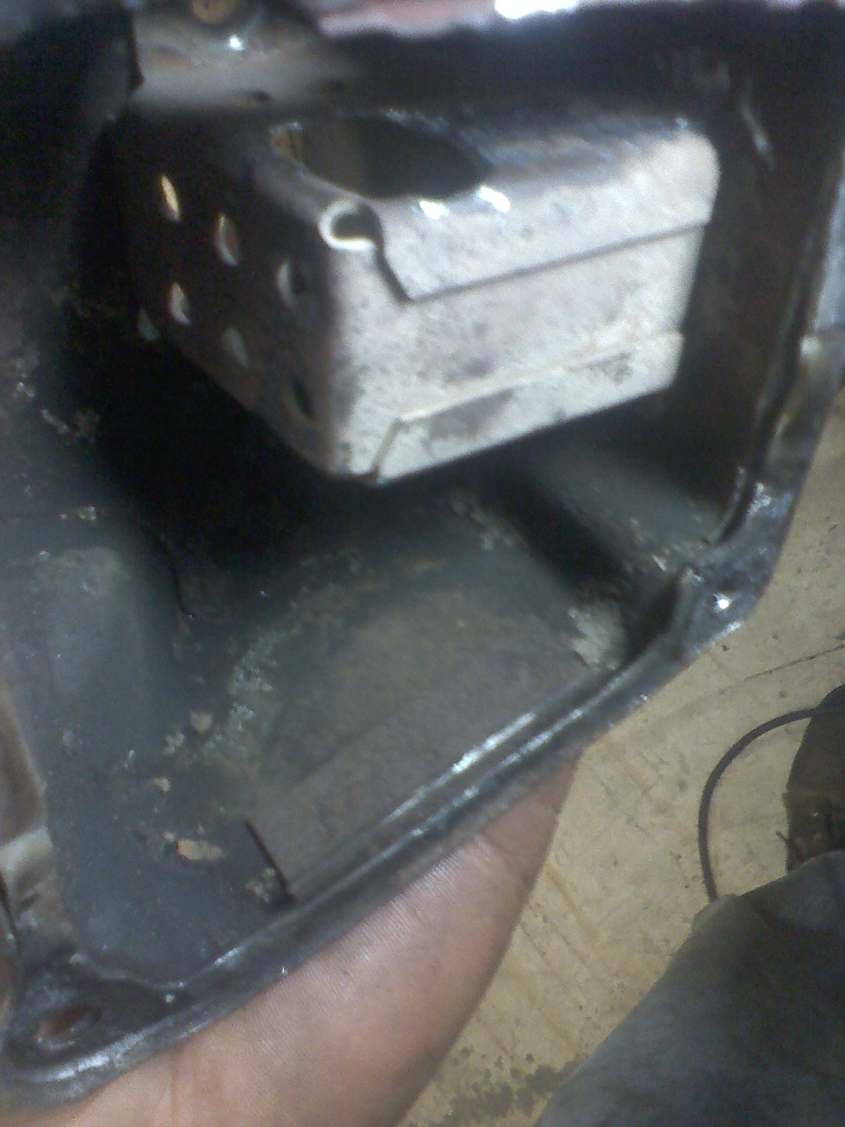

A little muffler work here.
I didnt remobe the barrel because it is spot welded in and too time consuming to remove and make right. So I just made some bigger holes in it.
And the little tiny 7/16" hole for the exit port is pathetic on a 98cc saw:confused2: So we had to take care of that a bit as well:thumbsup:

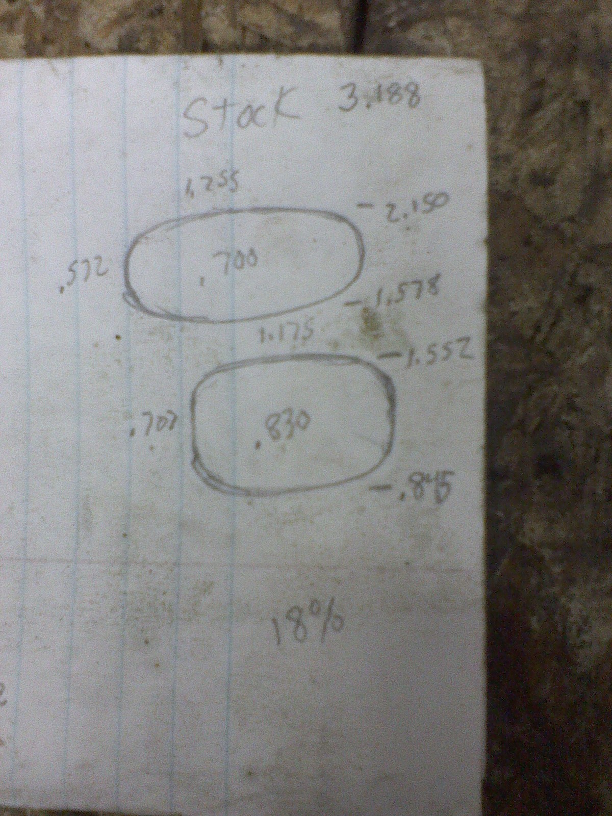

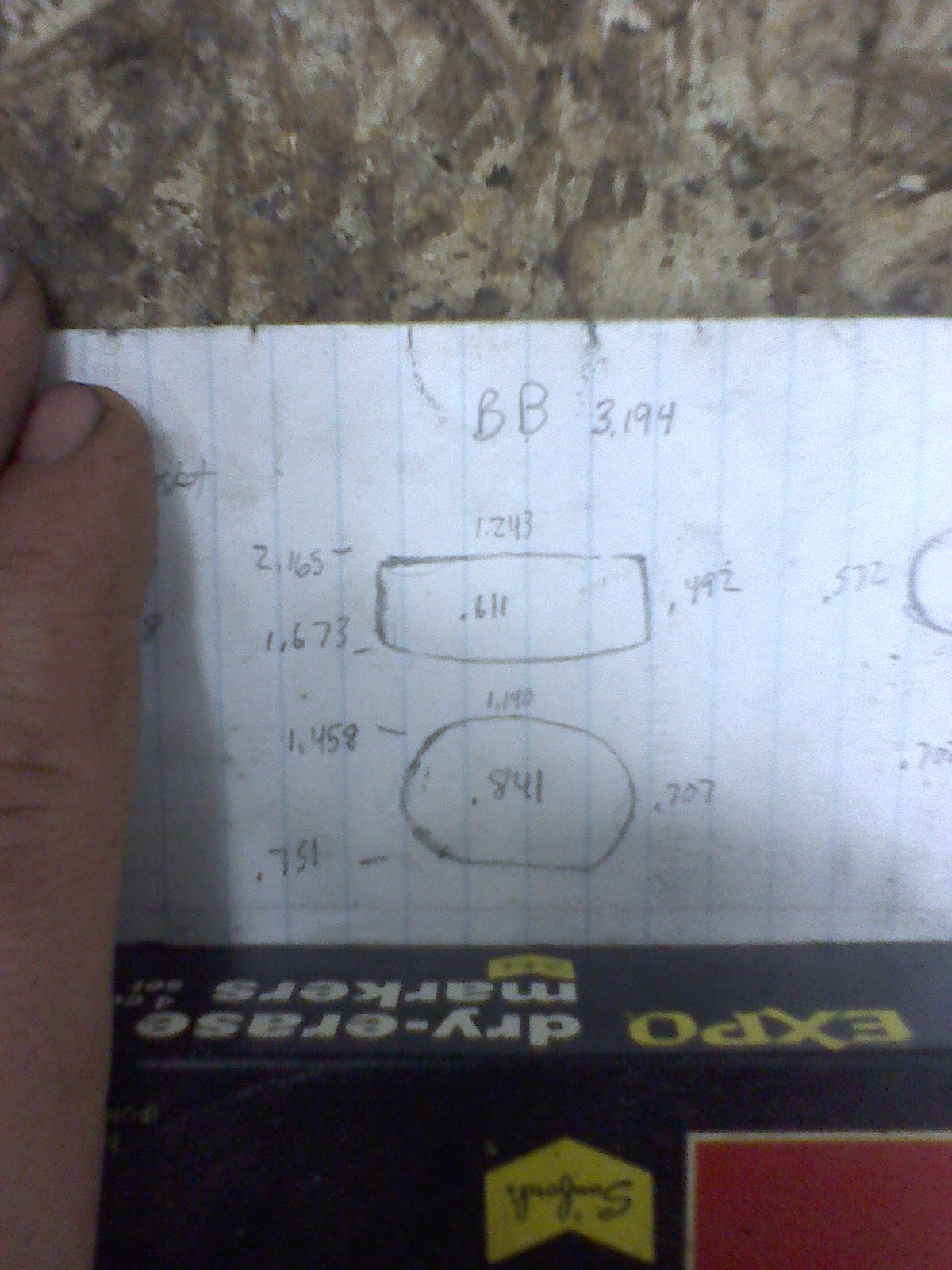

Since I was waiting on you to chime in, I'll post a little more technical detail of the build:thumbsup:
For starters, I measure port timing by measuring from the base to the opening of the ports. (again, no degree wheel) but I do have a depth guage:thumbsup:
In the following pictures, is a drawing of the ports. The first is stock, the second is stock BB, and the last is ported BB. The numbers to the side are the distance from the base of the jug to the port bottom and top. The other #'s outside the port are the width and height. The #'s inside are the squared area of the port (not counting for the rounded sides. Just H x W)
As you know:D The top of the exhaust port, and the bottom of the intake are the only two that really matter. They determine the timing and duration. The bottom of the exhause only has to have enough to NOT free-port (expose the crankcase). And the upper of the intake only has to have enough to not expose the comustion chamber:thumbsup:
So comparing the exhaust upper and intake lower of the stock vs BB, we have the exhaust pretty much spot on. Within .015. Which got extended another .010 from polishing. But look at the intake. The BB kit is almost a full 1/10 of an inch lower. Which means the intake opens sooner and stays open longer:confused2: And I was also disappointed that the exhaust port was considerabally smaller:mad:
So basically what I did, was take the top of the intake up to about where the stock one was. (again, no effect on timing, just increasing volume:thumbsup:) and the same with the exhaust port floor. And then widened them out to leave about .070 of piston skirt to seal the port.
And the end results you can see:thumbsup: The intake is now about .130" taller and the exhaust is ~ .100.
That last pic is percent difference of the finished job vs BB and stock. The eshaust is 11% bigger than stock and 27% bigger than the BB, and the intake is 20% bigger than stock and 18% bigger than the BB:thumbsup:
Also, in the first 3 pics, the % at the bottom is how much smaller the exhaust is vs the intake. Stock, the exhaust was only 18% smaller. BB was 27%(I covered that up) and finished is 28%. Also, the number at the top is the total height of the cylinder from base to squish band. Stock was 3.188 and BB was 3.194. I would have rather seen it at 3.188, because that would have gave me ~.022 squish, but o-well.
