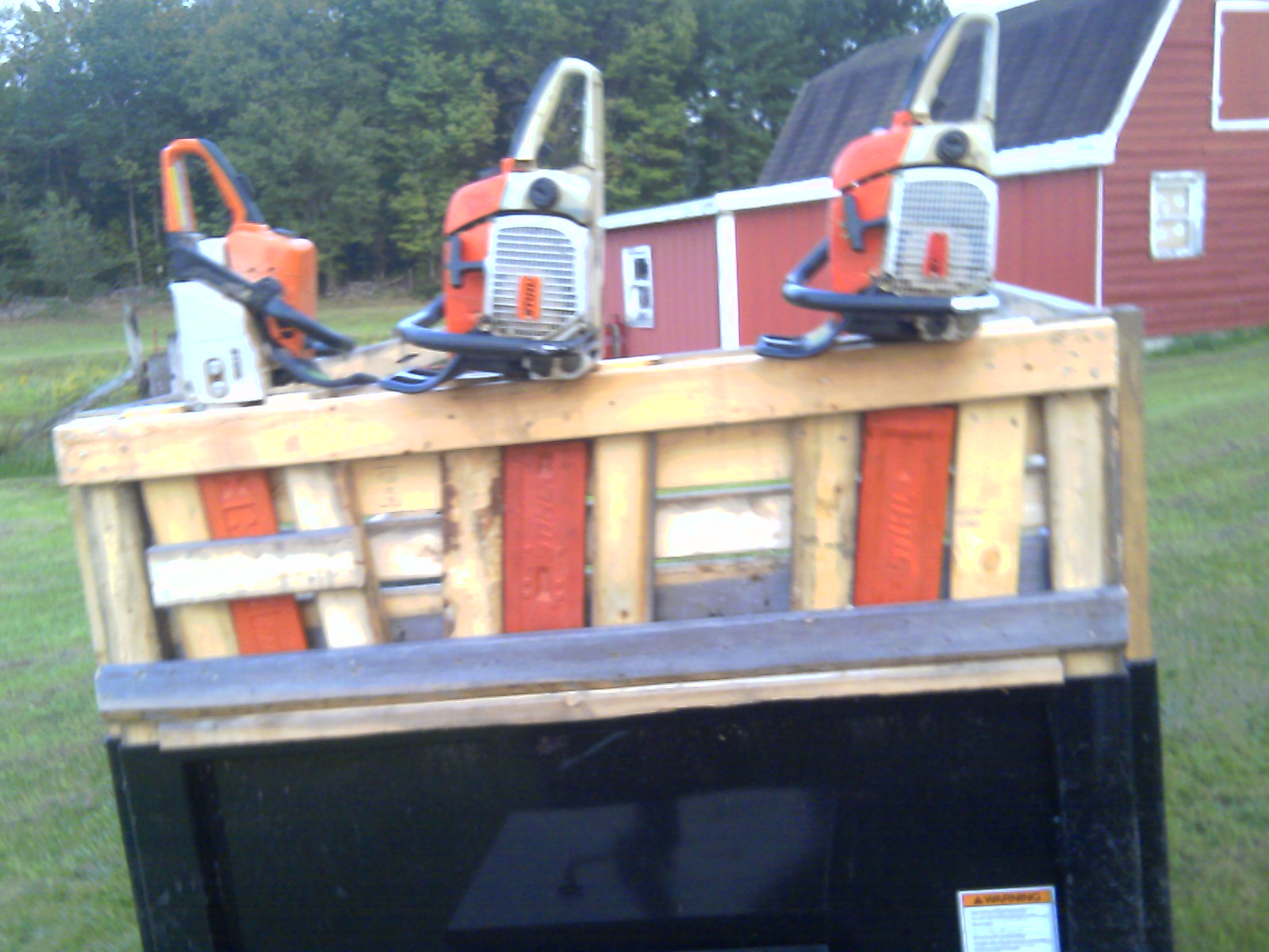

I own 3 Stihl Saws, my uncle has 3 husky's. I like mine and have nothing bad to say for the use they have had. The 2 big saws have well over 10,000 cord under their belts with almost no down time. One of the saws ate a gear in the oiler. About 8 bucks and it was fixed.
The Husky seems to have a little faster chain speed, which to me means you cut into the rock a little faster and ruin a chain a bit quicker. Their a good saw, It's the Ford vs Chevy trick. What ever you get it will be good . . . John
