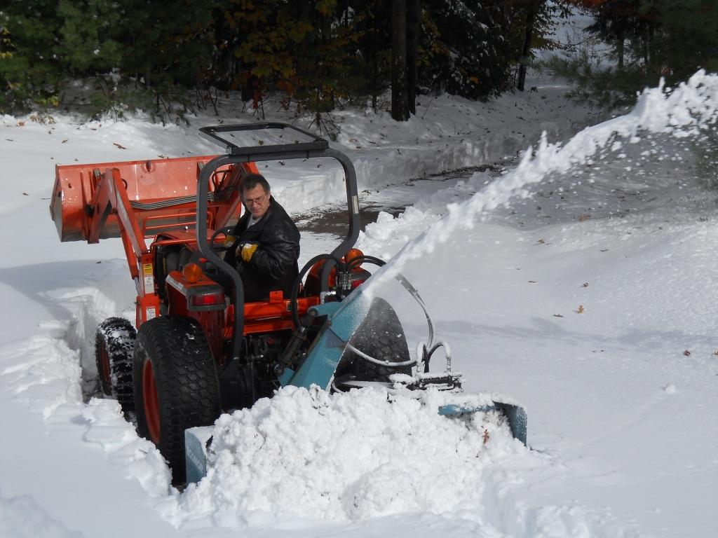

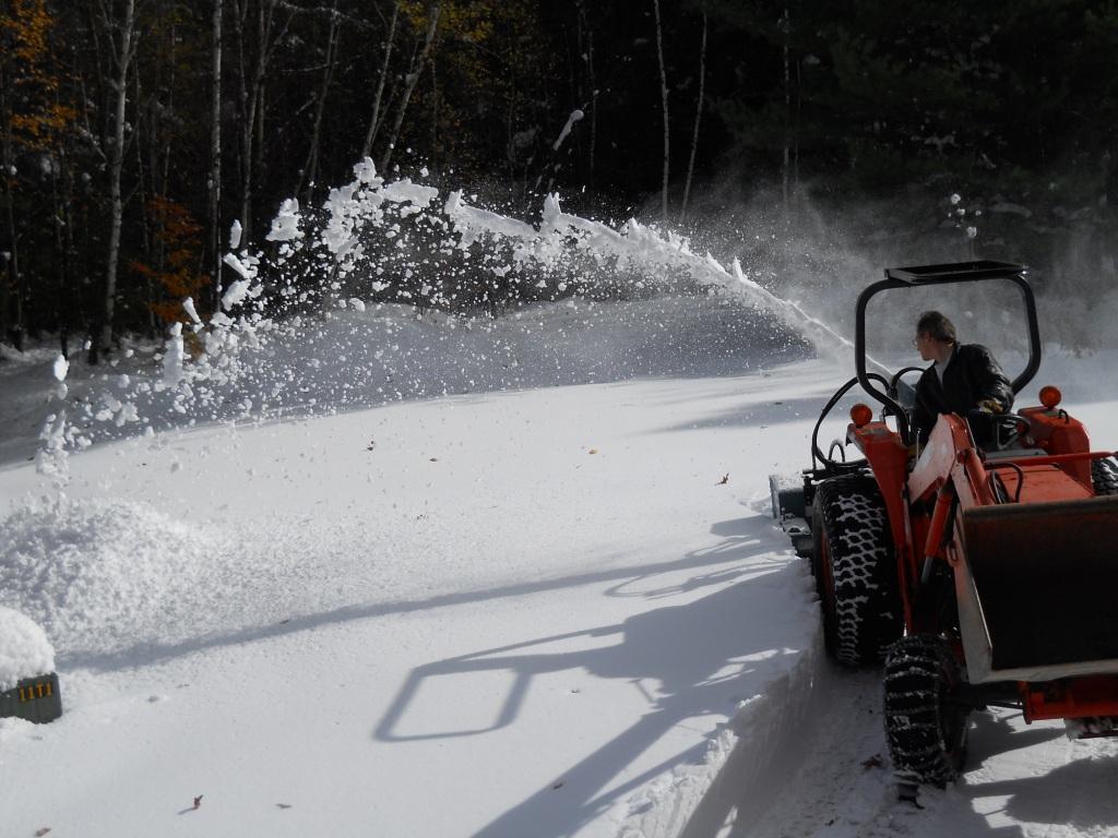

You're running your machine too slow. Once the snow gets flying, it will run OK. I had to chew through over 2 feet of cement up in NH this weekend (pics below). Don't feel bad - I did the same thing that you did - it took me a half hour just to get out of my barn - didn't even get 2 feet and the blower was packed up solid. Twice. I did the same thing first try last year too, which was the first time I used the blower. I quickly learned that I was being too tender with the throttle. You need to tach it up to full blast - beyond PTO speed if the throttle will let you - then ease into the snow. Once the snow starts flying out of the chute, it isn't hard to keep it moving. Keep the tractor pinned to the boards and go for it - do NOT try to drop the RPMs while you are moving. If you want to cut the throttle to change direction or whatever, give your blower a few seconds to clear itself or it will pack up and turn into a 600 pound brick. I broke 3 shear pins so far - all of them because I chopped the throttle without letting the blower clear itself.
You can spray down the chute, but it is really a waste of time. Whatever you put on there will be gone in a few minutes. It might help you get started though - soak everything down with WD40 - good as anything else. Don't worry about any chute or impeller rust. It will go away soon enough - snow is pretty abrasive.
Don't give up - blowers are awesome and you are going to be ecstatic with yours once you get the hang of it. I'm convinced that mine could eat a car. Besides, clearing snow with an FEL has to be the worst way there is to do it. I'd almost rather do it by hand - I think it'd be faster.
