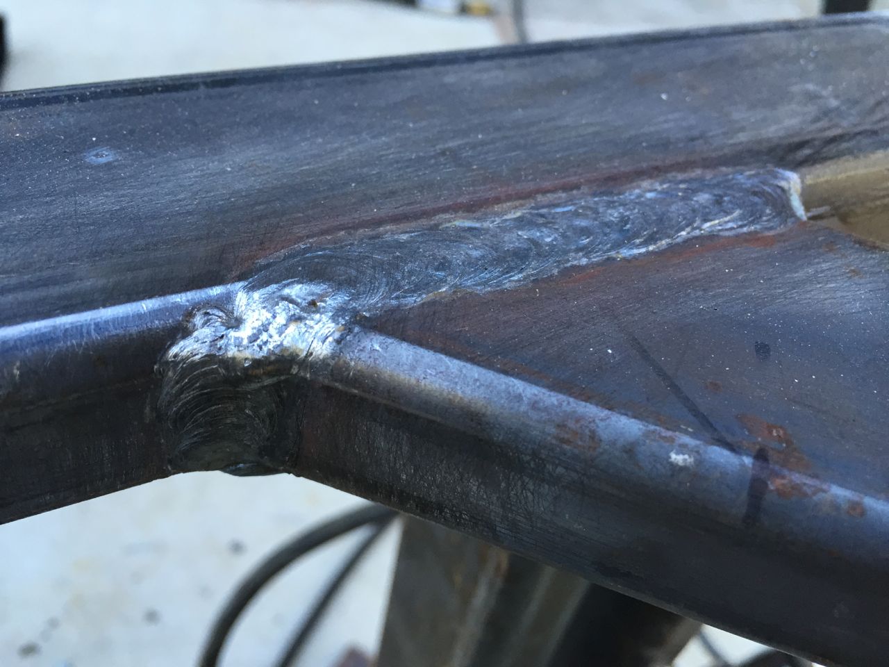

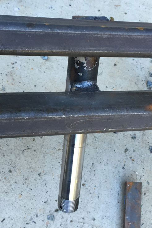

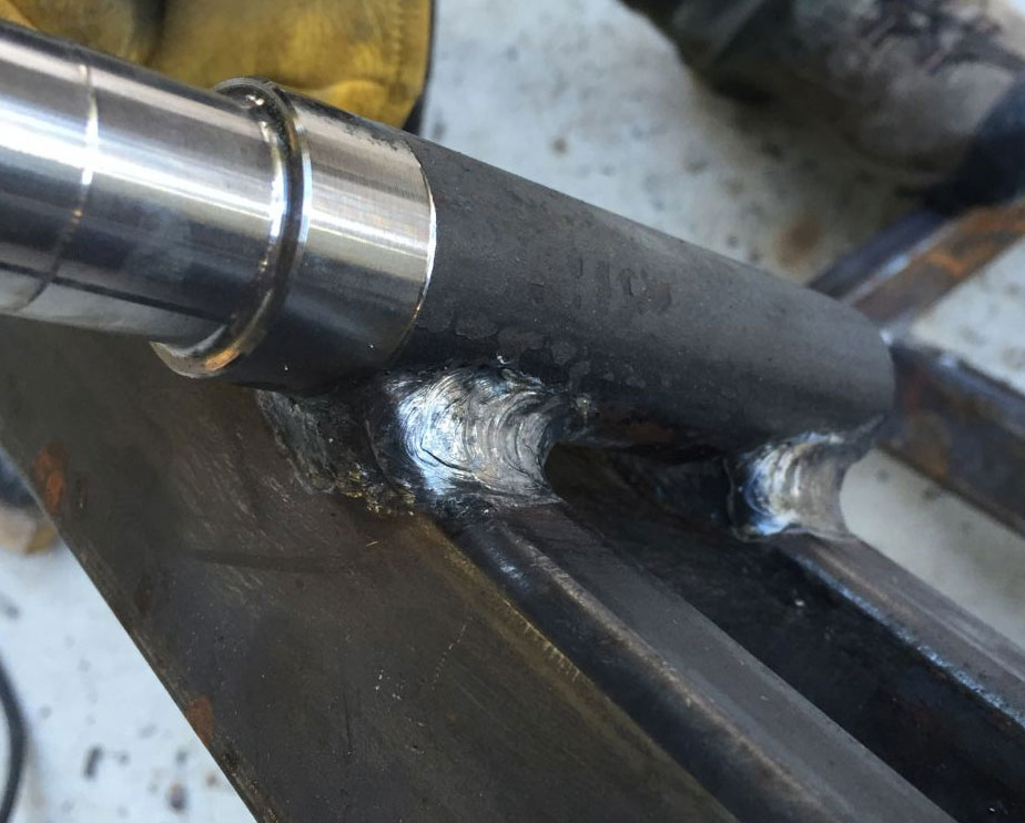

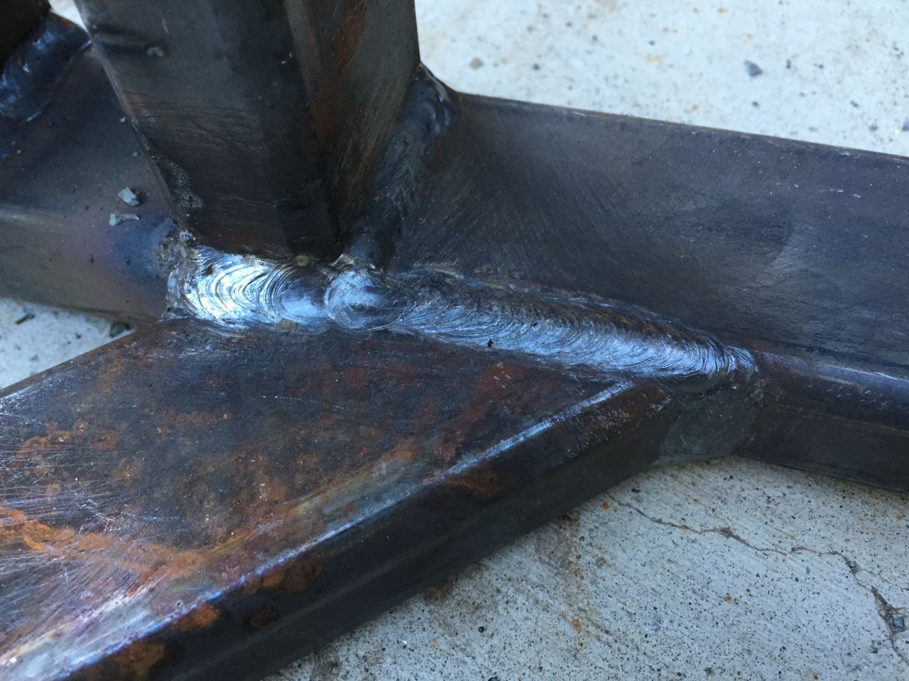

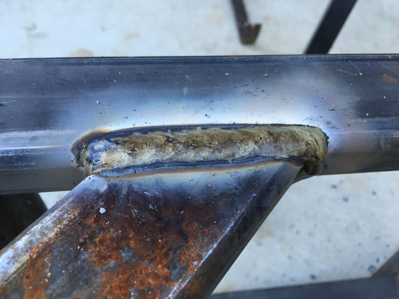

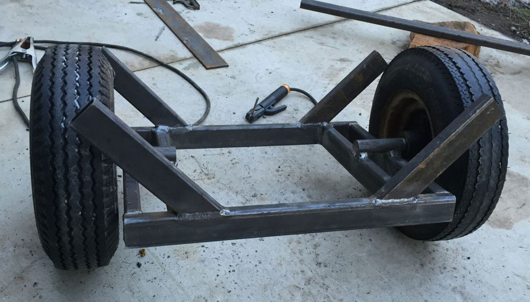

Yesterday I ran out of MIG wire, mid-project, and was really bummed. Getting more wire would take at least 3 hours, and I did NOT want to get in the truck for 3 hours, or pay $60 for what I can get on Amazon for $30. Went in for the night, and in the morning, remembered I had some 7018 rods stashed away (for a project that I thought required stick). After a little trouble getting plugged into the 220v receptacle on the generator I fired up the stick portion of my Miller MultiMatic 200. Was suprised how enjoyable it was to blast that big ole' rod onto the work. And that welding was like riding a bicycle. Other than one time, and one rod, a year ago, the last time I stick welded (more than one rod) was in 1979, 36 years ago.
And then the other part I enjoyed was every weld is like Christmas. What're you gonna get when you take off the wrapping? And the colors, and the shine. Trying to chip it off without denting the weld. It was thoroughly satisfying day. I can see why you guys like your stick welders, even those with a MIG.
I weld a lot with .065 tubing though which (as I recall) is not as much fun with stick. Also the tacking part with stick reminded me how nice a MIG is, how much faster you can work. It is possible, however that I might be wrong and .065 is fun too with a stick.
The project is a small log dolly over in "Build it yourself".
I used 1/8" 7018 rod, 90v, 100A, DC. I'm going to stock up on rod, am I using the right rod for DC? What else should I get?
Here's some pics.

That's purty! :)
I like my MIG for tacking stuff up and I like my stick for sticking it. And you are right about chipping off the slag to see how well you did... just like Christmas, or as is many times in my case, April Fools Day! :laughing:

Very nice looking welds! There is something satisfying about burning rods though I just can't put my finger on it. Although, I do need to get some sort of exhaust fan installed because I definitely had a cloud going in the garage on my last project!

Nice looking welds.
I use a $30 pneumatic needle scaler from Harbor Freight to clean up my stick welds. Less damage to the weld compared to hammering the scale off.
