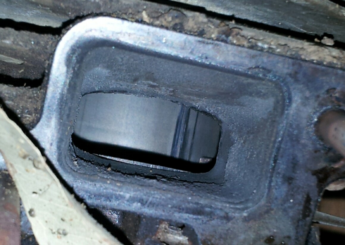

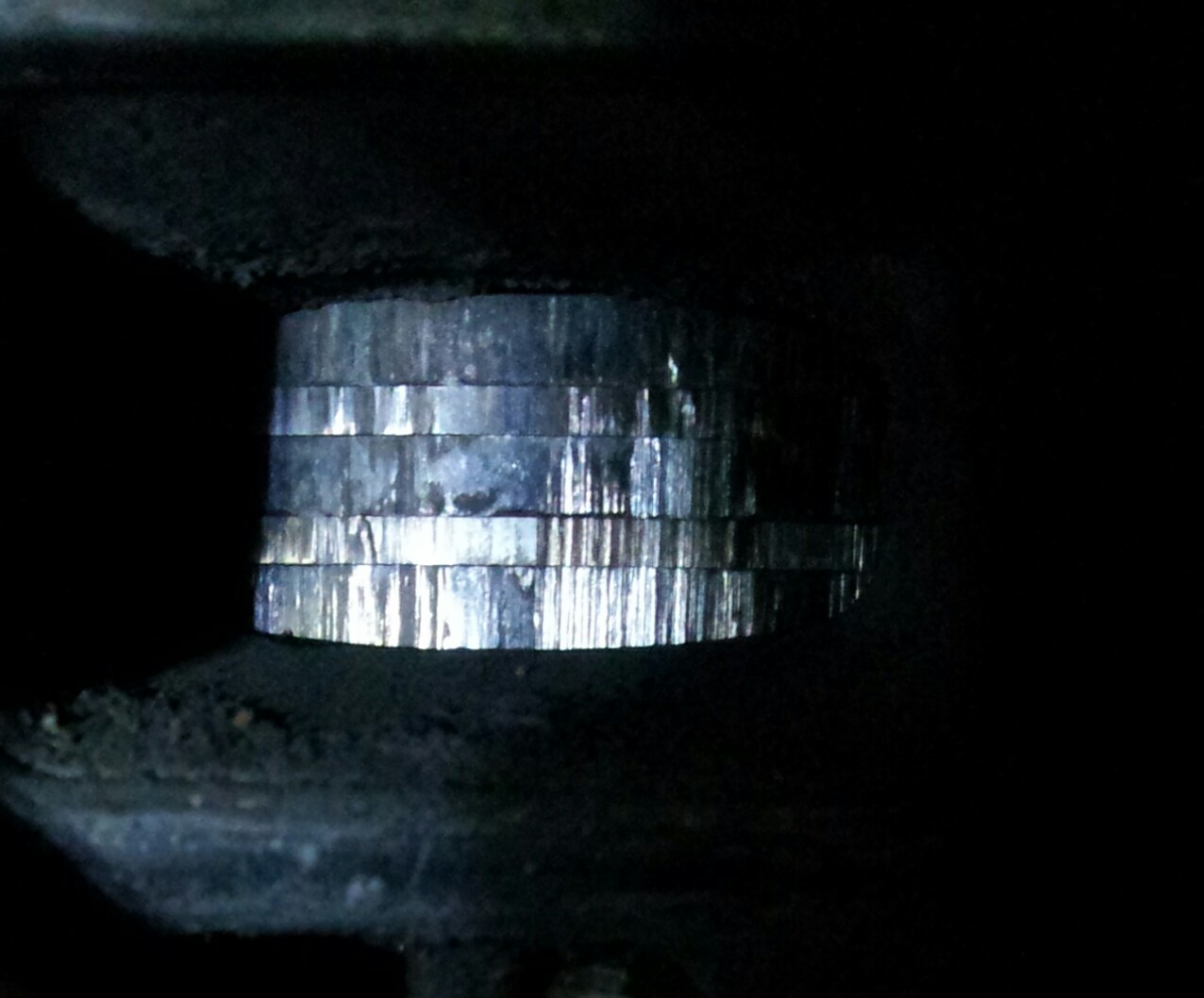

Tear it down and see what the cylinder looks like. You may be able to clean the cylinder up and put a new piston in it. If the cylinder won't clean up I would look for a good used Stihl 039/ MS390 top end for it.

Also, being a pro saw, it can be rebuilt if need be much faster and more easily
than a clam-shell 290.
True, pro saws are easier to work on, generally. It is hard to imagine, but hard-core loggers have been known
to change pistons/jugs in the field.
I am in the midst of a few Husky refurbs, and I just had my first cylinder rejection. It is a FarmerTec Chinese
unit for a Husky 371, and it is a bit too rough for me. Others have been fine. This is a big-bore kit to
upgrade to 75cc, and I plan to modify the ports a bit, as well as increase compression. I should have the
new one from China in a week or so. For this saw, I can remove the cylinder in about 10min, mostly cuz
you do not have to remove the handle/tank assembly first.
On cheaper saws, the jug bolts are often accessed from the bottom, not the top.
