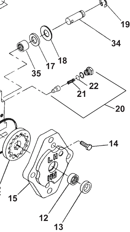

I have a Steiner 230, diesel with the Sundstrand series 15, u type transmission. The problem I am having is the unit moves forward and backwards fine, with a lot of power, but I have no power steering or implements (no lift on the deck, no hydraulic weight transfer and nothing at the aux ports). From what I致e read it points to the charge pump, but the pump motor relies on the charge pump to feed it oil (and as I said the machine moves great with good power). I have tried to check the pressures at the different ports and most are very low the only one that has approx 200psi is the one on top closest to the check valves. If anyone has any ideas or things I could try to get this up and running without just buying parts and trial and error it would be very much appreciated. If you need more infomation, I have plenty, lol ?Rob
   / Steiner 230, no implements/powersteering #2
There's a chance your charge pump regulator spring is broken or weak, or the valve is hung up, but it's not likely. You may have a blown o ring in the pump, a ,60 cent part, or the pump and motor may just need to be resurfaced. If you tackle any in the system you will need access to a high pressure 10 micron filter and hoses to adapt to your existing fittings..this setup costs about 150-300 to make depending on what's a available at the time on ebay...and what you have laying around. ...
   / Steiner 230, no implements/powersteering #3

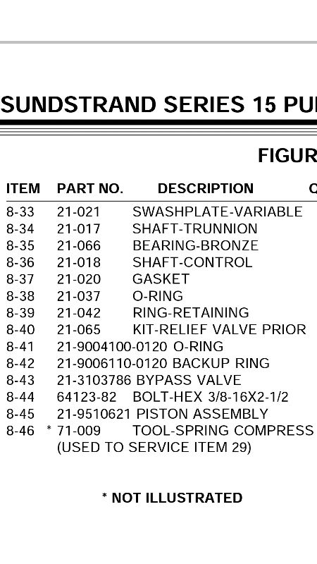

Here are some illustrations for the 420/430 pump, I'm about 99 percent sure the 230 pump is identical. .the small o rings, numbers 38, failed in my 420, and it creates a massive internal leak that uses all the charge pumps capacity, leaving nothing left for the steering and lift...i believe you'll likely find one or both blown out.i recommend you use oem o rings, and parts for the pump..i don't know how difficult access is on the 230, but on a 430 I could remove the backplate of the pump without removing the entire pump, resurface everything replace o rings and reassemble,in about an hr and a half to 2 hrs, then loop filter it , and you should be good to go..first I would check the charge pump regulator spring and valve although they rarely are the problem. .

You only need access to the back plate..if you can get it off your golden..on the 420 it's below the steering wheel and easy to access by removing a simple 4 bolt guard..just both hoses and 4 bolts and it's off..i know the 230 has an entirely different setup.You must have a massive high pressure leak that's why I say an o ring..unless the charge pump is trashed, it can't have a snapped charge pump sheer pin because you'd have nothing at all..
Hi Raw,
I was able to look over your schematics more now that I am home from work... it looks like the 420/430 pump is totally different then the 230's u-type... but you have me in the mood to tear it down, so I am going to get into it first thing tomorrow and see if I can locate any issues inside. I was going to load a pic from a Sundstrand manual I got online but for some reason its telling me I have an incorrect extension on the file.
