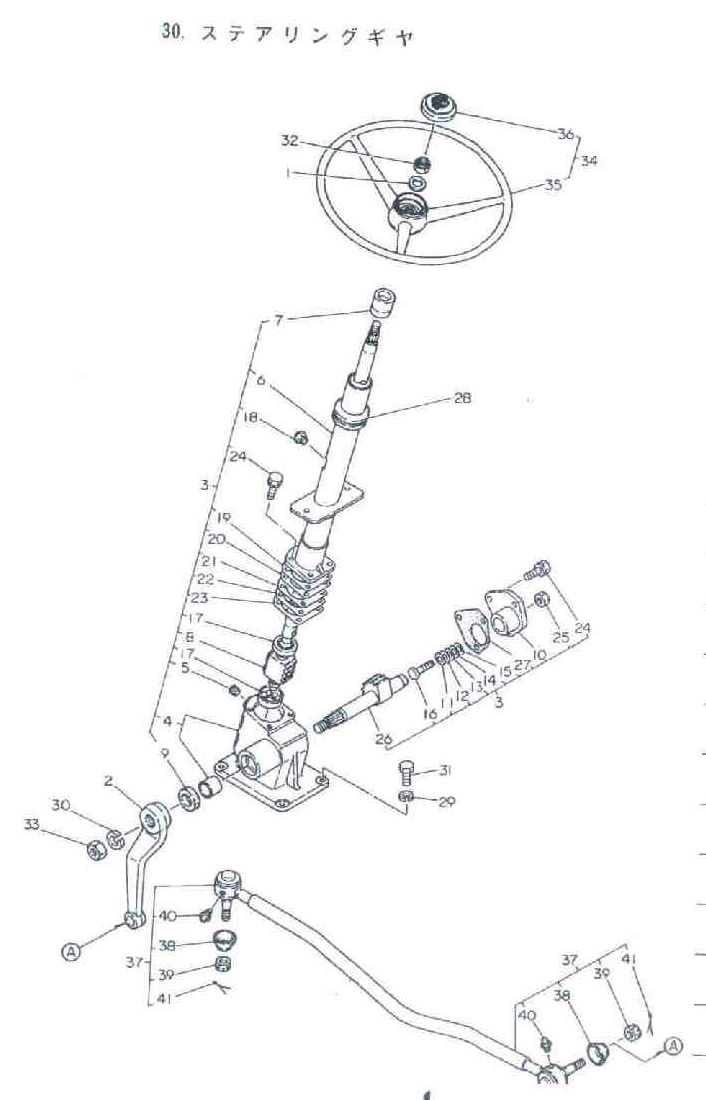

Please help. I am new to yanmar and just bought a YM1301D tractor that I found on Ebay a couple of weeks ago. When I got ot home and started playing with it, it was hard to steer in reverse but I could do it. It would steer in forward easier. Well today it binded and would not steer at all. I took it apart and found that both upper and lower bearings, screw, screw block, and all the little balls were chewed up. I do not have any manuals and am having a hard time finding parts for it. Can anyone help. Thank You, Bryan. /forums/images/graemlins/frown.gif

I have the bearings for your YM1301D steering box on order, but I don't know how long it will be before I get them. The nut ball assy is not available from Yanmar USA, but it may be available in Japan ( not cheap ) I would try to find a dealer that has a YM1301 parts tractor and buy one off it. I don't have a YM1301 at this time. I have parts manuals for the YM1301D if that will help you.

   / Steering woes on a 1301d #4
Brian,
In the mean time, if you need a specific part of the parts manual, I have a complete copy. I'd be happy to scan a few pages and e-mail or post them. I have a YM1301D and it is a very solid machine - I absolutely love it. I have attached a diagram of the steering box and linkage from the manual.

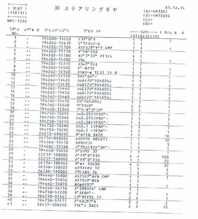

   / Steering woes on a 1301d #5
Brian,
Here is the parts list to go with the drawing in the post above.
I hope this helps you.
