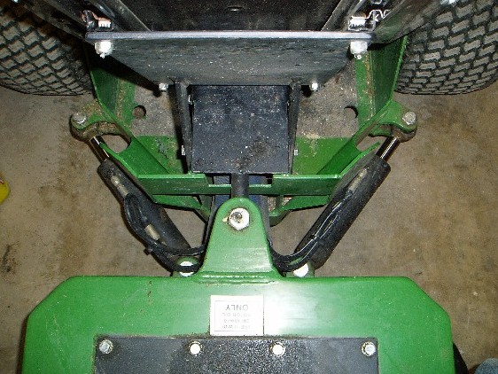

Here is a pic of my 422's stearing cylinders. It was bought new in January of 2003.
   / Steering Cylinders #6
maybe here. i'll try again

Thanks for posting the picture. That answers my question. Now if I could get someone who owns a PT180 to post a picture showing the same overhead view..( for comparison) I think that would take away any negitive feelings I have about the 180's steering set up.

As for one steering ram VS two... just take the picture of the overhead shot of the two steering rams and cross one out of the picture. I believe it is set up the exact same way, although I do not know which side is missing. /forums/images/graemlins/wink.gif

My main reason for wanting to see the same shot of a 180 is to see if PT put mounting brackets on both sides. So down the road if I wanted to mount a second steering piston/cylinder , the brackets are there to do so. Hopefully a
PT180 owner will chime in and answer that for me.

FYI...the steering cylinder is on the left of the newer 422's. I was suprised to see only 1 but thus far have not had any problems navigating around with a load on(that didn't come out right LOL!) /forums/images/graemlins/grin.gif
