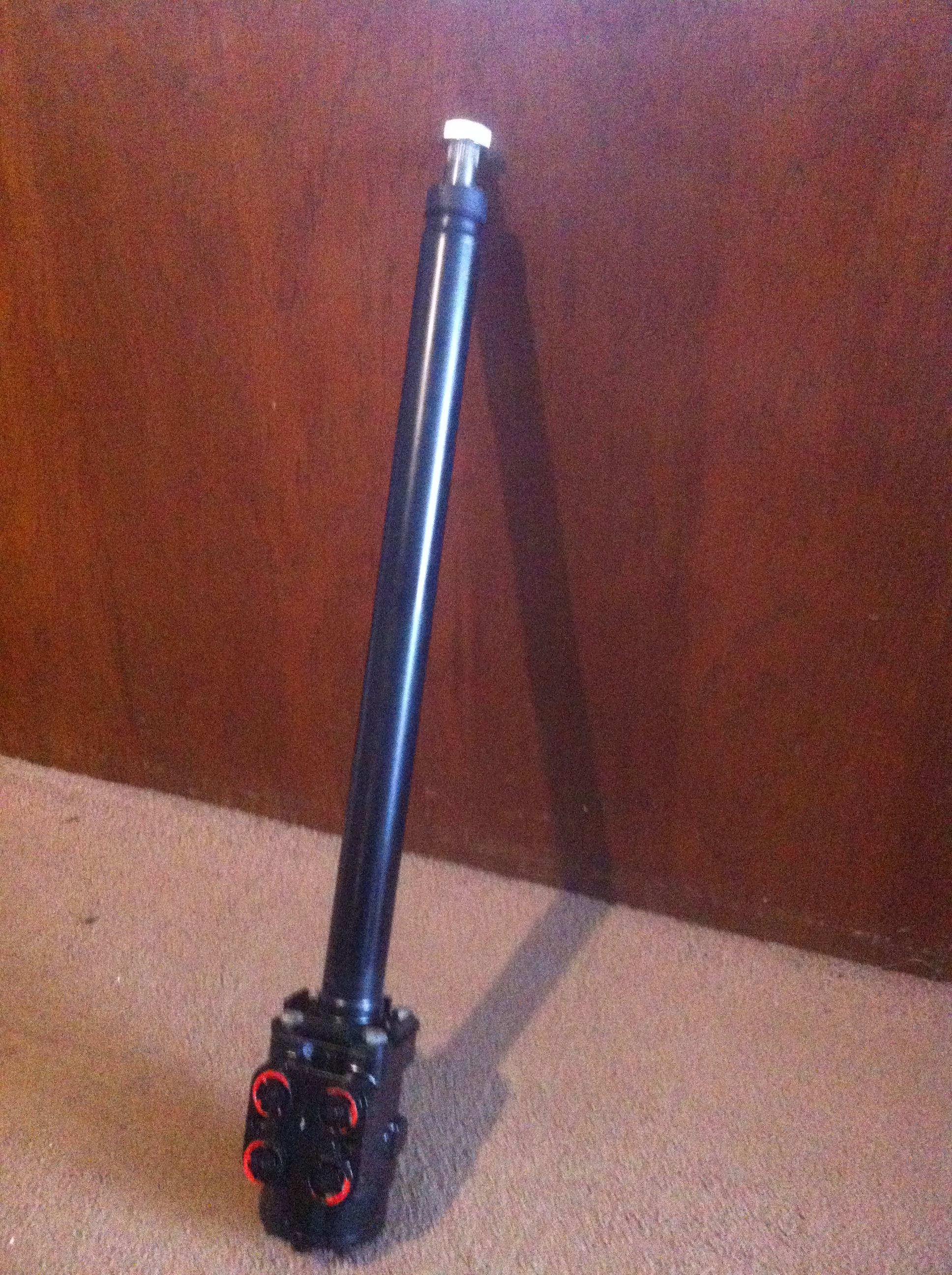

I bought this column and valve from Surplus Center to replace my late-'90s T5C's OEM setup. Lacking a center cap the wheel had let water into the column, which rusted the shaft, which ate the top bearing/bushing, which allowed crud to settle and beat up a 'face seal'* that keeps fluid from leaking up the column. (*a part the size of a quarter, ~$40 + S&H :()
IIRC it's a 4.5 cu in valve and is 'non load reacting'. (no feedback felt at wheel) Column is 24" and top spline is a common one shared with old iron. Lately, SC offers little of the dozen plus valves and half as many column lengths I had to choose from, and only shows one valve now. The category is bare and a note says 'coming soon' as if a new thing. :confused:
My OEM steering wheel isn't going to come off its rusty spline without a fight, or likely in one piece. I could probably dig up the specifics to help a member find a similar setup to what I bought. Just ask for more, if you're looking to refit a T5C. jon
