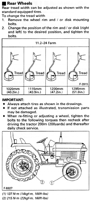

Han -
I forgot to mention that I have my rear wheels set to maximum width on my L2500. I think there are 4 possible settings. The previous owner used it to pull an apple cart through orchards which were totally flat, so had the wheels set narrow. The broker I bought it through set them wide for me before I took delivery.
For stability, wider is better.
   / steepest slope
Harv,
How wide is the widest setting? outside of tire to outside of tire? How did they adjust?
   / steepest slope #8
Han -
There's about a hundred miles between me and my tractor right now, so I can't lay a tape measure on it. I'm pretty sure the outside measurement would be right around 5 feet. Here's a couple of <A target="_blank" HREF=http://www.tractorbynet.com/forumfiles/37-82475-WheelWidth.jpg>pictures</A> showing how it looked on the lot before I bought it, and another which is kind of a "candid" as it looks today. Using the taillights as a reference, you can get an idea of difference.
As for the details, maybe this excerpt from my owner's manual will help:
