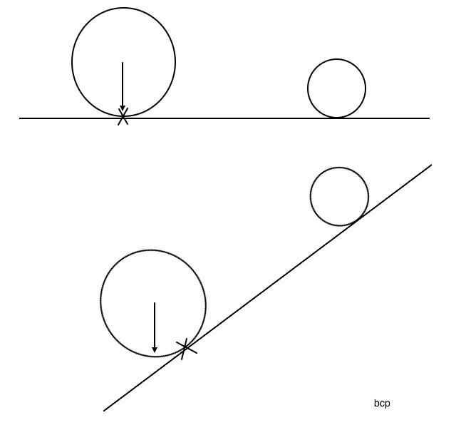

Ballast in the tires will contribute to a back flip on a hill, as the center of the weight is now behind the ground contact point.
Bruce
