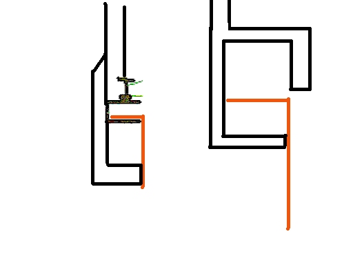

If I understand this right, this is a "free standing" 30" ladder clamped to lip of a lowboy . first any of the materials described here will easily surpass your requirements. As far as the clamping to trailer that 3 pieces of welded flat stock and a couple of bolts appears to me to be your weak point. flexing, as a 350lb man climbs up and down. that same Ryerson catalog that spec. sheet came from has a large selection of "C" channel and such. Or a fab shop could brake something up.

I have to agree with Ron when he said </font><font color="blue" class="small">( I would more concerned with how it attached to the trailer so that doesn't fail or come undone and cause the ladder to crash down. )</font> I had a couple of ideas for making the mount stronger. Add an aditional brace that goes below your clamps and rests on the side of the trailer. Use a mounting system that slides over the sides of the trailer to lock it in place. I modified your original drawing to show you what I mean.

Do the trailers have stake pockets? If so, your mount could be a piece of rectangular section that slides down into one or two of those.
