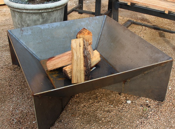

we've been through a few commercially-produced cheap fire pits - they're junk and just don't last. i'm looking for something bigger and a bit more utilitarian for the next round. after doing some shopping around i found that there does seem to be a niche market for heavy duty fire pits but they are expensive and for obvious reasons need to be found locally.
so, *considering* building my own. i like the idea of something like this built to about 4 ft. square.
so the first obvious question is: what to build it from? (type/thickness of steel) what can withstand the temperatures of a fire and being left outside? stainless is out for cost reasons and i really don't mind the look of the rust patina.
access to plasma/welding equipment and expertise can be assumed available. i'm an amateur but know my way around a bit.
help from those with experience greatly appreciated. thanks!

Semi Truck rims are really popular as well. Anything thicker than 1/4" is probably way overkill, A36 hot rolled steel is kind of what that pic looks like it is made from. A36 is good & should last for long time as long as water can drain out of it quickly. Water and ashes together forms acid which will eat the steel up no matter what type you use. The boiler plate steels are a bit different harder material & rated for higher heat/pressures vs A36 (sa36 in some places) & they (boiler plate) may need a bit different welding practices (for certifications but not req for outdoor fire pit.)
The 1/4" stuff would be HEAVY and something as shown in 4'x4' would need 2 people to move or tractor. Lighter weight 10gauge or 3/16 should work without with a small amount of reinforcing a top edges to keep warping at a minimum with a good long or hot fire, (angle iron or bent top edge.)
The "hot roll" slag can be left on but in fires will usually chip off taking any paint or coatings you put on with it. Boiled/Pickled steel in similar materials is going to have very little rust resistance however it will take a high temp coating & hold it longer.
Anyhow anything you build for holding a fire and setting outside is not going to last for ever build with what you have and once it wears, rust or burns thru haul it to scrap yard and make a new one ;)

thanks mark.
a36 hot rolled is pretty readily available so this is what i was looking at so long as no one tells me to stay away.
i don't mind heavy. it won't move often and as long as the tractor can move it, it's not too heavy.
i was thinking of running a piece of flat stock around the top lip for just the reason you mentioned, to keep the top edge from warping. this is probably where the pit would most easily warp and also where the warp would be most unsightly.
good info re: the slag and finishes. right now i'm thinking to just leave it unfinished and hope it lasts a while! appreciate the input.
