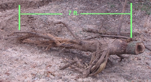

1/4" grade 80 spinning chain is all anyone needs up to 70 hp 4x4 for pulling stumps, towing or transporting the tractor. You'll appreciate the weight at days end. This walnut tree was pulled with a 1/4" chain and a TD75D tractor. Learn the Clove Hitch knot and the improved Clove Hitch knot for fast tie and retrieval of your chain.
