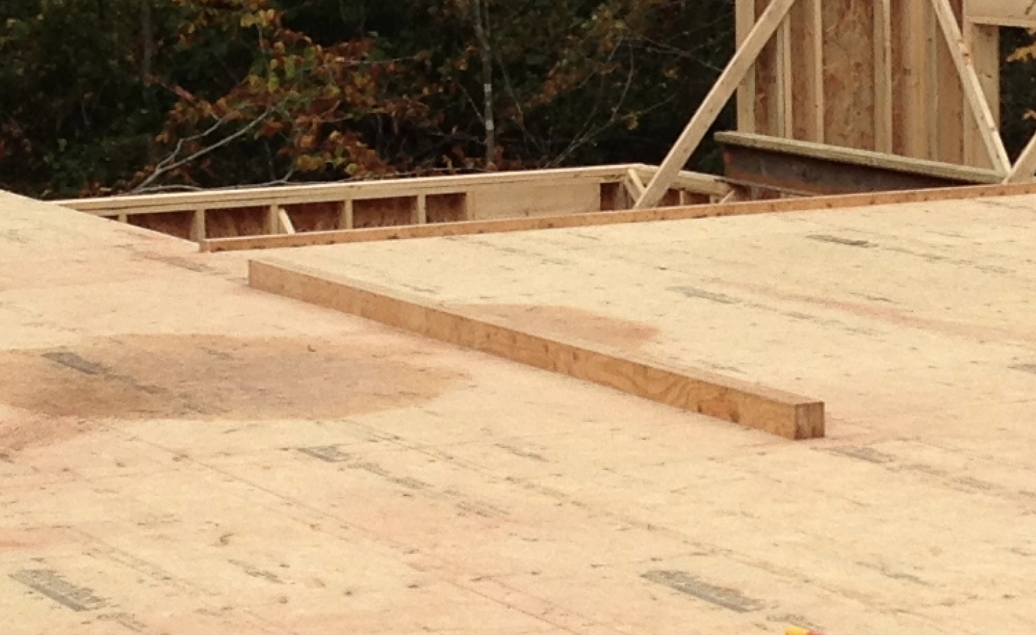

You said first floor header. Is there a second floor above the first floor? Can you make your ceiling joists into the header and hide them inside the second story, flooring?
Often, you can sneak a tall LVL beam into limited space by making it poke above the second floor. If lined up with a wall above, it works very well. Here's an example:
   / Steel beam - wood equivalent #9
Never seen or thought of this before. Very smart!!!!
