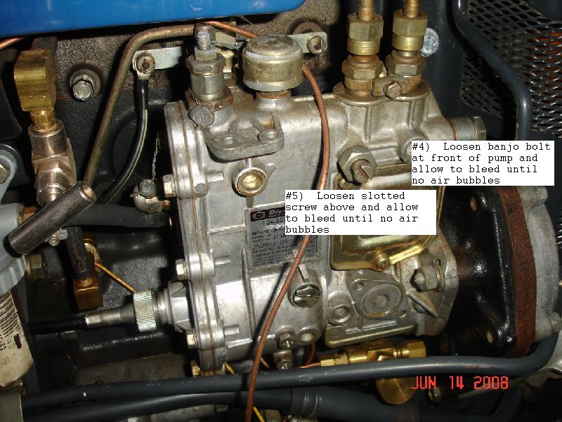

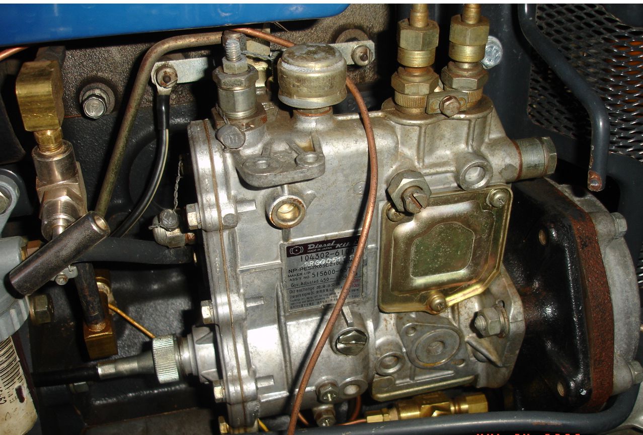

Hello Friends,
I just changed the fuel filter on TS 1610 and it than run for a minute and stop. I sow this post and realised that there is air in the injection pump.
I read the steps but can s.o. specify on the attached picture thich really are the bleed screws mentiond in marks :
4) Loosen the eye bolt on the injection pump fuel inlet line (AKA a "banjo" fitting) to bleed air in the fuel line. It's on the front of the pump. Then, retighten.
5) Loosen the air bleeding screw on the side of the injection pump to bleed air. It is a hex head screw with a slot for a flat blade screw driver, and is located just below the fuel supply pipe connection that serves the rear fuel injector.
Thank you
Mihail

Hopefully this edited photo comes thru OK. I added two text boxes with #4 being the banjo bolt at the front end of the pump, just above the top center of the text box. You can see the brass colored hex head bolt that threads thru the banjo fitting in the photo, just loosen it and allow fuel to drain out until you see no air bubbles, or for a period of say 5 to 10 seconds. Text box #5 is for the slotted bleed screw shown just above that text box. Back it out (open it up) until fuel flows out and then retighten it when no air bubbles can be seen. Hope this helps.

Thank you Larso1 !
You really help me. It is done.
