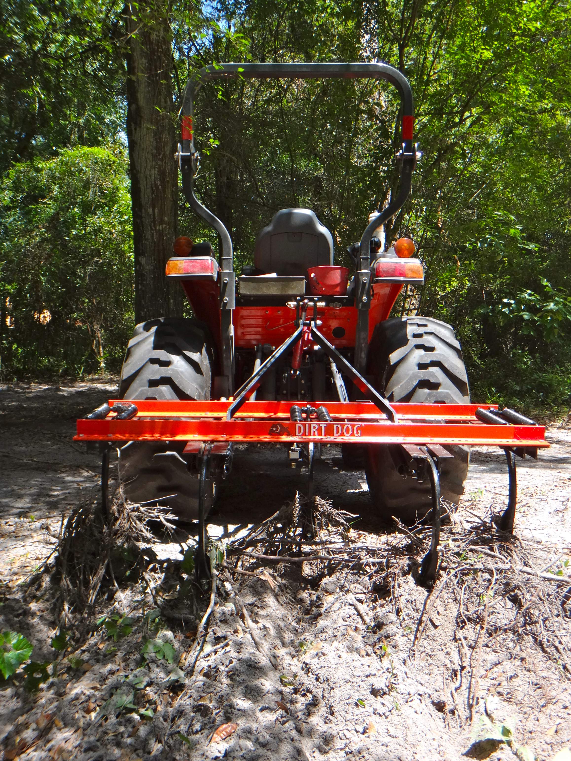

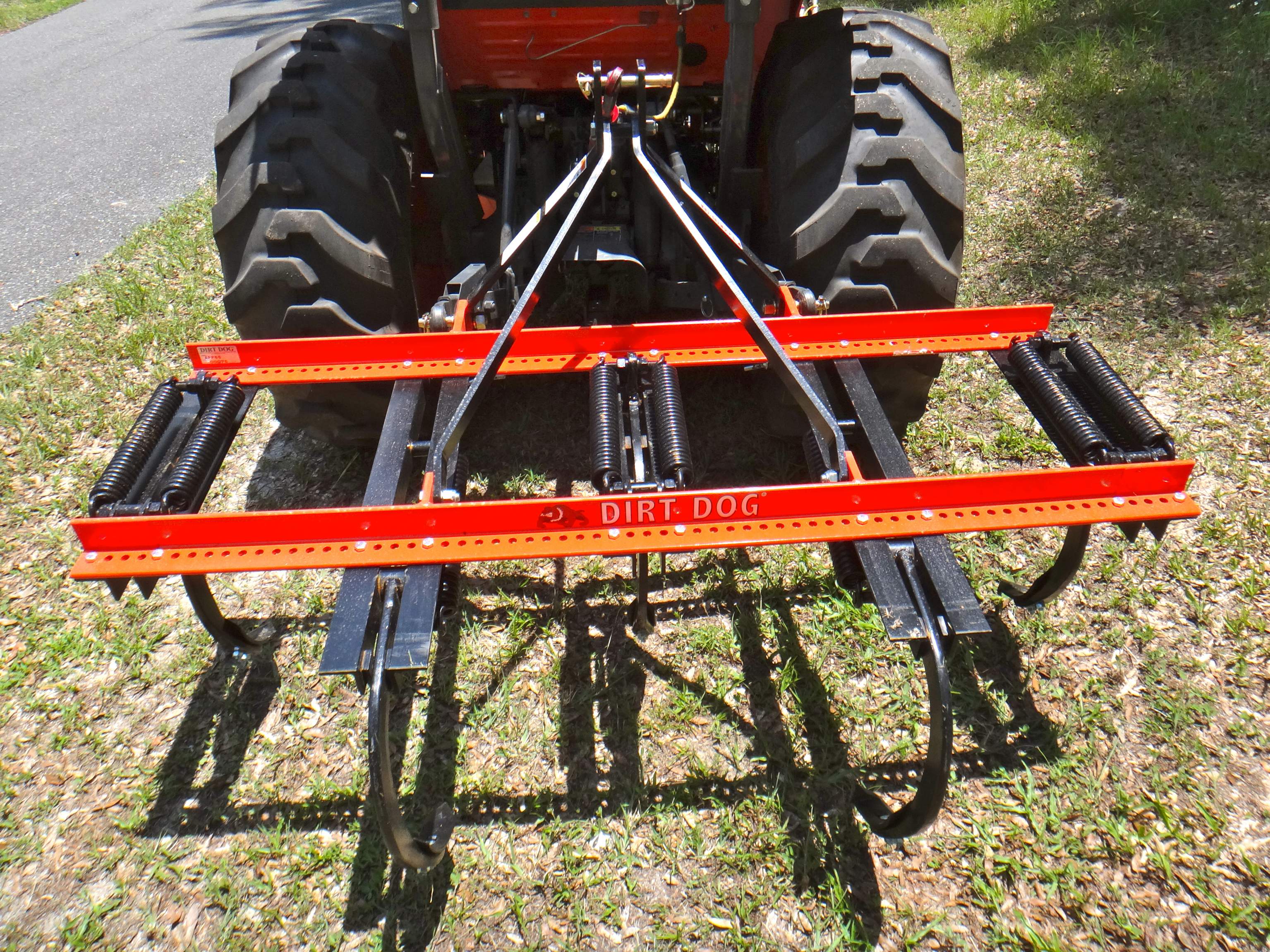

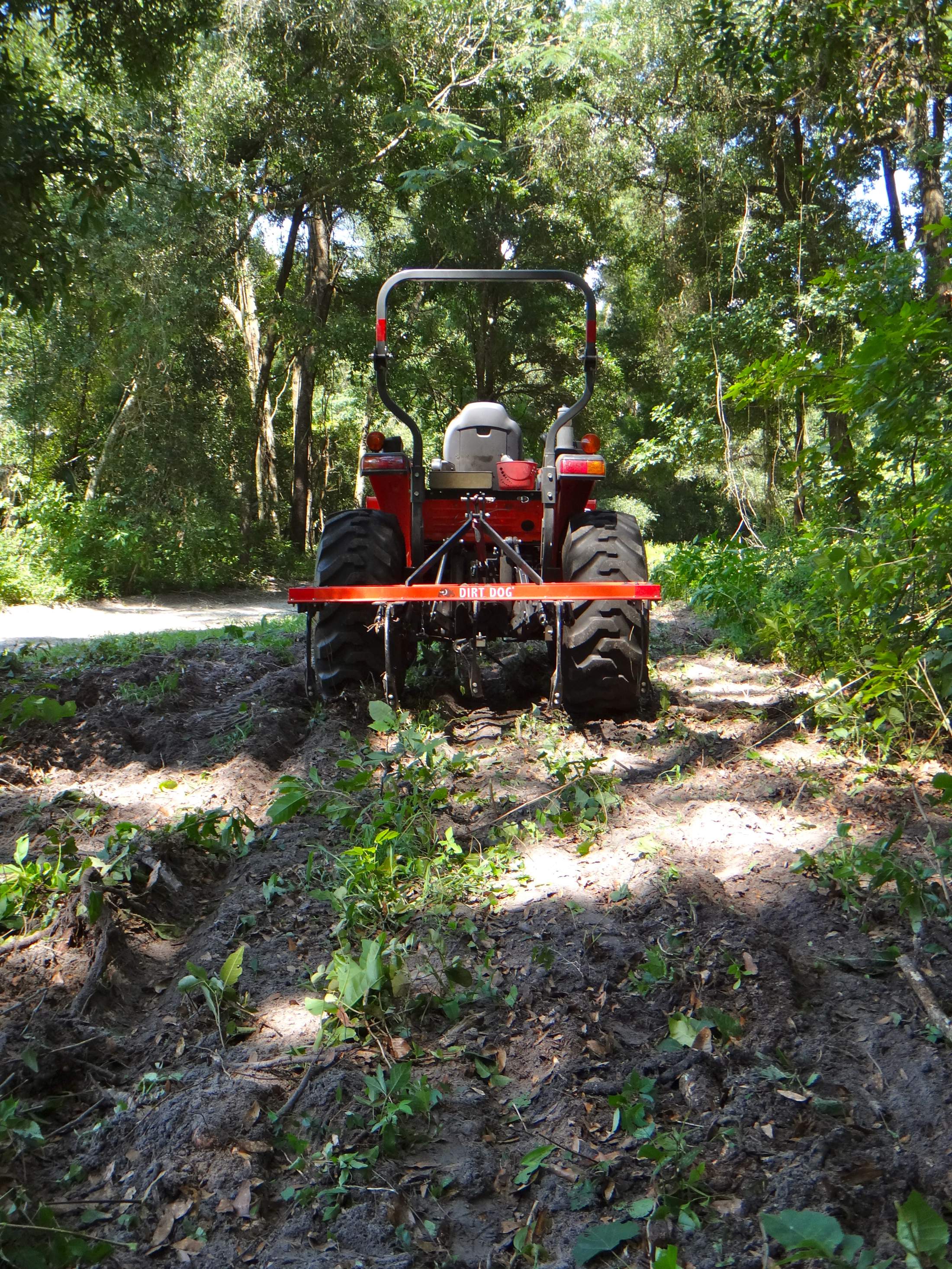

If the field has laid fallow for several years, I'd consider buying a chisel plow or field cultivator to break up the soil before tilling it.
Everybody here seems to love tillers and I understand why. But a tiller pulverizes the top few inches of soil, but does nothing to break up the soil underneath.
The disc harrow and the tiller perform similar functions. Instead of having both a tiller and a disc harrow, I'd MUCH rather have a chisel plow and a disc harrow or a chisel plow and a tiller.

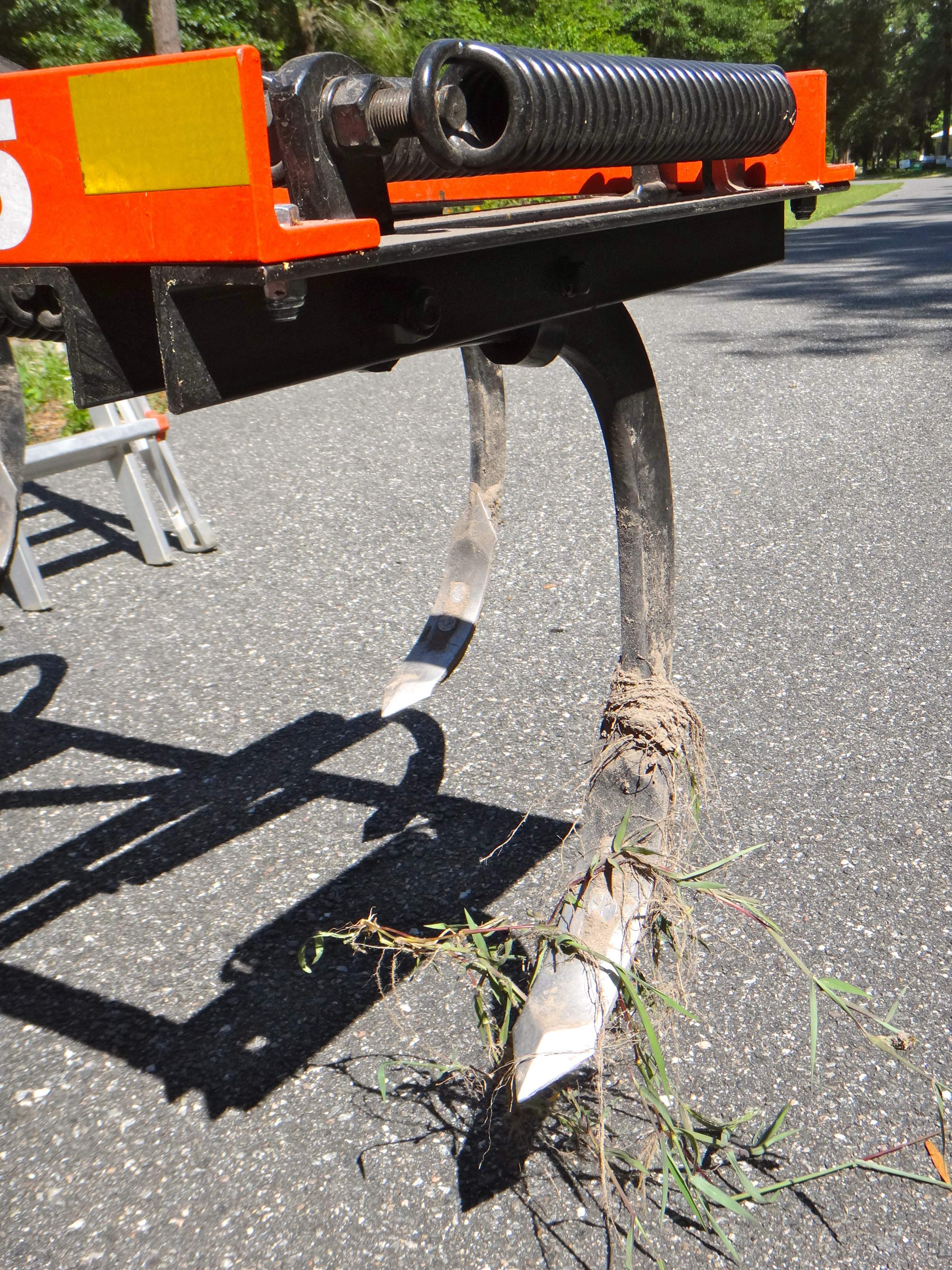

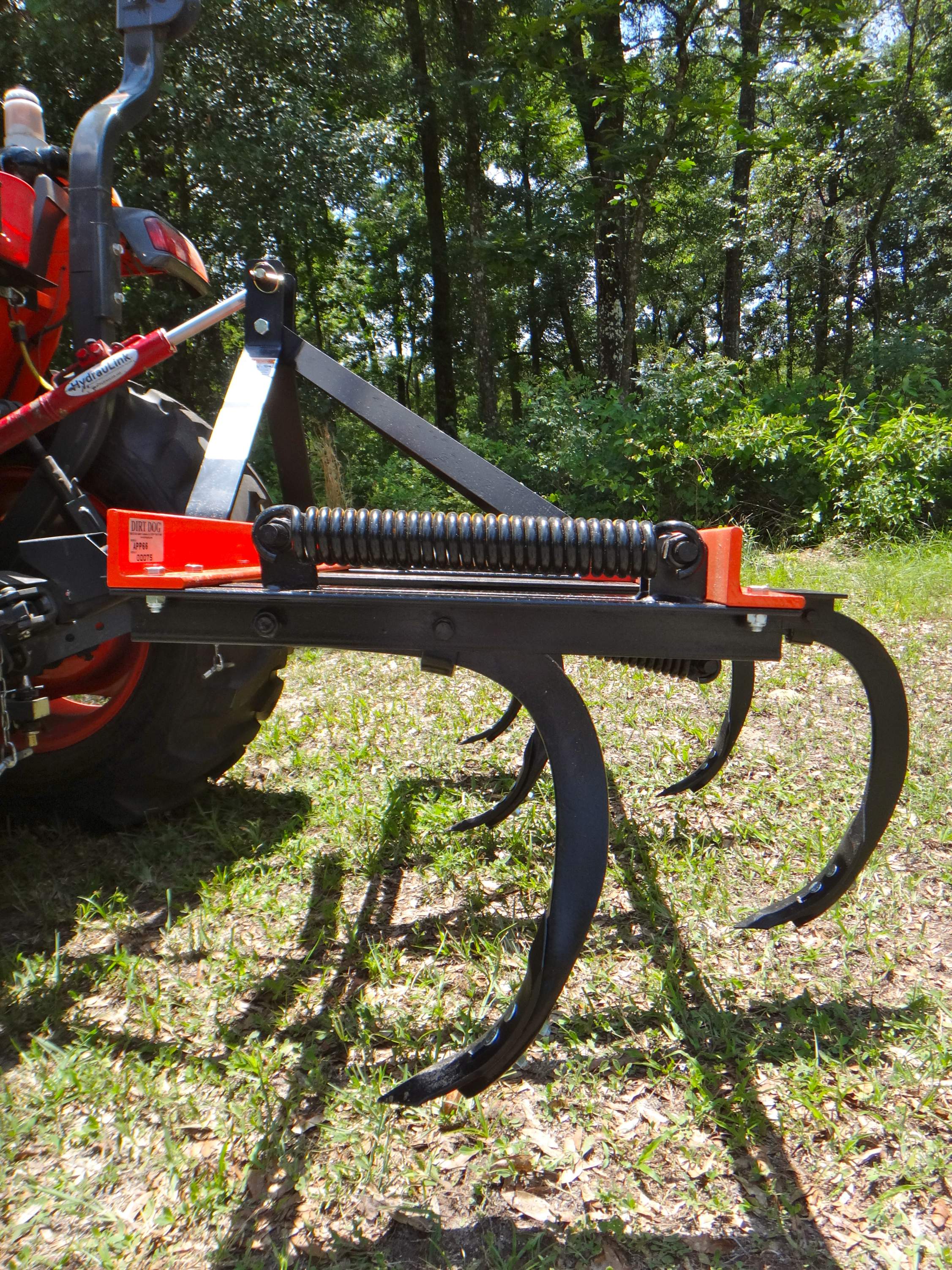

   / Starting to work field #8
If you had completed your T-B-N profile with your location, so we had a pretty good estimation of your soil conditions and topsoil depth, we could make more particular recommendations. Lack of profile data may be why you experienced minimal responses to your earlier threads.
RE TILLER OR DISC HARROW: In North Florida I would not mix the topsoil deeper than 6" unless compaction resulted in standing water after a rain. You do not want to mix quality topsoil with infertile subsoil unless it is to overcome another problem.
Here is a LINK to my thread on Field Cultivators for compact tractors: http://www.tractorbynet.com/forums/attachments/339095-dirt-dog-all-purpose-plow.html?highlight=
A Filed Cultivator fractures soil profile but does not mix soil.
((A new Buckeye Tractor Co. 3-shank Chisel Plow, springless, for your L4400 runs about $1,800.))
