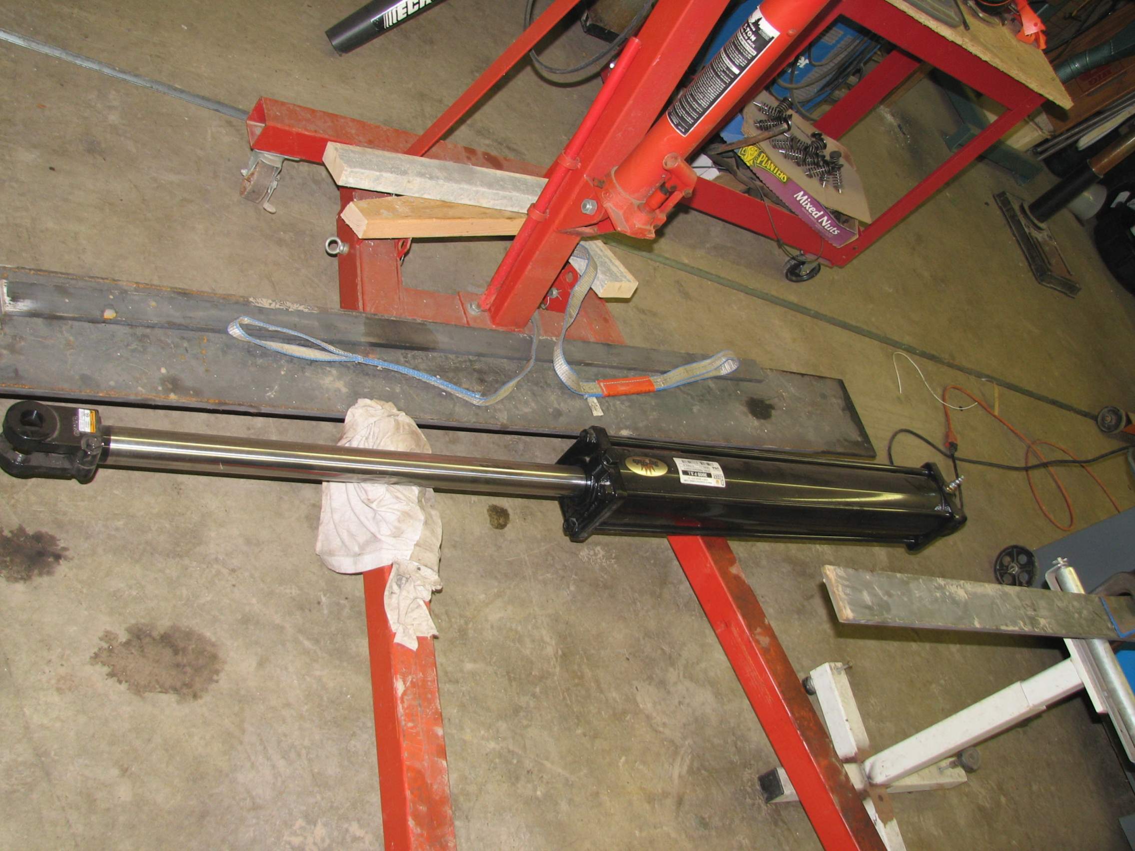

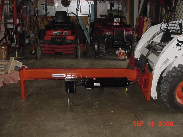

Using a 4.5" x 30" cyl. Beam is large but free.

HA that was just a piece of it. I was 32' long. It has been it the yard of a customer for 15 years. They said If I took it away and didn't trash the yard, I could have it.

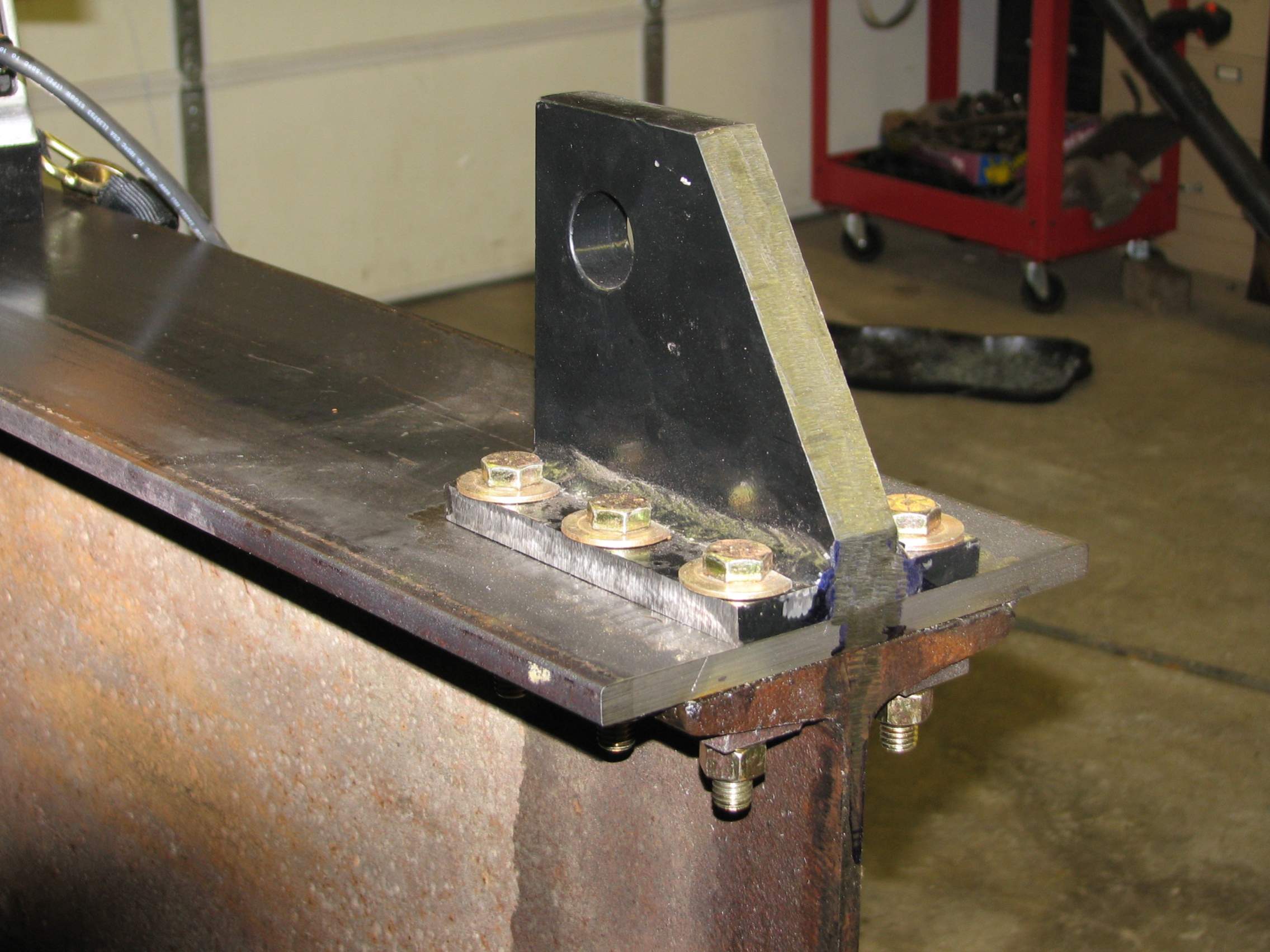

I hope you did not mind as I had a look at your shop. Did you purchase the end bracket premade because I am going by the sticky label? Once you make the first splitter you know where to get the rest of the beams.

Yes the cylinder tie down bracket is also a northern tool part. I believe it will be the week link in this system. I plan on adding some weld and a backer spine (so to speak).

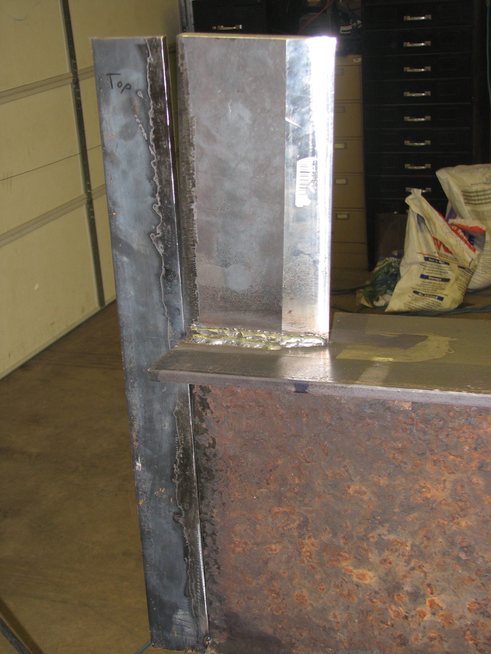

Rio, you give me too much credit. Although I will add a secondary wedge it will be fixed, probably a 2x3" angle iron. The piece behind the wedge is to try to take some of the splitting pressure off the 1/2" x 8" plate that the wedge is welded to and distribute it to the web of the beam. The v shaped gap will be filled with a thin pie shaped piece and welded in.

This weekend was spent drilling and bolting the cylinder tie down and cutting material for the pushing sled.

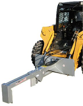

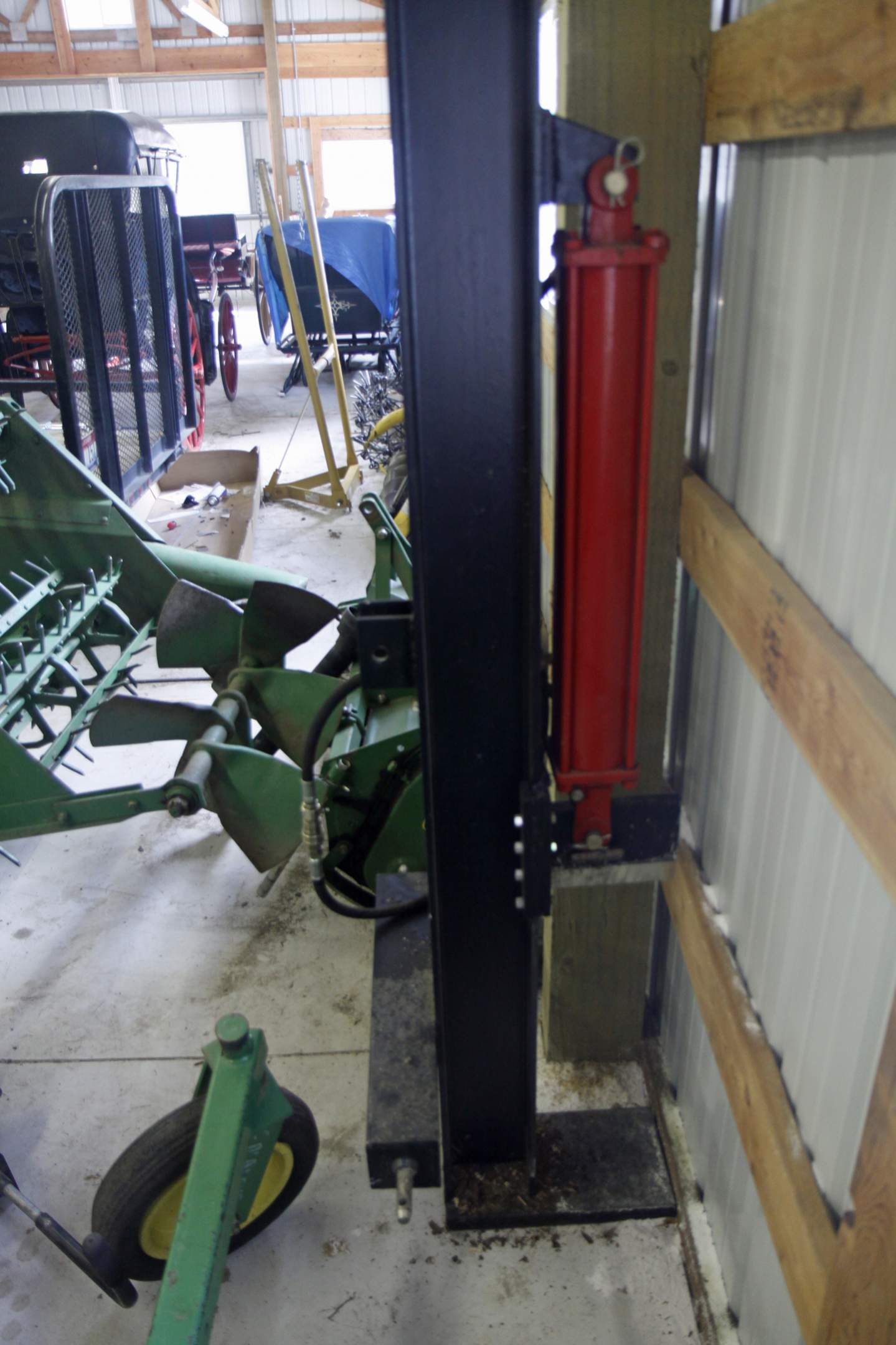

Here are a few pictures of SS splitters. Might get some new ideas.

   / Starting my skid steer splitter. #14
im not sure about making one for a skid steer...but i made this one for a 3 point hitch... ive used it for about 5 years. got the wedge and angled shackle from northern tools. has worked great

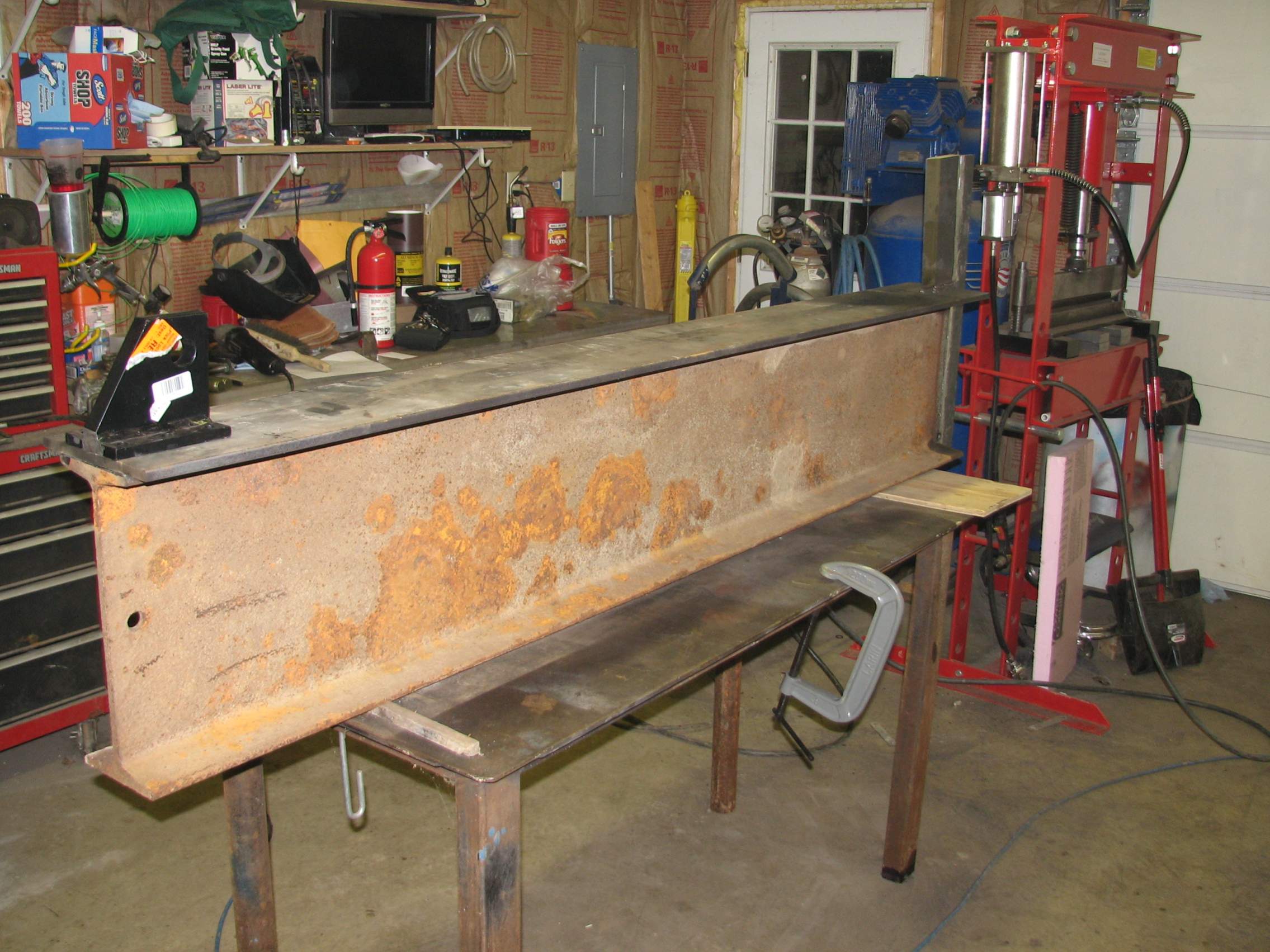

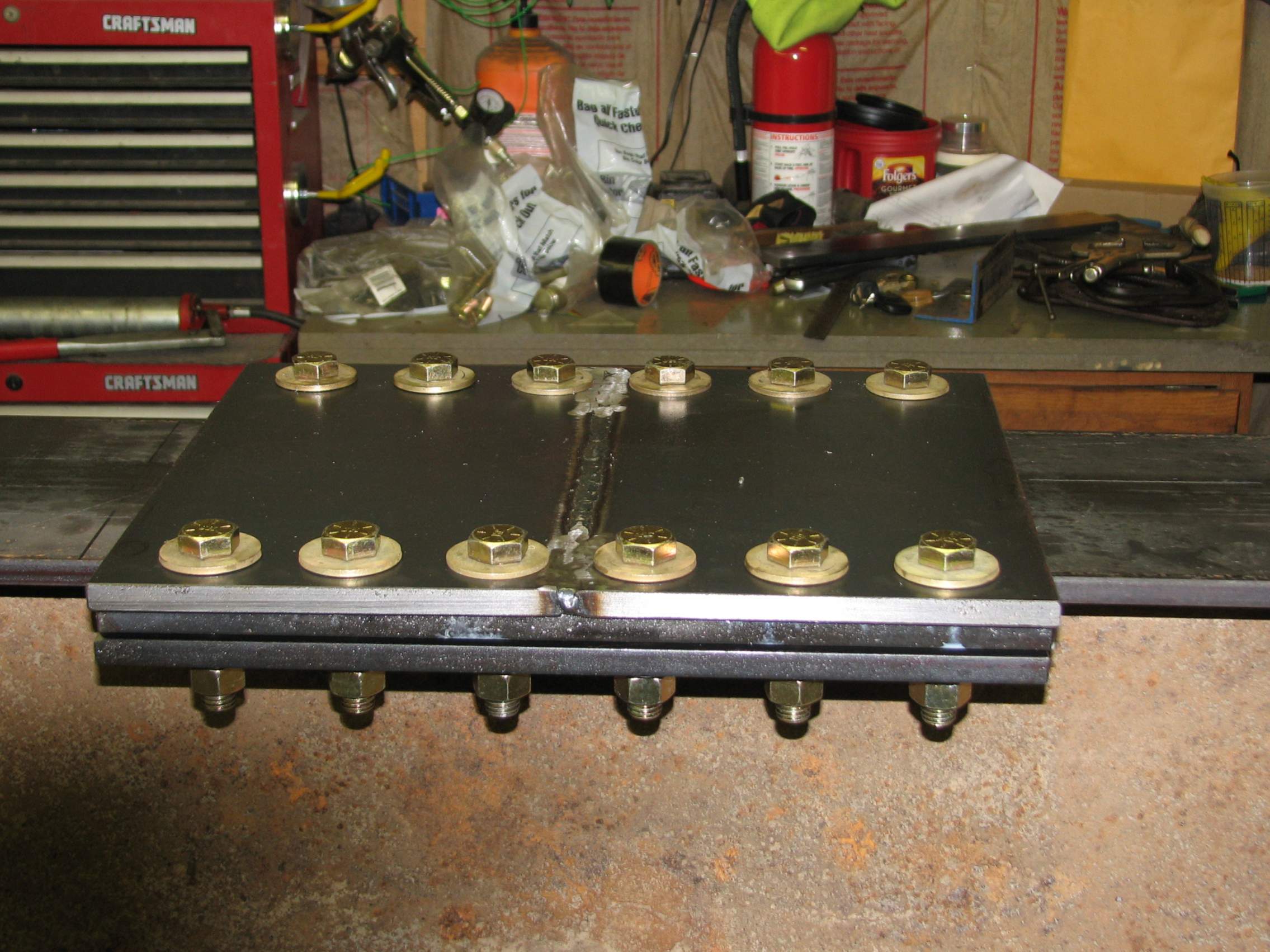

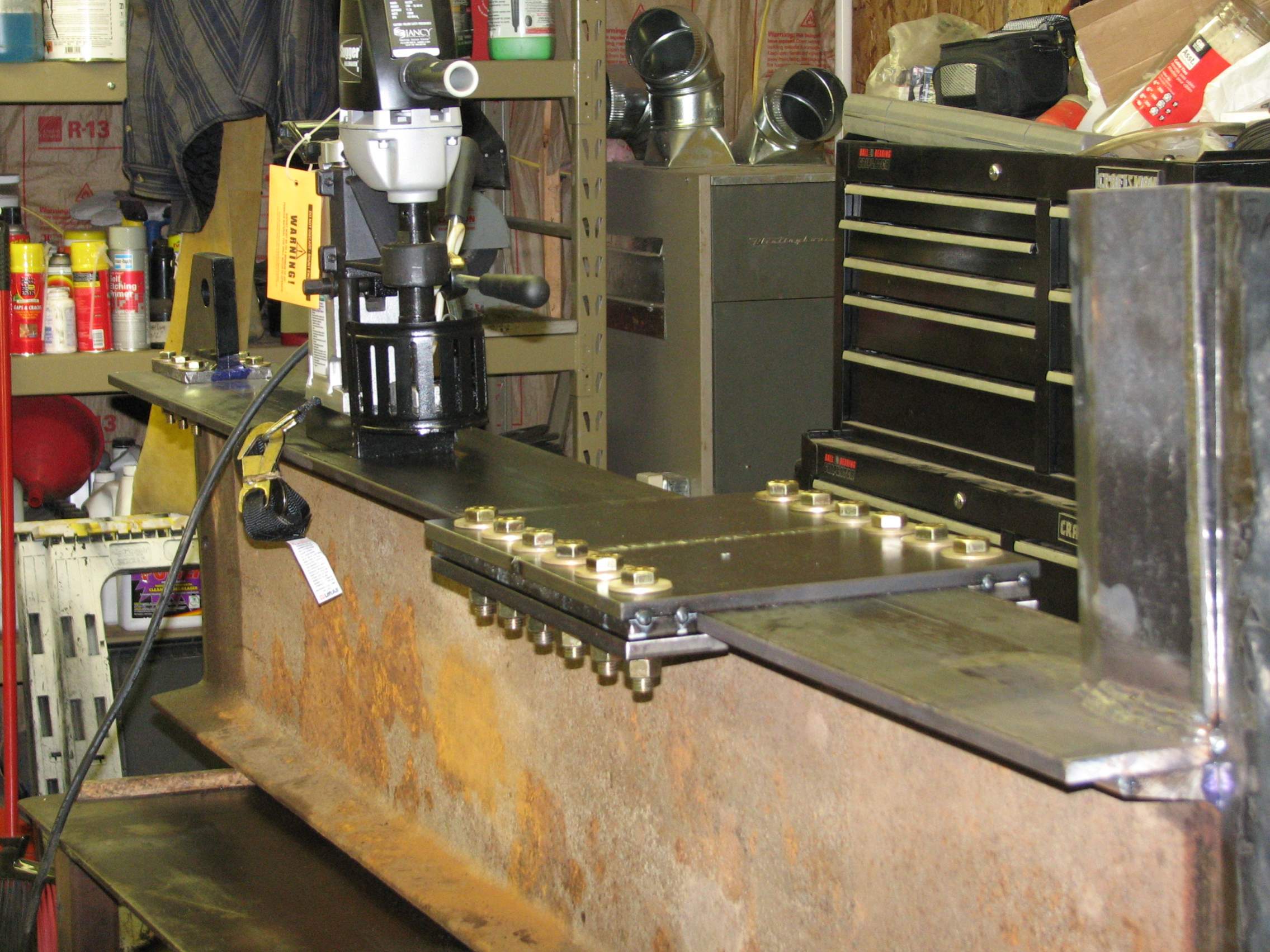

Ok, well I had to take a week to plow some Ice and snow. I have gotten the cylinder tie down attached and did a whole lot of hole boring to fabricate the base for the pushing sled.

1grnlwn - your mag drill is getting a workout! Question - is the beveled steel strip under the I beam web available commercially? And did you use that same material reversed as a guide for the slider? All the wear my old splitter has is where the slider moves along the beam. I assume you tacked and bolted that together so you could replace worn parts? Nice fabrication.

Jimmy, First of all the cyl tie down is shimmed with beveled washers. They are made to use when you need to bolt something to a beam. They came from Fastenal and are about a buck a piece. The slider slides on a 1/2" x 8" flat bar that is stitch welded to the top of the beam. I am toying with the idea of putting some grease zerks in high wear places. To be honest the bolted slider is just copied from many of the splitter designs I have seen. It does give the flexibility of adjusting "fit" when needed. As far as the mag drill is concerned, it is my latest addition to the shop and I can't imagine trying to align and drill all those 5/8" holes with my wimpy drill press. P.S. it still took a long time to drill all that, messy too!

Beveled washers,, geinus,,,,
saves me another step, was gonna bevel a slide..
