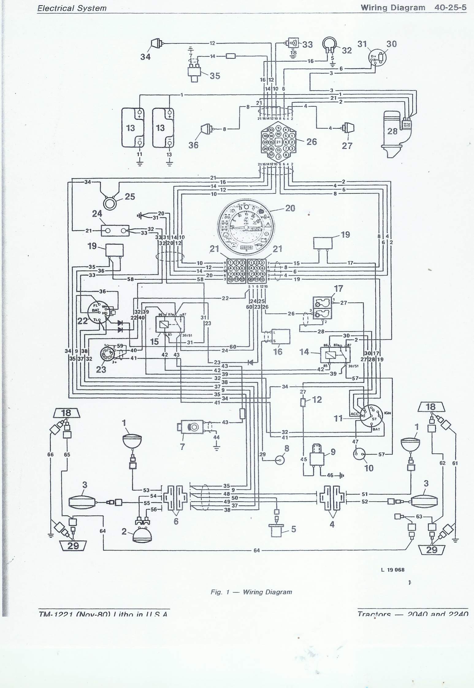

Been having some issues with the starting circuit on my John Deere 2240 tractor.
Here's a little background: Bought it used about 1-1/2 years ago and it had issues when I bought it. I've found a lot of corrosion in all the wiring connections and the harness wiring is old and brittle. I've ordered new harnesses and will replace them in about a week. The terminations on the starter relay were absolutely nasty.
Deere still sells the origional relay, but recommends and upgrade to an old Ford style starter relay. I bought the new relay today since the dealer had it in stock and wired it into the tractor. No change in performance. Voltage to the relay drops to 8-9 volts when the key is turned to start. At 9 volts the tractor starts and at 8 volts it doesn't. The instructions Deere gives for the upgrade say to wire from the starter battery terminal directly to the input to the starter relay. The factory wiring goes through the neutral start safety switch first so that there is no power to the relay unless the tractor is in neutral. Doing this the tractor starts every time, but it bypasses the neutral start safety switch.:confused2:
I'm curious of everyones thoughts on following the upgrade instructions vs rewiring it per the manual to the new relay when I receive the new harnesses.

Perhaps a better description of the starting circuit will help.
Battery to starter battery post. From there to citcuit breaker, then to key switch. From key switch ignition terminal to neutral start safety switch and then to the battery side of the starter relay. Output of starter relay is direct to start terminal of starter.
Key on and everything else off, 12 volts on battery side of starter relay. (Same if everything is on.) Turn key to start, 8-9 volts on battery side of starter relay. Strong engagement of new relay. Batteries are new as are all battery cables. 12 volts across battery terminals when trying to start and starter not engaging. If jumped directly at the starter, it fires strongly and immeadiately. The starter was rebuilt and reinstalled yesterday. (It smoked after getting filled with hydro fluid - don't ask.:confused2:)
Relay control circuit: From key switch start terminal to relay+ then from Relay- to ground. Pretty straight forward.

Here's a copy of the wiring schematic.

I was considering that, but I think I found an easier solution. I'm going to look at moving the neutral start safety switch to the relay control circuit. This will allow me to continue to have the neutral start, but still bring direct power to the relay.
The nice part about having new wiring harnesses coming is that I can butcher the existing one to try different things without having a permanently butchered harness.:laughing: The only issue I see right now is actually finding the wire which supplies the power down to the neutral start safety switch. Never found it today. Currently it's getting its power from either the IGN or ACC terminal reguardless what the schematic shows and all of the current wires in the harnesses are painted green. IMO someone in the history of this tractor was an idiot with a can of paint because everything's green.:confused2:

Thanks for your input Bill. That's what the instructions say to do. The issue is that the control for the relay comes straight from the key switch and doesn't include the start safety switch. The start safety switch is in the circuit from the battery to the starter 'S' post (per the schematic and real world). That's the change I'm going to look at doing today is to move the start safety switch to the control circuit. I think this was simply a poor design by Deere since most tractors today have it in the control circuit.
The biggest challenge is going to be to maintain the alarm circuit. The way it's factory wired, the alarm sounds if the barking brake is on when the tractor is put into gear or it will also sound if the tractor is attempted to be started while in gear reguardless of the setting on the parking brake. It also, of course, will not physically start in gear.

Add the extra realy as described. Leave all current wires to battery + side of starter(#30 psot) but add another cable from there to the new relay. Disconnect #2 wire from the starter post (#50 on schematic), use this as the activation for new relay and run another cable from relay to stater #50 post. This should leave all switches and warning alarms working as original.

I changed the wiring around today to impliment the changes. Works perfectly.:thumbsup:
I'm still going to replace the harnesses and relays as well as the safety start switch since I know it has issues as well. All the new parts should be in around the end of the week.

I received and installed the new harnesses. I had to repin the plug on the engine harness as it was pinned differently than the factory configuration. The new main harness matched perfectly. Since replacing the harnesses and several additional parts (safety start switch, relays, flashers, etc), the tractor now starts and runs like it was brand new. I would consider this project to be a complete success.:thumbsup:
