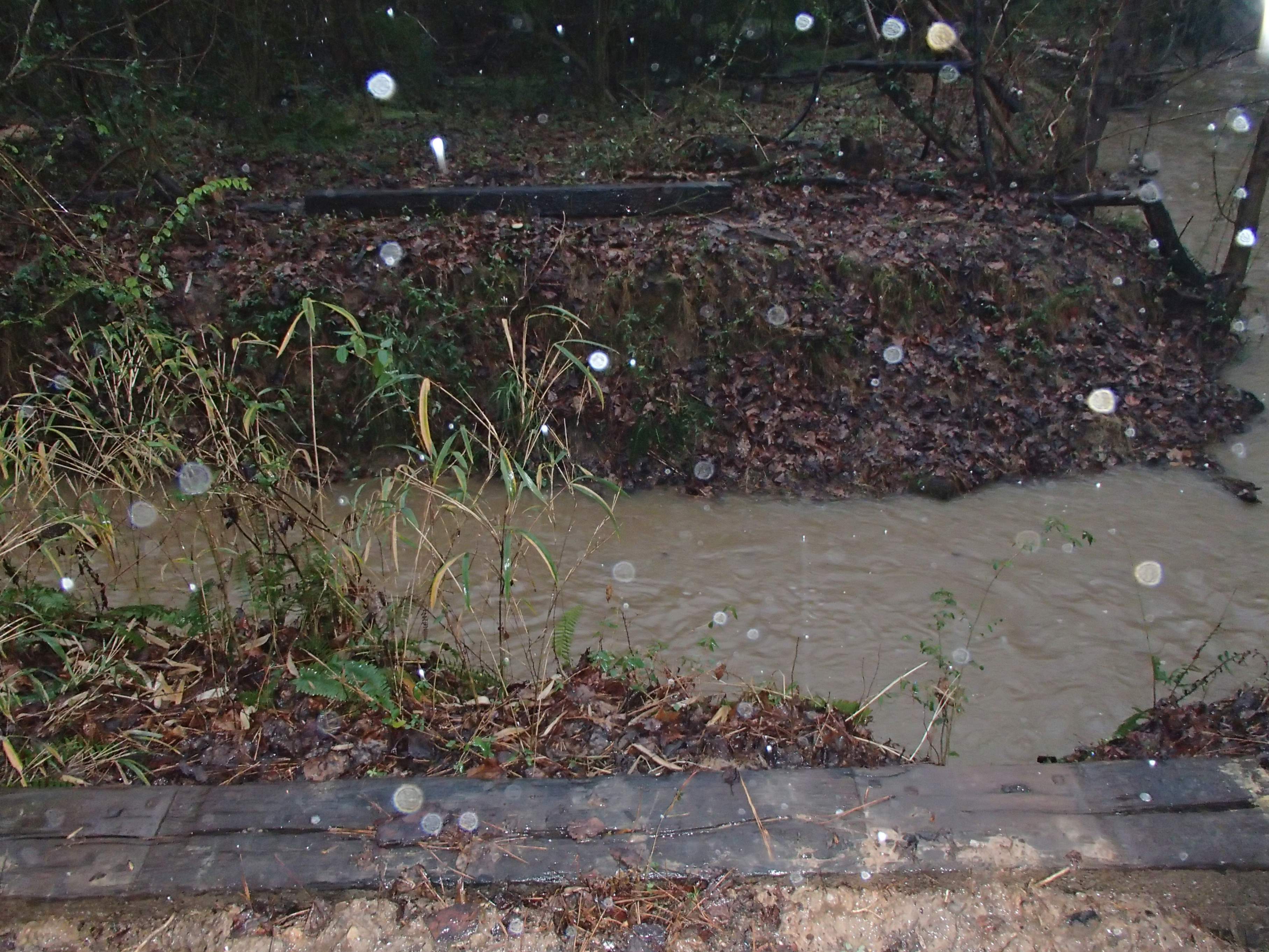

I've enjoyed reading all the posts about bridge building on TBN so thought I would share my own. We have a small creek on our property and being able to cross it will allow us access to 3/4 acre that we own but have never used. We'll also be able to walk to a city park. Initially this was just going to be a foot bridge, but then I thought it would be nice to be able to get the tractor over there to clean up/build trails.
The plan is for an 18' span that will be 6-7 feet above the creek bed.
This shot is of the creek at normal water level - not much more than a trickle.
Here's a shot from the opposite bank after we had about 2" of rain over a couple hours.
I have five utility poles that I'm planning to use as the main "beams" across the creek. Initially I was only going to use 3 but I checked with an electrical engineer friend who checked with a structural engineer coworker and they said that would be pushing up against the maximum capacity for my estimated 3,000lb load of the tractor (Kubota B7610) and FEL and any implement I might have on.
The poles are between 10 and 14" in diameter. They will rest on railroad ties pinned to the banks with rebar. Hard to tell in the pictures, but the rail road ties are about 3-4 feet back from the top of the banks. I plan to marry two poles together on both the left and right side of the bridge and strap them together with some kind of cable or other metal strapping. These will be set apart about the distance between my left and right side tractor wheels. The fifth pole will run down the center. I initially thought I'd deck it with pt 2x6's, but now I'm thinking of looking into full dimension 2x6 white oak from a local sawmill.

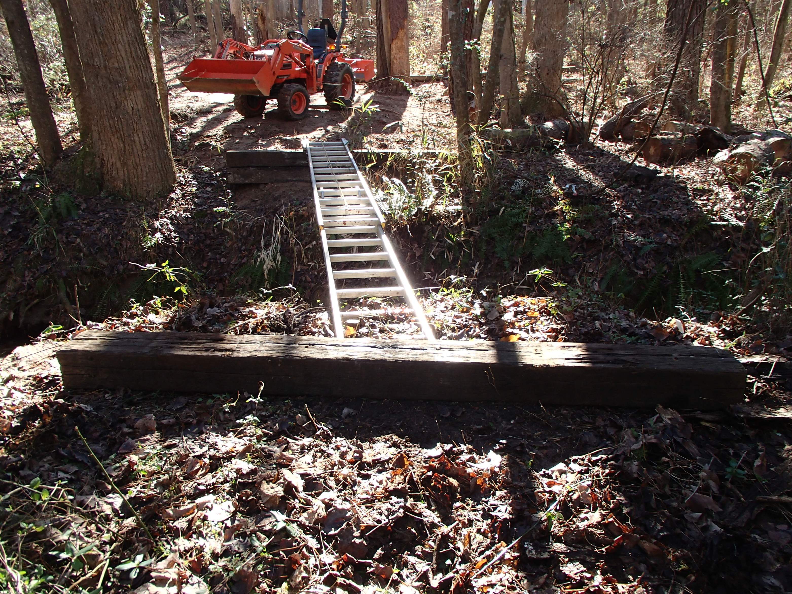

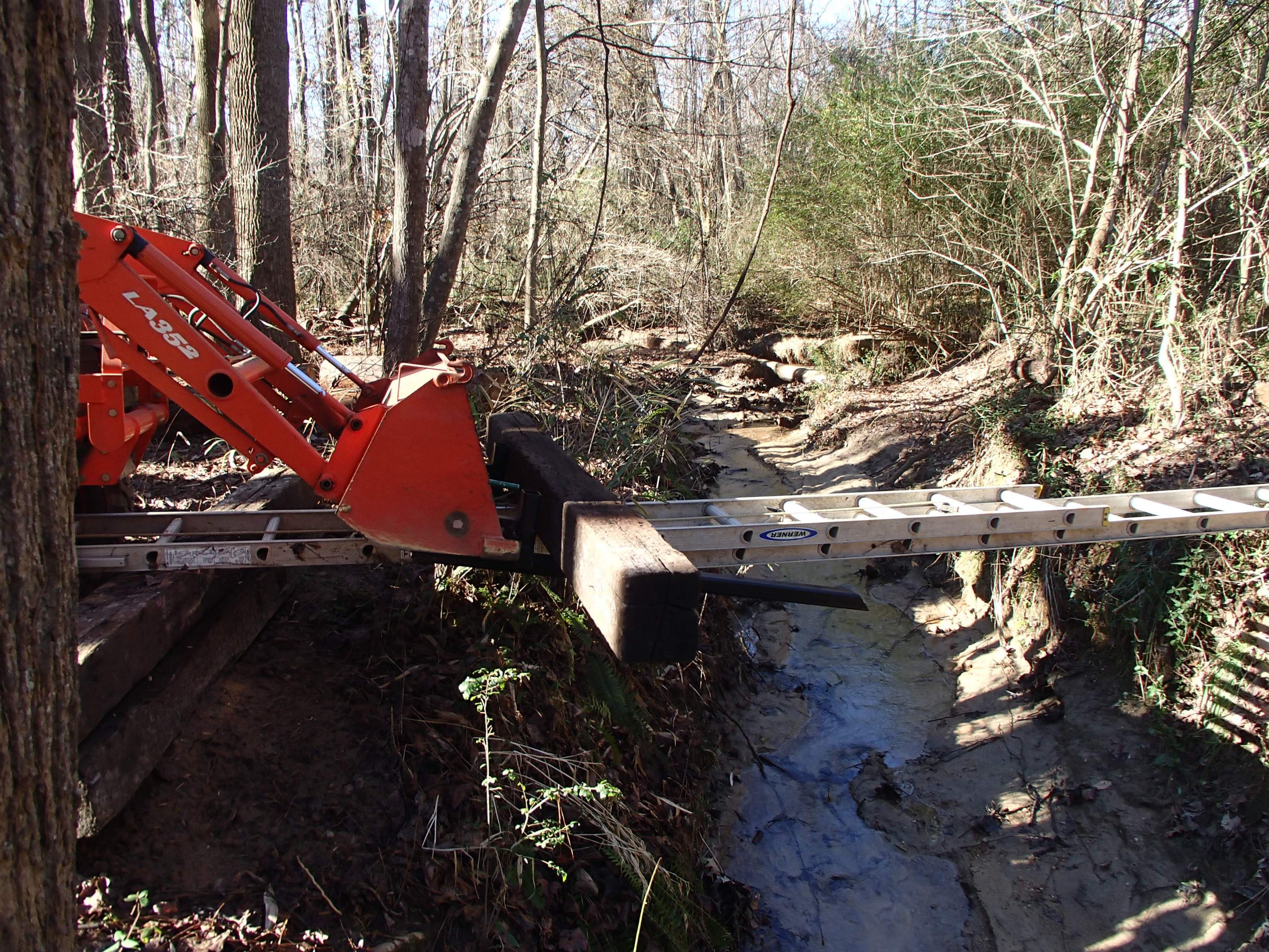

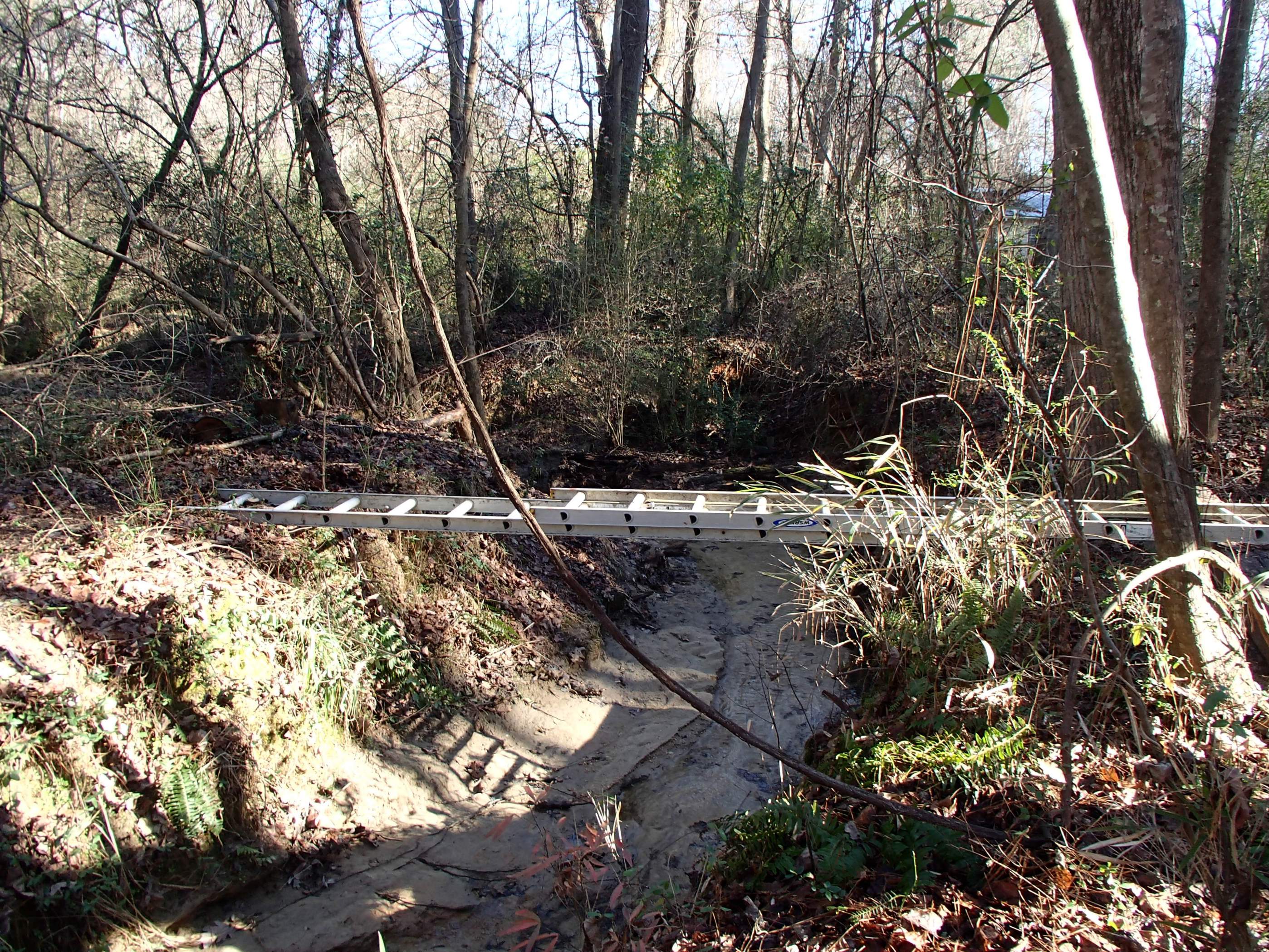

First challenge with the bridge was how to get the RR tie for the far side over to the far side. I have no way to access that side with the tractor and there was no way I could drag it over by hand. Then I thought of laying my extension ladder across the creek and pushing the tie across that.
Keeping the tie balanced on the ladder was a bit tricky, but not bad.
The ladder surface was slick enough that I could inch the tie the last few feet by hand.

I had the come-alongs and chains ready to inch the RR tie across, but it was a lot faster and easier to push one end of the tie and then the other.

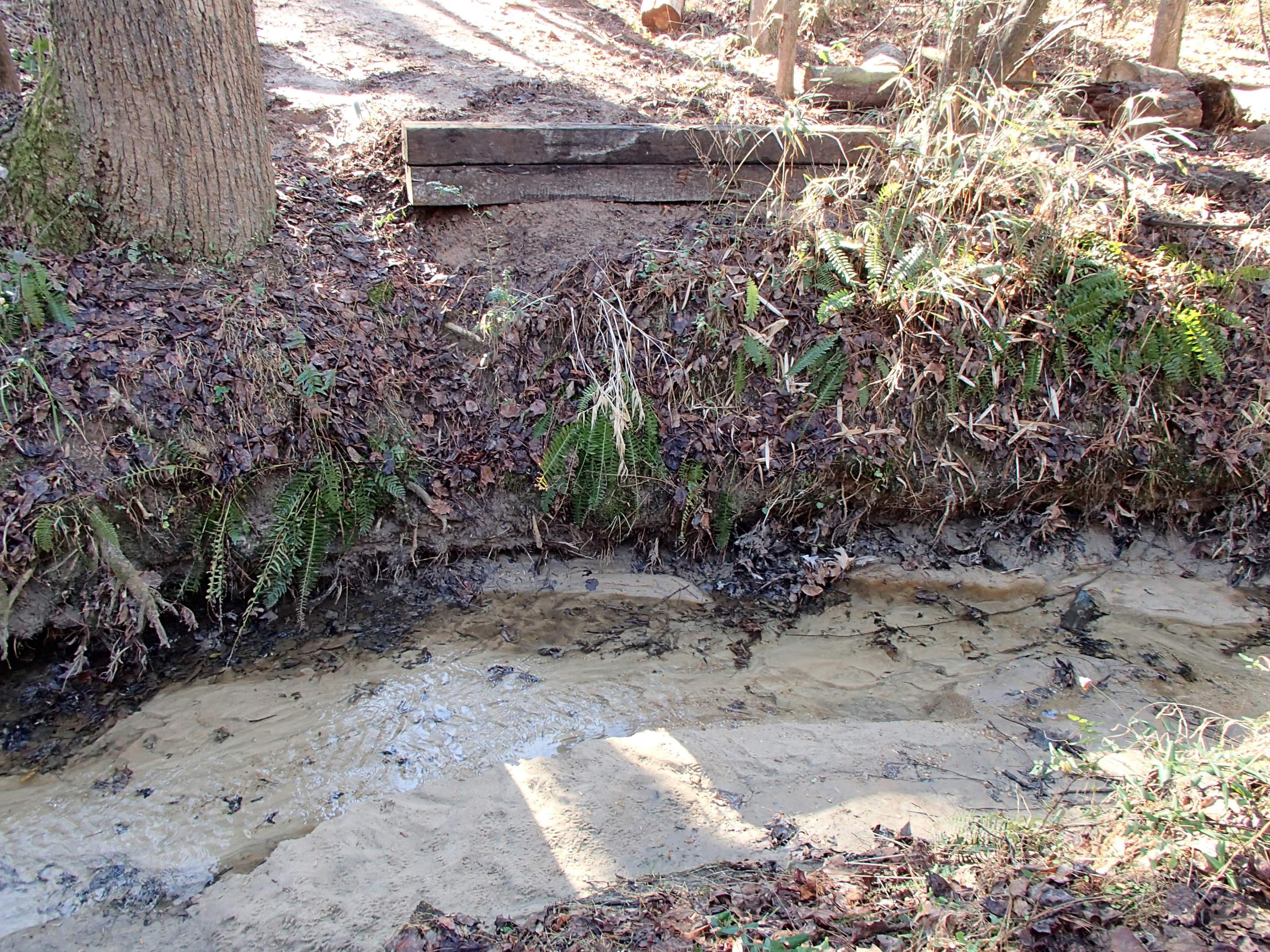

First off - I see that you have sandy soil- and the creek appears to be undermining the bend and its going to get worse esp with sand. I would be putting the supports for bridge farther back as possible. I would also start putting some stones in that bend to slow down the erosion.

Kapn, When I did my RR tie frame bridge I used 10' ties as sill logs each side parallel to the creek. One side was real humus laden material 2 feet deep the other side sandy gravel. I dug down a trench each side 3' wide X 12' long and 3-4' deep. Filled the trenches with 1 1/4 minus crushed gravel, well compacted, and packed gravel all around the sills up to the top. I knew from experience here in the PNW that RR ties do not like laying on dirt, hence the gravel beds down to solid substrate. In the winter I get water flow within 6" of the underside of the stringers. Your pictures indicate you are just setting the sill ties on top of the ground. Those will be easily undermined and/or rotted quickly. You indicated that there is no access to the area on the other side, that complicates things. You will need a temp solution to get the tractor (I assume you have or can get a BH) and gravel over there to work that side. I placed my stringers by getting one end under the front brush guard and strapping about 6' out to the FEL. Picked up that end and curled up the bucket to get the other end off the ground, just eased it across. You could drag across with a line if you can get a block tied off the something on the other side also.
