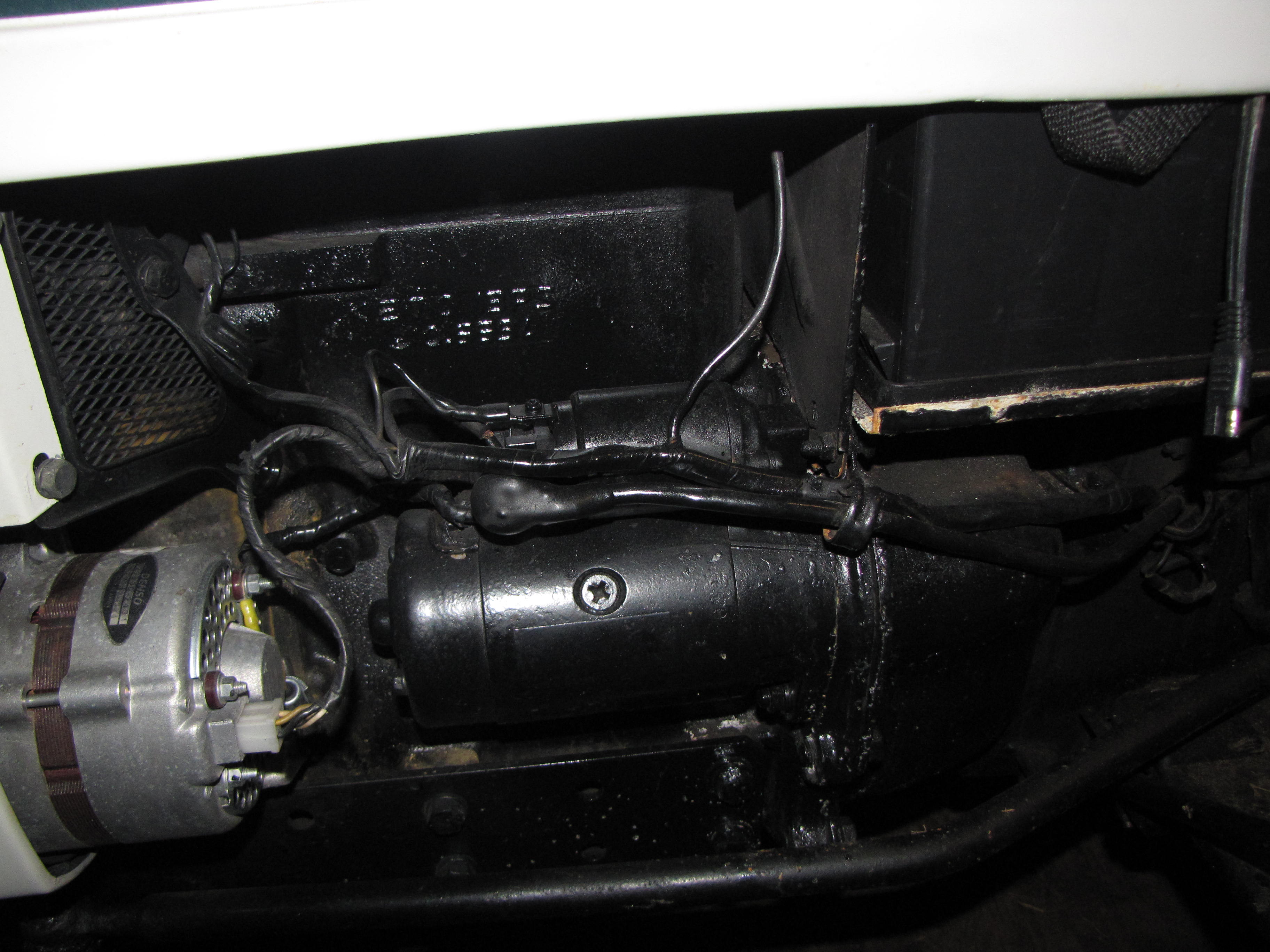

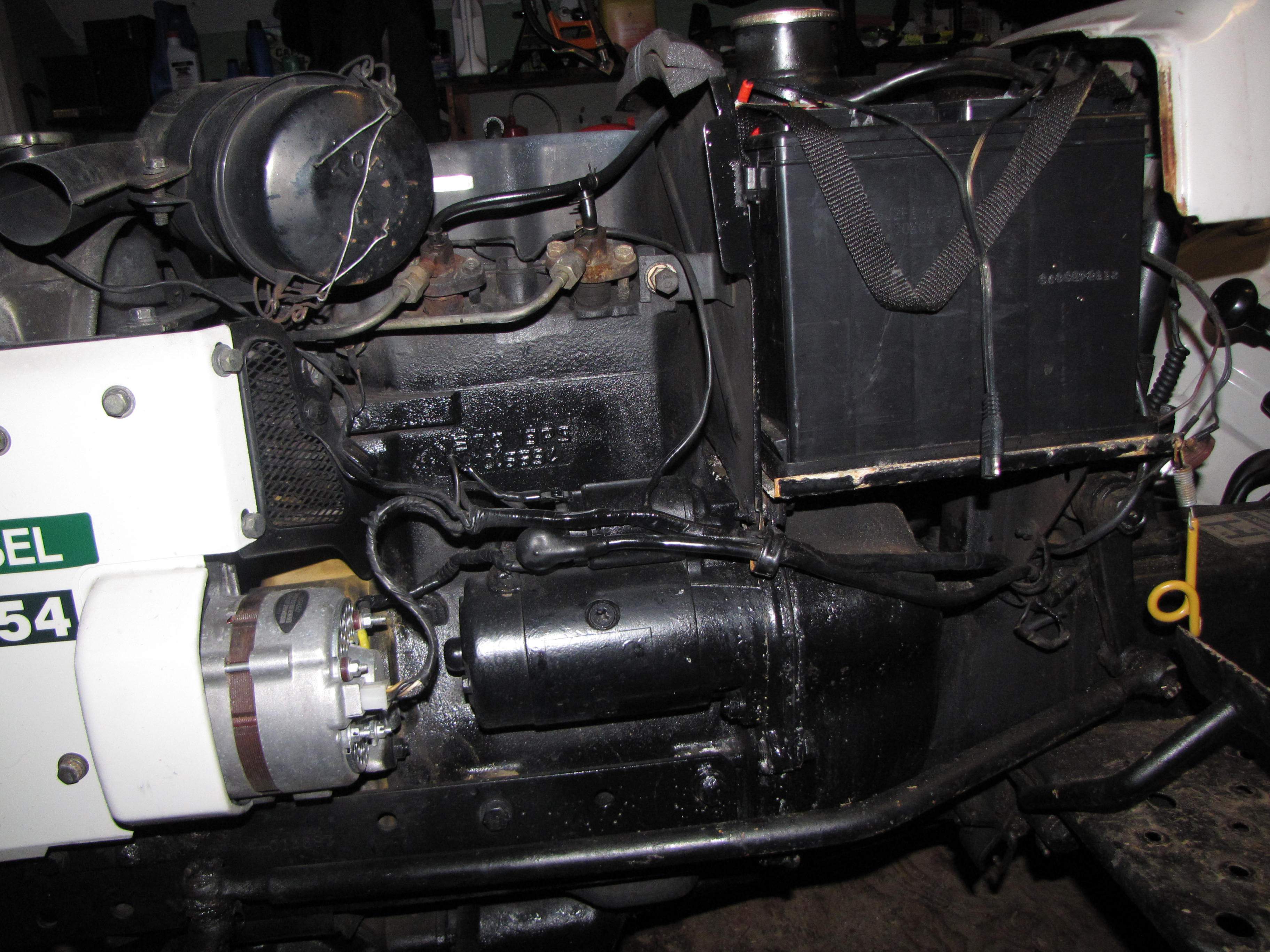

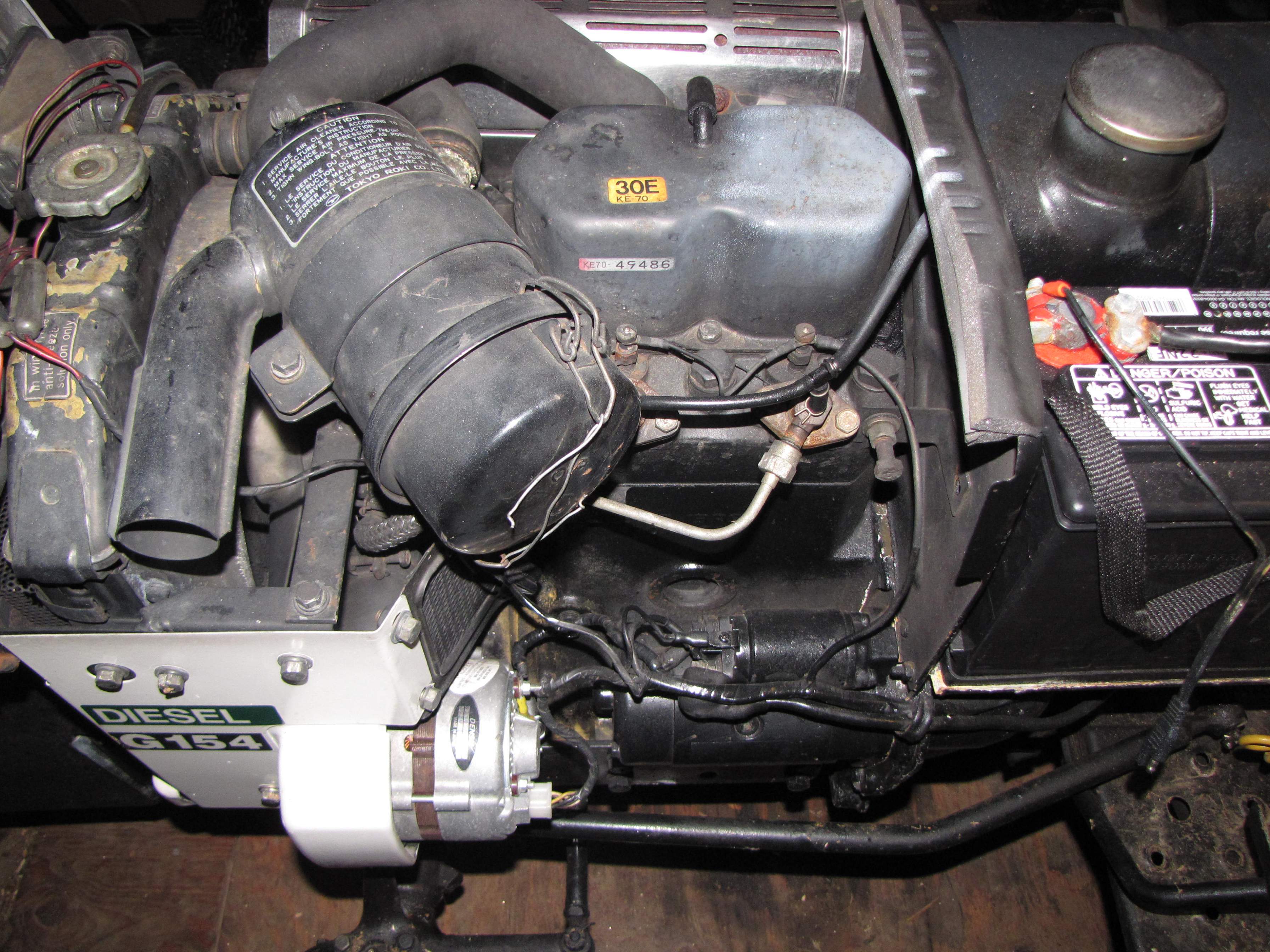

Hi,
Sorry for the delay! I have had about the busiest three weeks in a long time. I saw that you were able to get some photos. I hope that these help a bit. What part of the air filter set up did you need to work on? Hopefully you were able to get the started wired allright. I had to replace my voltage regulator, and my battery, and now I have to deal with the minor damage that the battery acid caused. Anyways, again, sorry that these took so long!

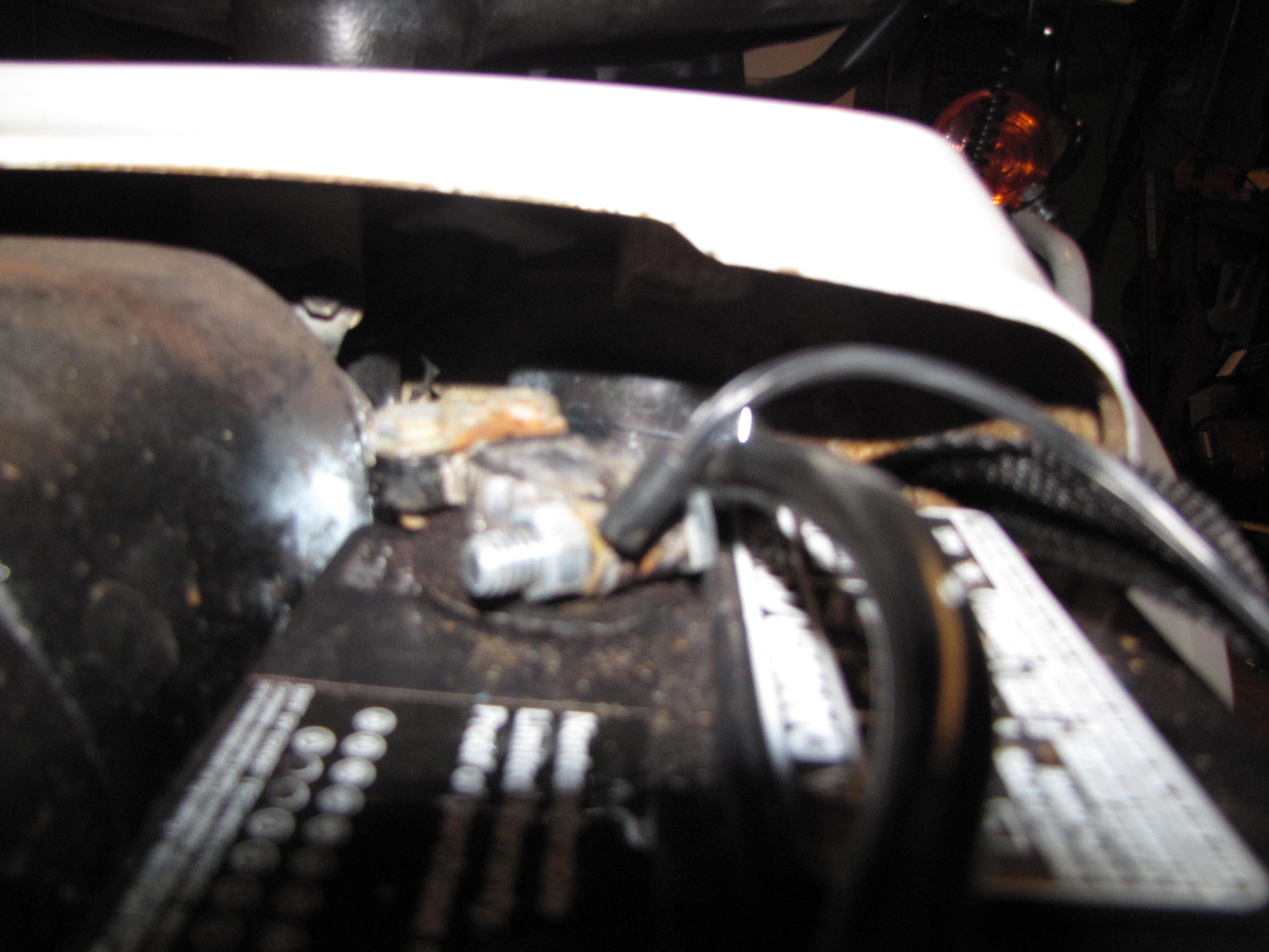

OMG this thing is driving me nuts now...where does the ned batt cable go??? I'm about to just set this thing out with a for sale sign! Its been setting so long it probably wont even start. arghhhh
   / Starter wiring g174 #9
Negative battery is put on one of the steering column base bolts from the factory but can be connected to any frame bolt. It will start. I had tractors sit for over a year and they started like I ran them yesterday. Being diesel they don't have the problems gasoline engines with carburetors can from long periods of sitting.

OK thanks for responding. I think my problem is that I'm too particular. I want to get this back to factory condition. Thats why I'm trying to collect as many pics as possible.
SO let me get this straight. The batt +, the ign wire, and the wire from the alternator all 3 go to the one side of the starter selonoid?
