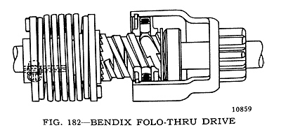

After working the field I shut off, when I jumped back on it wouldn't start, makes a whirring-grinding sound in starter but doesn't start, please help

I'm with BG on this one. If the starter turns slower than required or there is gunk on the shaft, the bendix spring will not throw it out far enough to engage the ring gear. If tapping it works, it is more likely gunk causing it to stick.

If you have this type starter bendix and good power at the starter, you may have to remove the starter to clean it and check for wear.

Starters require 100 to 200 amperes to operate properly. Under this load, the battery supplying the current and the delivery system has to be in good shape, real good shape. My rule of thumb is 10v across the starter (12v stud to case of starter) while cranking as a minimum to spin the starter fast enough to throw the Bendix into the ring gear. If you have that voltage and still whir whir then look at the starter. I don't see the Bendix being your problem with what you said.

alot of you guys are assuming he has a 12v tractro with a true solenoid style engagement gear.. when he in fact could have a 6v gasser 4000 that uses a start relay and it sucks in by spinning up and then is oversped and unlocked and kicked out when engine starts.. those drives have a a couple different styles depending on new or follow hru.. but the old style generally shed the pin and front washer and dump the spring.. and the new followthru ones many times loose the drive gear itself as it splits and comes off the front of the drive.
both those situations make for a spinning whirrrrr sound and no engagement.
we need more info from the OP...
