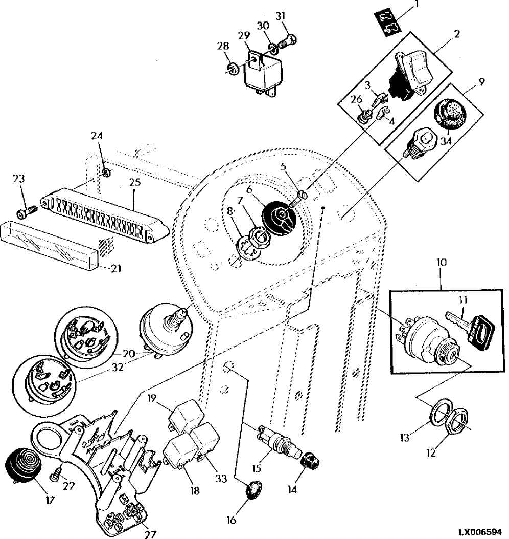

I was wondering if all JD 2155 tractors have a starter relay. I was having problems where I would turn the key and I would just hear a click. The starter solenoid is new(Bosch) , just replaced the battery and alternator does charge. Thinking of replacing starter relay but I can't for the life of me find it on the tractor! The serial number on mine is 688532 and I bought it in 1992 with 640 hours on it. Any help would be appreciated. Oh, by the way, its an industrial grade tractor (caterpillar yellow paint)

Starter relay is parts key 33. Has battery ground cable attachment been relocated from battery box to engine block?

Yep, you flip up the doors between dash and hood and you should be looking at it.
