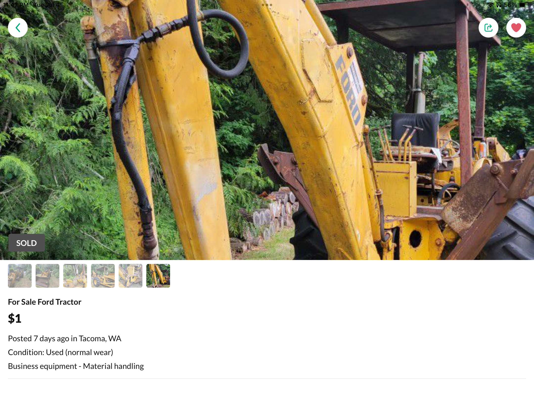

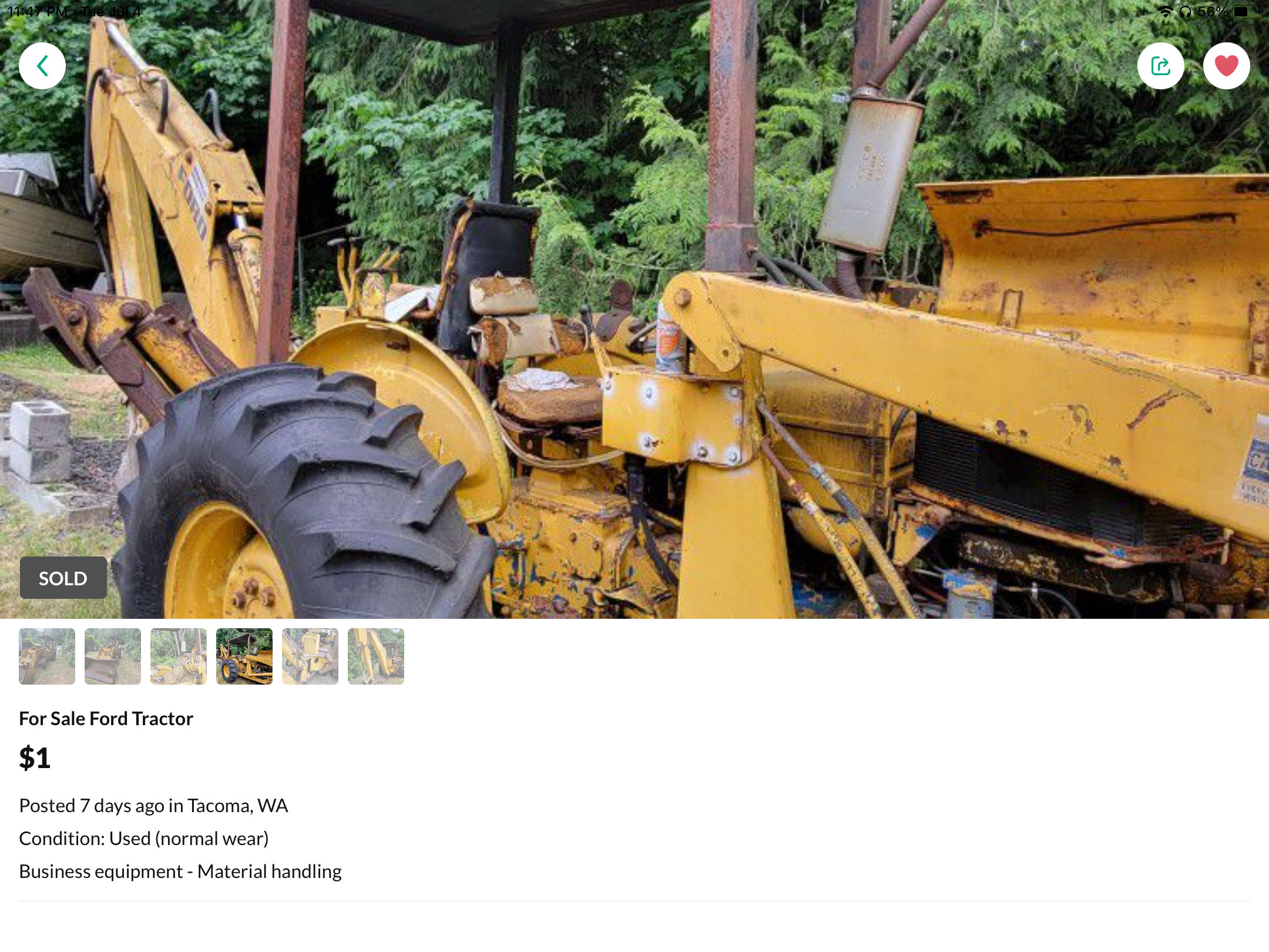

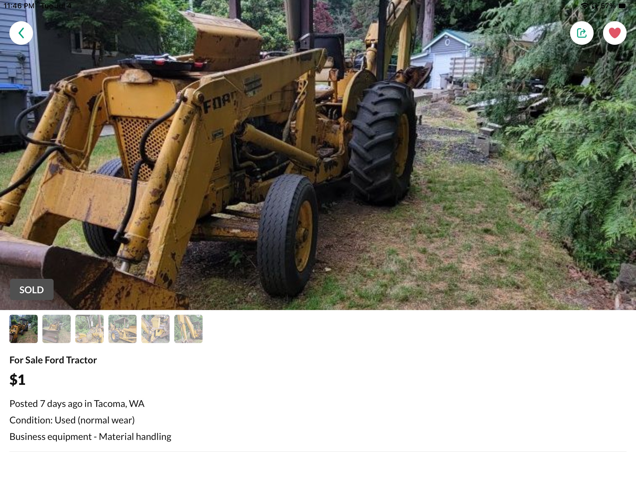

I have a Ford 4500 3 cylinder diesel removed bad starter ordered new one from Napa. Napa started my motor three times and then quit. I saved the core to be rebuild. Does anyone know specifically which rebuild kit I should get thanks in advance.

I found a new starter and solenoid for 155$ and new solenoid and complete brush kit to rebuild old core armature good total 90. Starter is in ,working great.new harness new switch with key had new injector pump. I’m into it about 2500 now very happy
